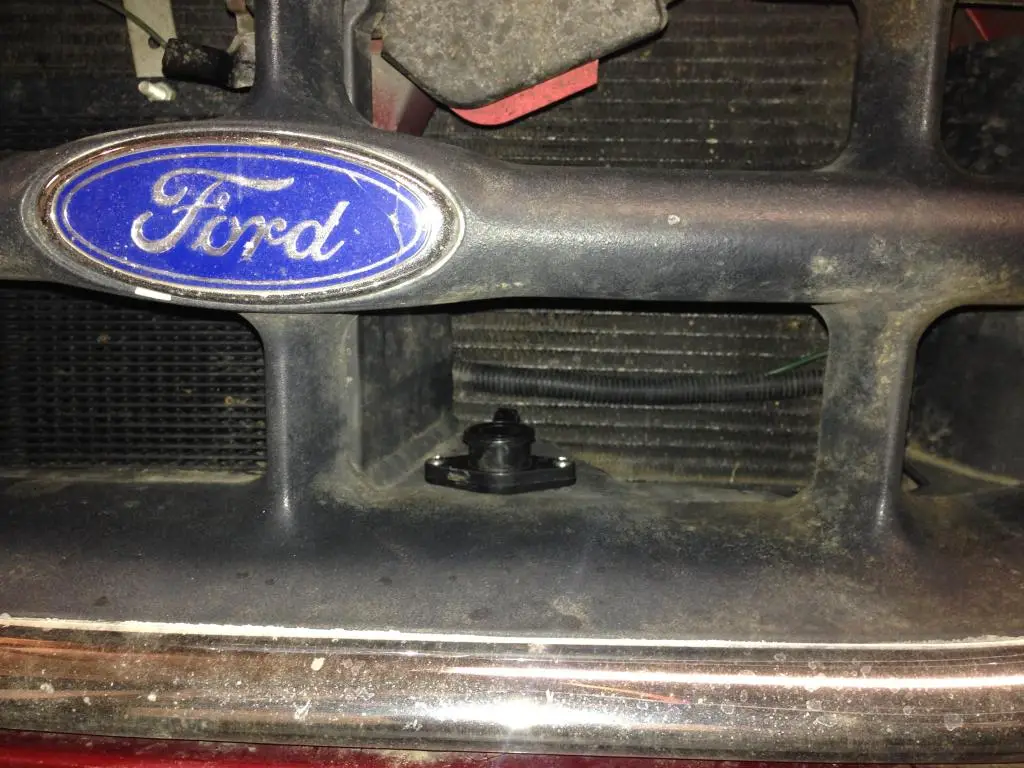

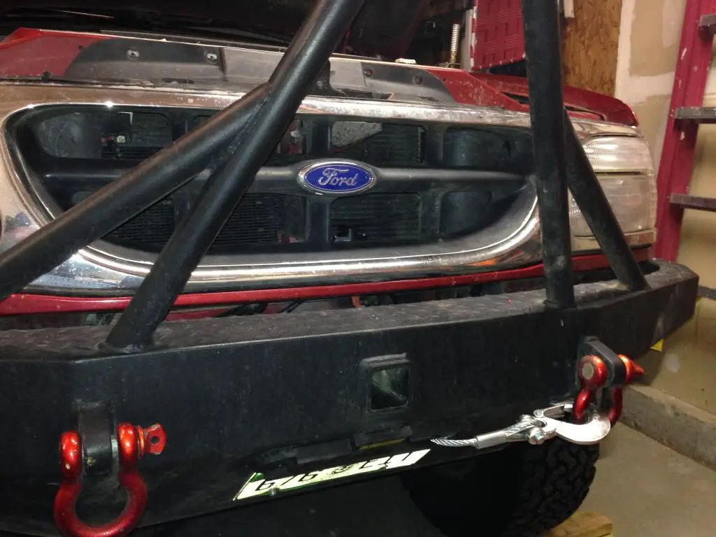

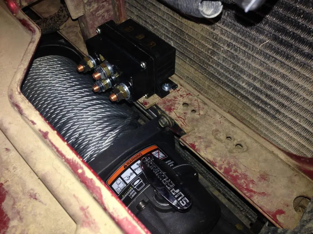

I did a remote location of the solenoid due to clearance of the winch to the radiator support. Even had the winch fit with the solenoid on top, getting to it where it would haven would be horrible.
And then the plug now sits right here:
Hardly know it's there:
Nice and you went with the Hawse instead of roller. Where's the hole for the free spool and engaged lever, just reach inside the grill?
Yep, just to the right of the plug is an access hole for the engagement lever.
And Hawse over roller because if I hit the Hawse on a rock, it won't eff it all up.

We found out that the frame on my '97 is just a little narrower and slightly less deep than Josh's '98 and your ST. That's why I had to remote locate the solenoid.

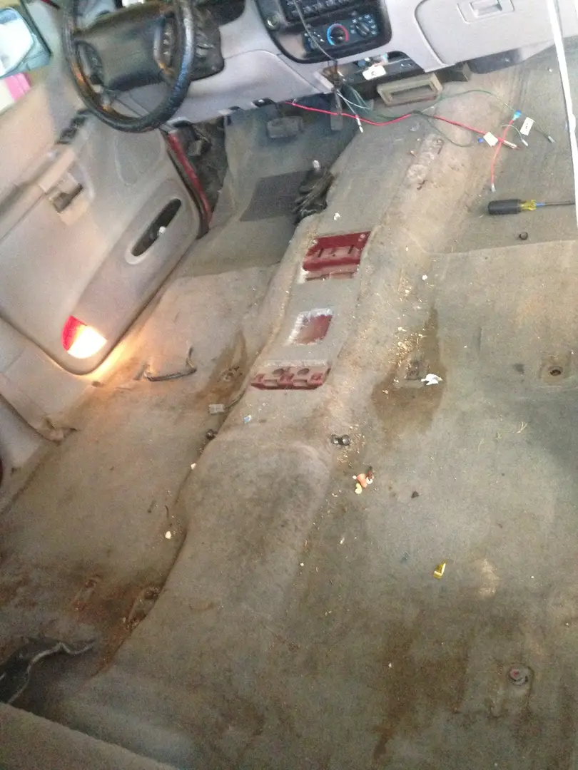

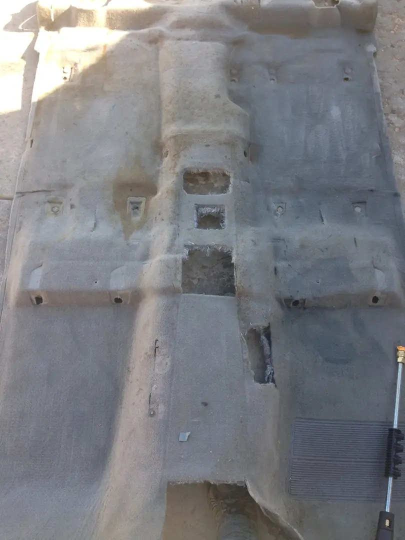

This is a project that I've been meaning to get to for awhile:
Midway though the pressure washing:
If only Joe Dirt could see me now! I think he'd be proud- yet disappointed it took me so long.
Nice but how are you planning on drying that out completely? I'm glad I have the rubber floors in my Sport Trac.

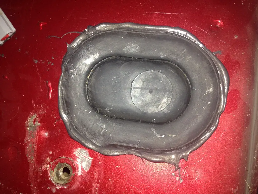

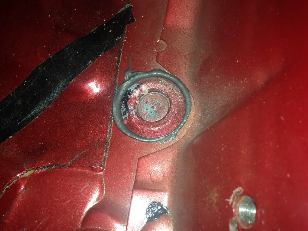

Before putting them carpet back in, I decided to put some black RTV on the different rubber plugs in the floor pan of the body:
I saw some evidence of a couple of them leaking. I have been known to get into some deep water, so might as well since the carpet is out.
The carpet looks a lot better. Still isn't great, but it is 18 years old.
Just dye the carpet dark grey or black and you won't be able to tell. If you're sealing up the floor drain plugs you might want t do that to all the grommet on the lower firewall and around the rest of the cab where the water might make it's way in during a river crossing.

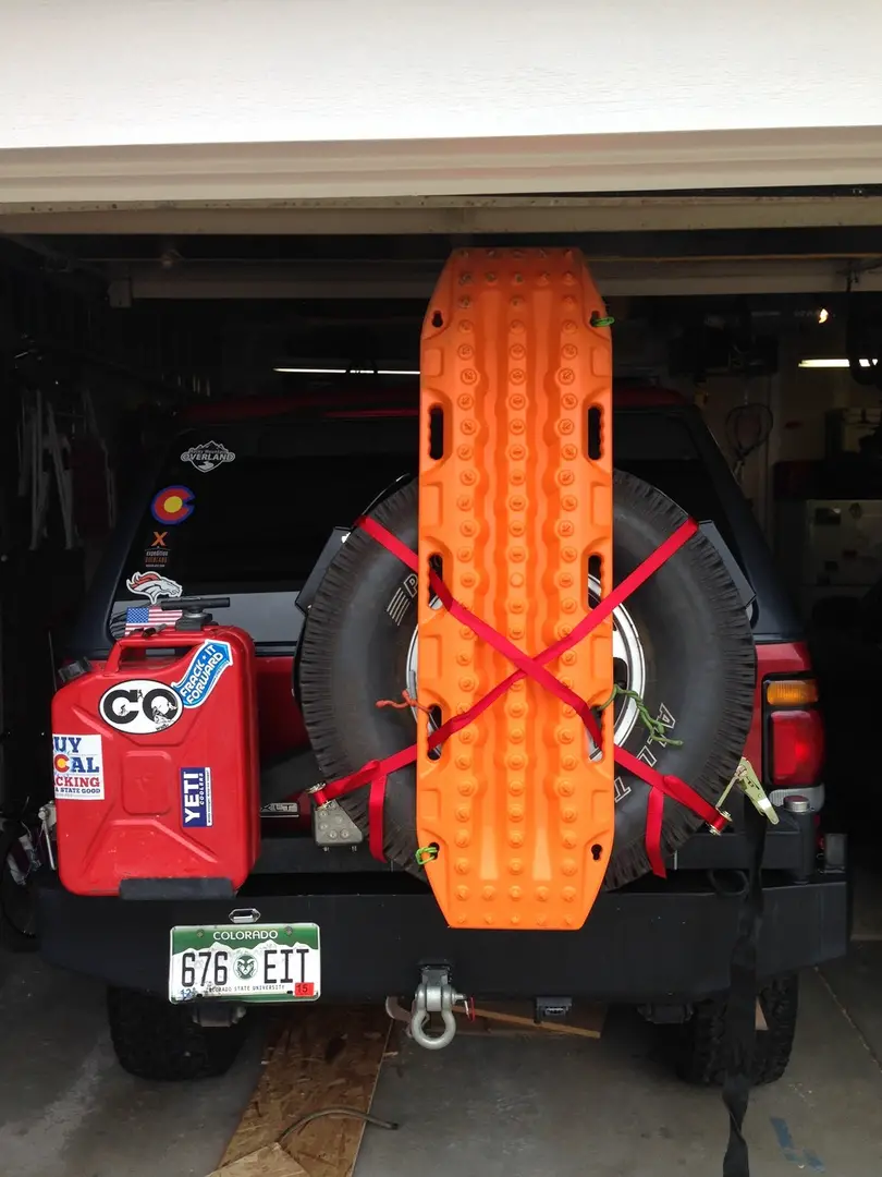

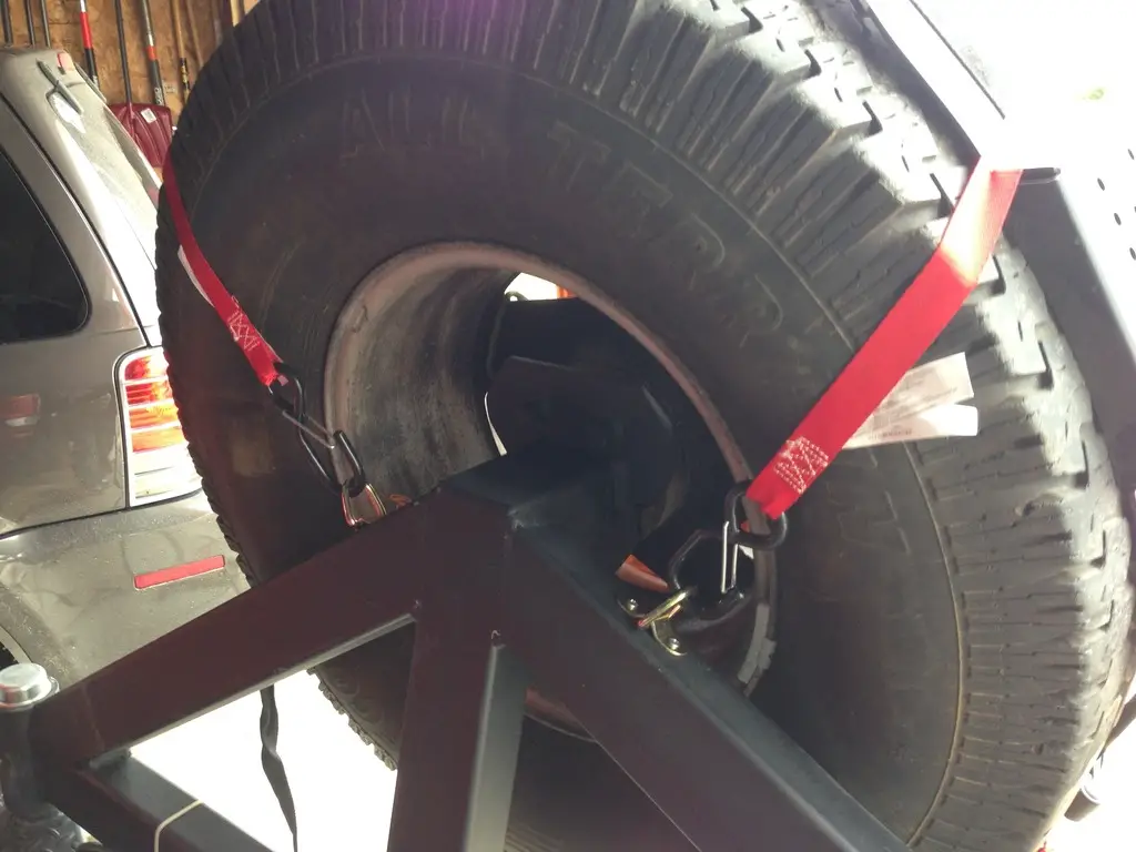

I figured out my mounting for my MaxTrax:
I added some d-rings to the swing out and used ratchet straps to hold it in place. My Trasharoo should then go over the MaxTrax. I will need to remove the Trasharoo to get the MaxTrax and put them back, but everything goes on easily.
Why not mount the max trax to the roof rack either on or make some stronger crossbars and use some wing nut s with j hooks or spring loaded j hooks and hook them through the handle holes. Less likely to get snagged on branches or brush up there and a lot more secure. Less wind drag too when on the road.
Partly because the roof is super tall. And mostly because I haven't figured out my roof rack situation yet. The factory cross rails will not be staying. What is going to go in their place is yet to be determined. Once I get that figured out, the MaxTrax will probably get mounted up there.
I'd also like a roof solution to mount the hi-lift, a shovel (all I have now is a small folding shovel) and possibly an axe. Plus additional storage. And aux lighting to sides and rear.
A roof rack sure does simplify mounting aux lights, that's all mine holds 90% of the time lol.
How do you like the maxtrax? I'm thinking the Smittybilt ones are going to be my next purchase.
could just do what i did, get some carriage bolts run them in the track upside down. then just drilled through the brace on my rack and put on a nut.
