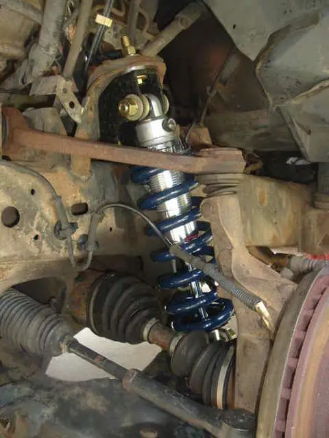

Well I had time to get the coil on, but haven't adjusted it yet for height or welded the shock tower gussets on yet. Here's a couple of photos that show it can be done on a non-lifted Explorer.

I do note that the brake line is dangerously close to the coil and might actually end up residing between a couple of the coil levels.... I will probably need to figure out how to reroute the brakeline. The second photo does a pretty good job of showing the brakeline sitting in harm's way waiting to get pinched. There's so little shock travel (3.5" or so) that even at full compression the coils may not close enough to pinch it, but that is yet to be determined.
Otherwise there were no surprises. As expected, I had to cut off the bumpstop mount to clear the coil, but I did NOT have to grind out the upper control arm (which others have said was required on the lift) so maybe the non-lifted aspect keeps the upper arm further out of harm's way than when lifted.
The coil is REAL close to the axleshaft but it does clear it, so I'll call that as a miss is as good as a mile. As the photo shows, it is angled from vertical pretty good, but that was also expected. I don't know at this point if that will have any noticeable effect.
