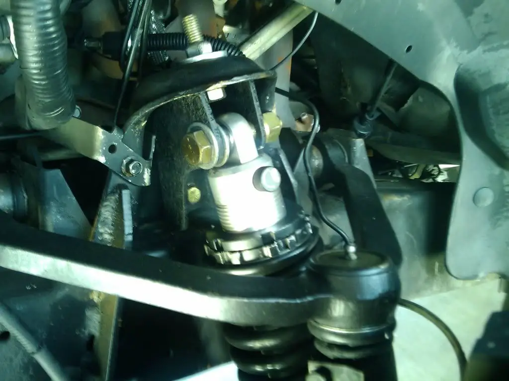

Yeah Danny that photo is before I installed the aluminum extension. I'm not sure you'd be able to see it anyway. It's not a spacer up top; it's an extension of the rod on the bottom.
Jamie; yeah, if you're thinking of this mod, go with the part number I just referenced in my last post. Both its compressed and extended lengths should work out perfectly. There's no way an aluminum extension can hold out on the trail, but since I was already into the price of a shock I had to try out the option. Now it's been confirmed; I wasted the money I spent on two coilover shocks and both of them do indeed need to be replaced with ones that are an inch longer. I don't have the money for both right now so I'm replacing the passenger side one I just broke.... before I hit the trail again, I'll have to replace the other one.

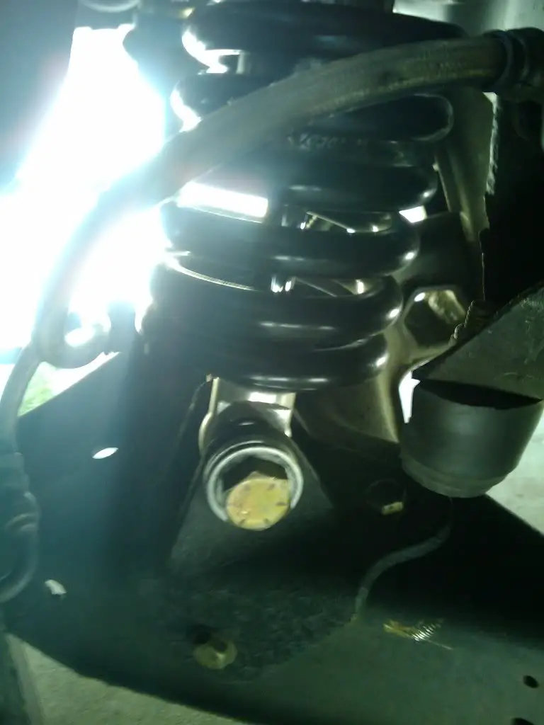

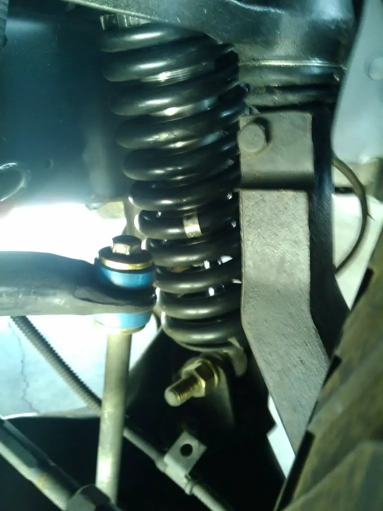

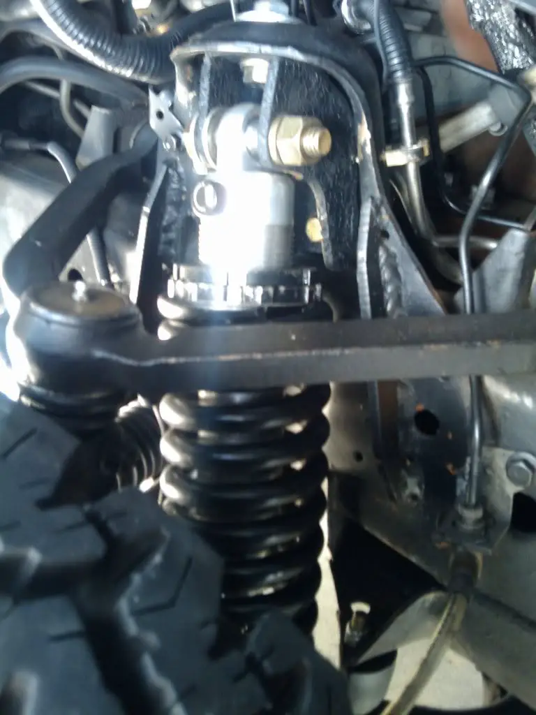

I did this conversion on my truck a while back. I used QA1 HAL-UR5855 Shocks. DO NOT get the shocks with bushings, they will split and the mounting bolt will rattle around in the eyelet damaging the shock and giving a harsher ride.. Fortunately I caught it in time and replaced the bushings with bearings and all is good. You will also have to cut a piece of the bump stop off to clear the coil but you can re-drill the hole a little further back and use a universal bumpstop from auto zone.
My spring rate is only 600# and it is just fine. No sagging so far and its been a couple thousand miles already. But I do have a sport exp so you may need stiffer springs for the 4 doors. If anybody wants to see I can post a pic tommorrow.
can you post a pic of yours? i'm looking to convert mine since i cant find any parts to do a 4406 swap.. how long ago did you convert yours and whats the average cost? bellflower isnt far at all where i am.. maybe i can take a look at it when time permits..
Sure I'll post pics tommorow as soon as I get home from school.
Here we go.
No problem, lemme know if you need pics of anything in particular.
Coil over conversion
