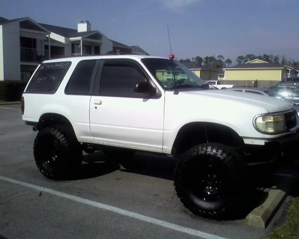

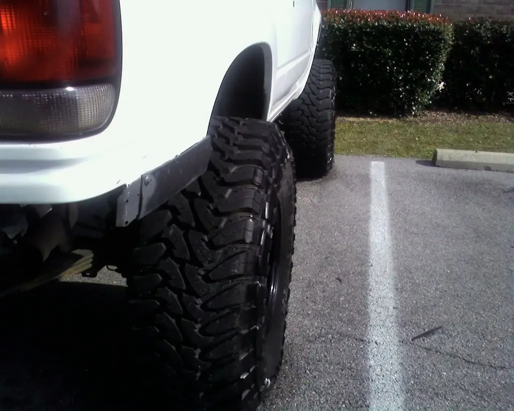

Got some new wheels with a little more backspacing and got them mounted up today
Them things are a little on the wide side - but not too shabby.
I know this post is a little old, but I just picked up some barely used Toyos today and haven't had a chance to mount them up, explorer is in the shop getting gears. Do they rub on your springs at all will turning? What backspacing are your wheels?
10" wheels 3.75" BS and no rubbing whasoever, very good tire on the street but they follow the crowns and ruts pretty bad on braking
