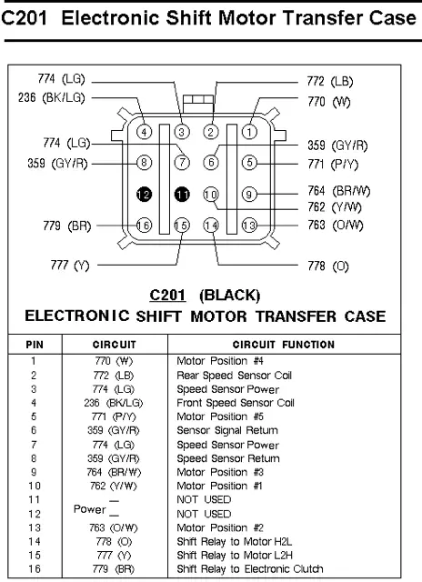

I cut one off a 96 that had all the same wires and spliced then together, the harness itself was irreparable.
Did you check the pin location vs the color on both harnesses? I think you just need to compare pin outs and verify nothing is different between the two.
Yeah I followed the Ford diagram, apparently they used to have to replace these things a lot under warranty so the guide was pretty readily available.

The wires were stripped out where it fed into the harness, looked like they had been kinked or something for so long they just ripped open, so it was either rejacket them or cut shorter and find a new harness with a few inches of wire for us to play with.
96 and 99 hmmmmm something tells me those two harness are different slightly I’ll map them out
Lots of wiring changes between 96 and 99 maybe some in the t case harness too
I was going off this, both sides of the harness had the same connections

They probably have the same connectors. There’s no reason to ever change a connector, unless you run out of pins.
99% chance you have something mis-mapped.

Got the explorer back from the shop, apparently some of the wires were messed up at the crimps, shop redid the pins and now it works great, ABS issue seems like it's gone too

Yeah! We did enough here to determine it must be in the wiring. The shop did the rest! Hopefully it wasn’t $3000000 like most shops get these days
Wasn't horrible honestly, I was expecting 300-400 but it only cost about 130ish
