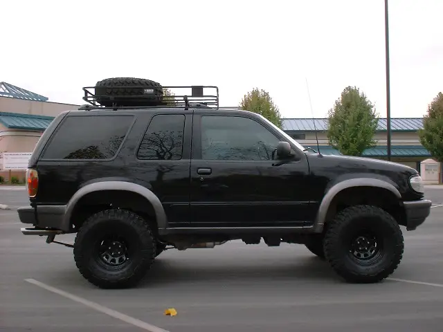

- Lift: Torsion twist, Warrior shackles, Add-A-Leaf, 4-door leaf springs, 3" Performance Accessories (883) body lift, Rancho RS9000Xs
- Tires and Rims: 33x1250x15 GoodYear MTRs, Black RockCrawlers

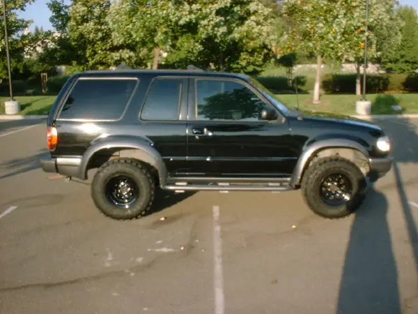

Here are the earliest before pics I have. It already has the TT/Shackles/AAL. I have a set of 31x1050x15 Super Swamper SSRs in this pic. I liked the look and performance of the SSR, but I didn't keep them properly inflated and balanced, so they started to cup. The road noise was more annoying than a crying baby.

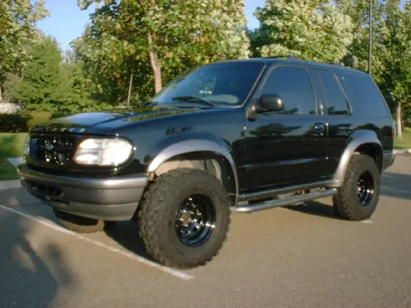

Here are the current pics. I was debating between doing the suspension lift or the body lift or both.

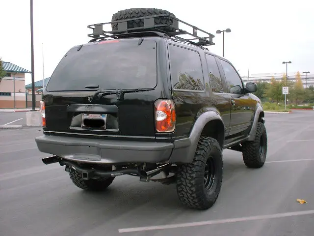

Here is a pic of the rear bumper bracket I had made. I got a schematic that is posted on several of the threads on this forum, took it to a metal shop, had them cut it, drill pressed holes (note: the holes need to be larger than 1/2" if you're using the stock bumper bolts)

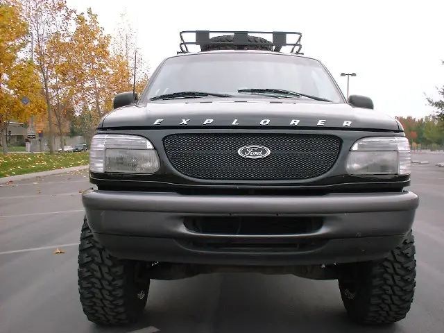

Here is a pic of the Grillcraft grill, black Ford Explorer emblem, and Range Rover Style Explorer badging. The grill was easy to install, I just removed the black surrounding grill, drilled three holes, attached the grill, and that was it. The Explorer lettering was removed from the rear and attached with extra strength double sided tape.

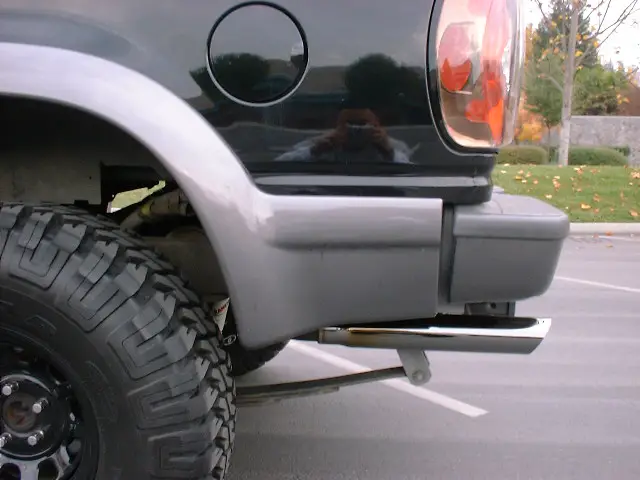

Here are pics of the exhaust. The tips are black chrome from Toucan Industries. The tips hang slightly low under the bumper, but it's fine because if I ever need to mess with the body lifted bumper I have some room to work.

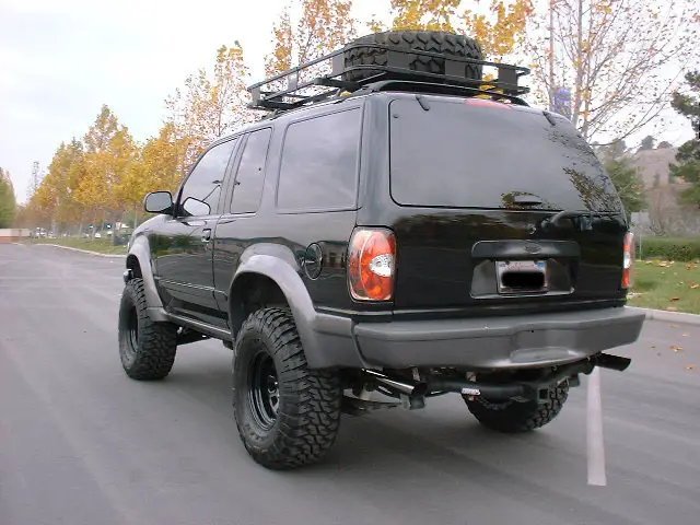

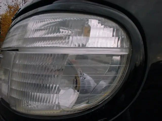

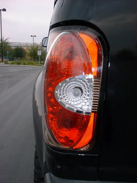

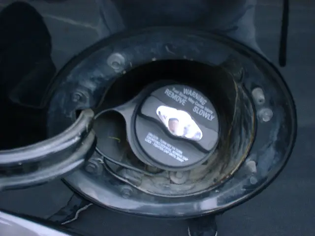

Here are pics of the safari rack, hitch tow hook, de-ambered clear corner (notice the cut where I dremeled, not noticable from a distance), altezza style tails, and locking gas cap. I don't know why Ford did not not have a cab operated gas lid opener like in most cars. They have an unlocking system where anyone can siphon your gas, pour sugar in the tank, etc. I think this is one of the best investments I made.

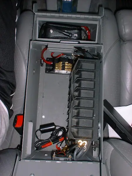

I wanted to provide more cooling for the amp in the Tuffy box, so I installed a computer fan and drilled 1" holes in the sides.
The New Jukebox is a little glitchy, but 20gigs of music is sweet on long drives.

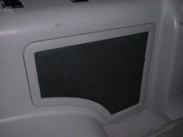

The JL Audio Stealthbox "is so necessary". It hits pretty hard, but stashes away for maximum storage capacity. I highly recommend it.
- Misc: Tuffy Stereo Security Box, Explorer Express Storage Console, APC Pedals, rear mounted fire extinguisher and Maglite
