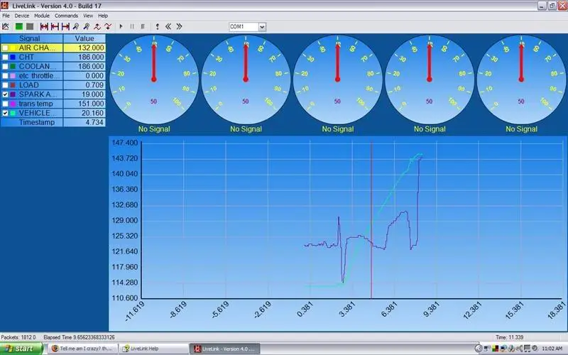

No, I think your "issue" is from something else--
it feels like a switch is turned on at 20mph--then the truck starts pulling.
it has to be something in the software-I'm curious when the timing advance kicks in--this is what it actually feels like is happenening---
Can you watch the timing curve with the xcal?

would that be the same as spark advance?
Yeah-
how many can be logged?
compare speed-calculated load-and spark advance--let's see if something changes dramatically at 20 mph (something is-I have felt it when I rode in your truck)
ohhhh--check the throttle pull--
key on engine off--floor it and read TPS ----
then-go pull the throttle to max by hand--
compare the two readings--
You can log a lot of things at once, I've logged over 15 at once. The battery on the laptop is almost dead, I have to go inside for a bit and let it charge. the red line is 20mph
