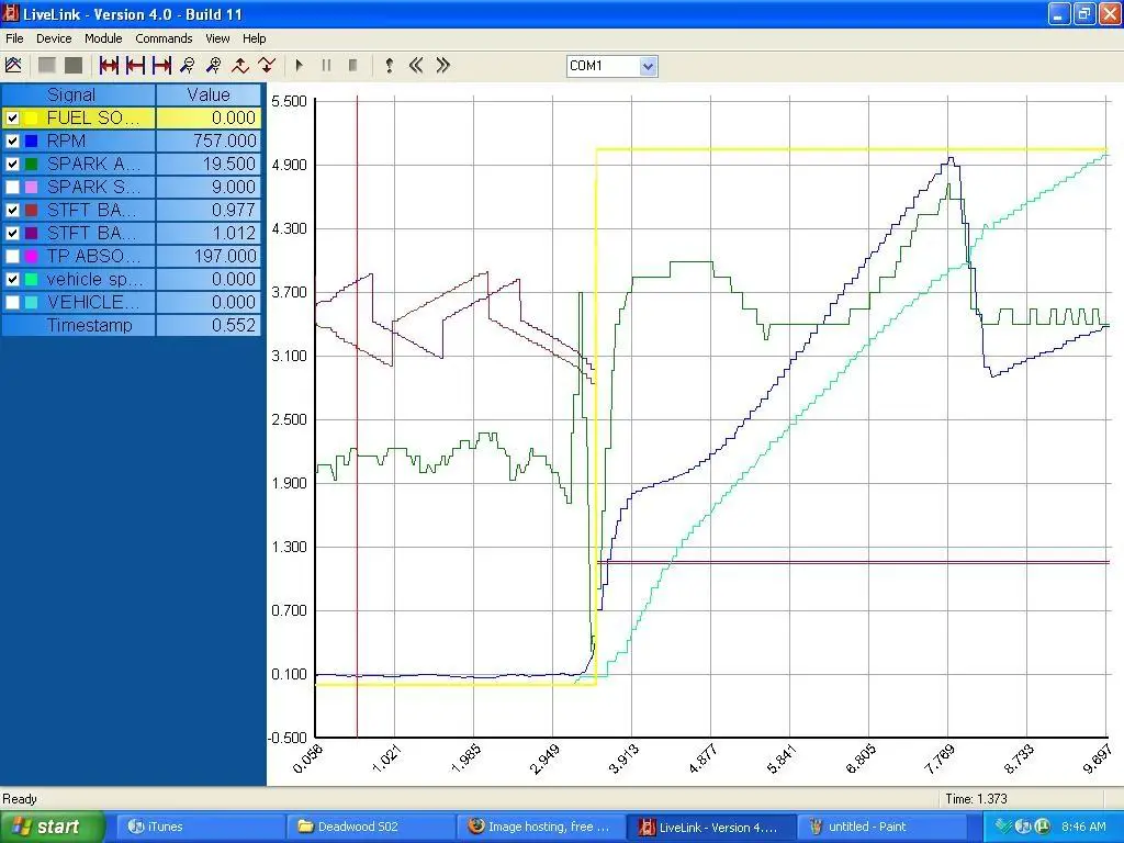

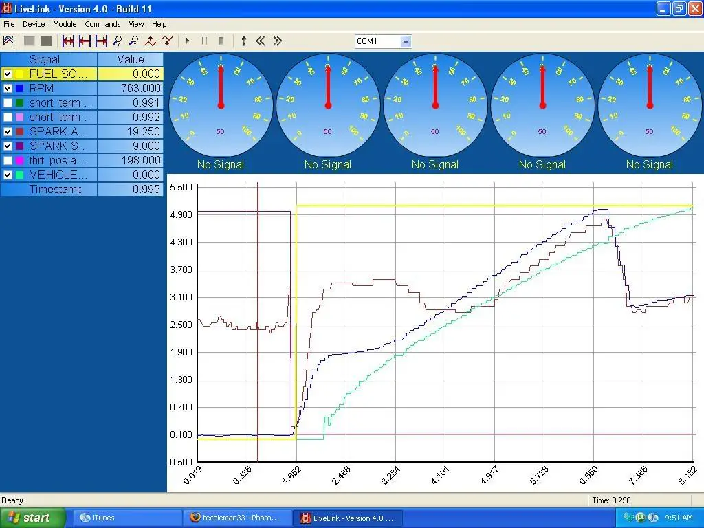

I'll be surprised if this turns out to be the Intake. You know, I've heard that if you block off the intake PVC line and use a filter, you need to do the same on the regular PVC valve because the air is metered air. In other words, if you filter one, you need to filter both. It makes sense but I believe this is so small, but I guess it could skew the air to fuel and maybe run leaner.
I wonder if your H-pipe is in the optimal location.
I don't really think nitrous would help much, it would be just like every other mod, give me more power, and make the power difference even more noticeable. I don't have an H-pipe, they just run straight into the muffler.
With the stock intake
with the mac intake
So the problem is still there?
Did the truck feel this way before you started modding, just getting worse, OR you can feel it more, when awakening the engine with mods?
