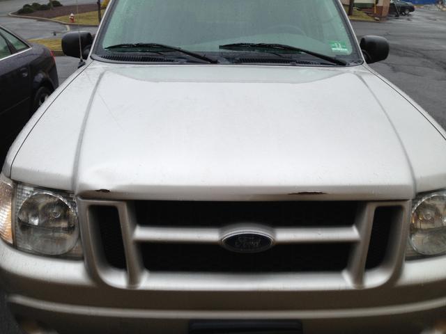

First up was repairing the rust and the worst of the dings and scrapes on the body.
I had a guy I know knock out the dents in the hood and grind down the rust, a minimum of filler was used but to be perfect the hood will eventually need a full respray.
Before:
After:
Before:
After:
