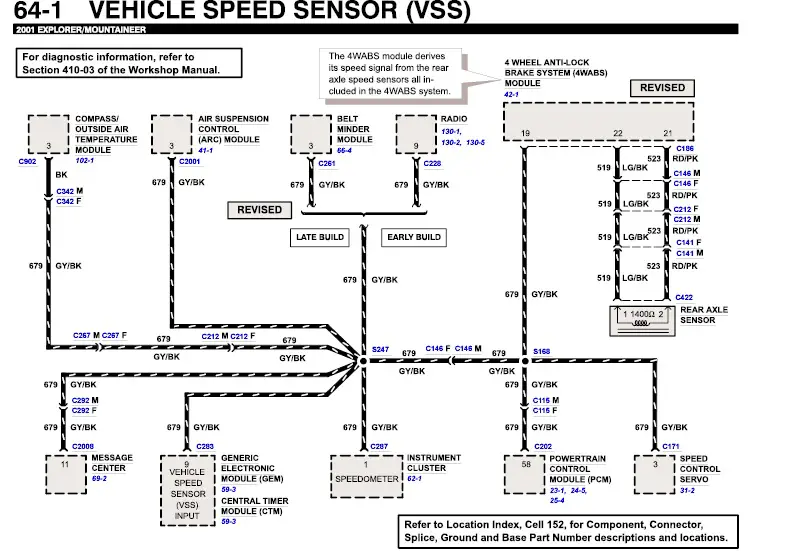

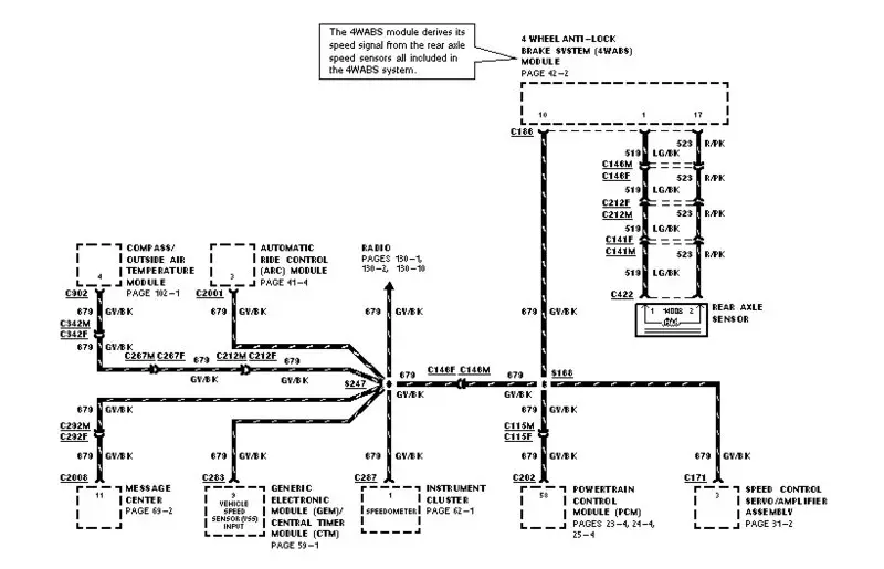

Here are both the 1998 and 2001 VSS diagrams.
1998 first, 2001 second.

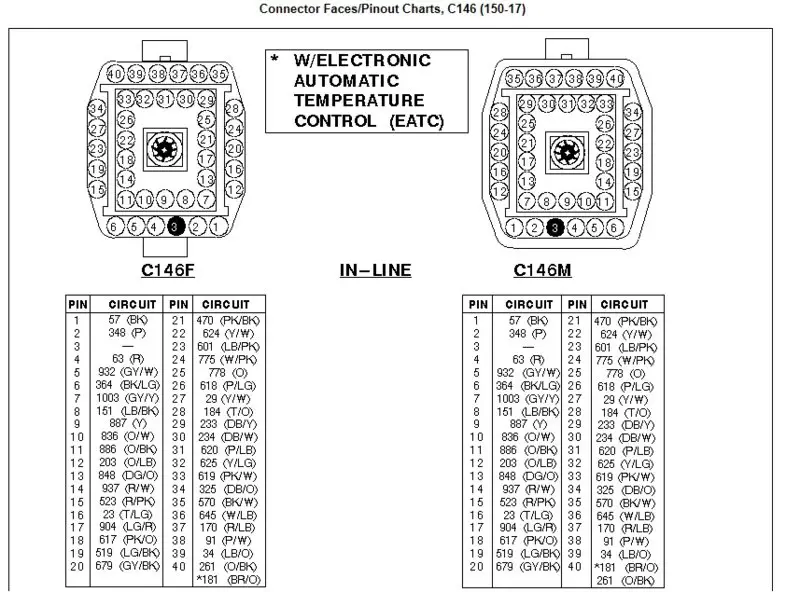

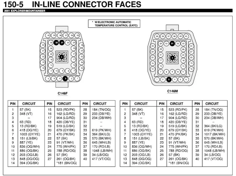

Here are the connector pictures for C146.
Looks like circuit 679 is in the same place for both 1998 and 2001.
Make sure the connector 146 is fully seated.
If that is good, it might just be a coincidence and maybe the speed sensor in the diff failed? (they do crap out)
Again 1998 is top picture, bottom is 2001
I hope those diagrams help, thanks John. I was thinking of the PATS changes in 01 Sports and Sport Tracs, something might have altered the VSS circuit path after those mid year changes.

If both the ford wiring diagrams are correct, and you have no ABS light on....
And if the transmission shifts fine, and the speed control works, but the speedometer doesn't then that would be a problem with circuit 679 and probably to the left of connector 146 in the top diagram I posted.
Also with out a speed input to the Gem module, after one launch the 4wd may become non working.
In 1998 under explorer, there is only one page in the diagrams too.
It is possible that 1997 used a transmission tail shaft sensor, but my 1998 doesn't have one.
Let me know if there is anything I could look up to help?

I datalogged the vehicle last night. Unit shifts fine, I am actually getting the commanded and desired shifts 1-4 and lock up. The vehicle speed shows 0 all the time. As far as this diagram- I believe everything I have to the #1 connector is fine. I agree that circuit 679 is the culprit an it appears that the AC signal supplying that connector is in question. So it appears we need engine controls diagram to nail this down. I have a little time tonight and am going to dig into this. Also being that at this moment I don't have a connector location where/what is connector 146? I suspect that is the one the v8 harness will connect to the chassis harness. Square looking with big wires at each corner. I need to find a gravel road to test my abs, I really don't want to flat spot my new tires to find out that my abs doesn't work. Now from what I understand NONE of the V8 transmissions used a tail shaft sensor. I looked at around 10 of these babies in the junk yard and they all were the same no OSS. There is an intermediate/turbine shaft sensor but no OSS (output shaft sensor).I will figure this out. I am purchasing the documentation today.
I believe I just found it. I purchased a manual from Mitchell 1 diy and it appears the rear axle speed sensor supplies a signal (as we all knew) to the 4WABs module on pins 21 & 22. Then pin 19 (gry/blk) supplies a signal to connector 679 (pcm connector) pin 58 which is VSS. From there it splits off and goes into the dash. I have checked the wiring multiple times and still a no go. Everything wiring checks out properly now. Interestingly enough pin 19 was supposed to be a gry/blk and mine is black. I cut the wire (not knowing where the other end went-didn't go to the dash) and jumped it to the gry/black. Now I have everything checking properly-to the pcm and to the bulkhead connector on the firewall. I guess I will pull the cluster out and verify it is all well there too. So my question is I wander if my ABS module is different and isn't speaking to the other system properly (maybe v6 and v8 are different). I found a dirt road and the ABS is working properly. I see no speedo on the dash or in the datalogger. So that tells me I am not receiving a signal from the ABS module pin 19. Wander if that part of the circuit is bad?

I thought C146 was going to be that engine harness connector that is square and on top of the engine (circled in blue).
Turns out that C146 is actually on the firewall (bulkhead) (red arrow).
