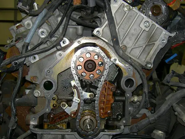

The SOHC has OHC chains which ride on a plastic guide, that parts assembly is called the timing cassette. There is one in the front as well as the back. There is a traditional appearing timing chain, but it has a chain guide made of a plastic, plus a tensioner with very thin steel pieces to apply pressure to the main chain.

These engines have 5 timing chains.........nylon guides and hydraulic tensioners. In these engines oil changes on time and using full synthetic is a MUST
To repair the passenger side "cassette" the chain is at the rear of the passenger head and the engine must come out
Other repairs to the main chain, tensioner or drivers cassette can be done in the vehicle
they are also interference engines so if the timing chain lets go the piston will slam into the valves

BIG difference between a pushrod engine (camshaft under the heads) using lifters and pushrods to move the rocker arms, a single beefy timing chain to turn the cam off of the crank
SOHC = overhead cam, the cam is over the valves, no more pushrods. This results in less rotating mass which is more efficient and makes more power. However you now have guides and chains to turn each cam........

I've had this happen on my '99 4.0 SOHC. I changed out my driver's side timing chain tensioner with a Cloyes tensioner and as soon as I started the engine, the tensioner exploded causing the timing cassettes to explode. Unfortunately, I bent 3 valves, so the engine was scrapped. Your engine sounds exactly like mine did. It'll start up, but won't idle. Pull your valve cover on the driver's side and check out the cassette and tensioner. This is 100% your issue.
you can also look through the oil fill cap and get a good eye on the drivers upper tensioner and guide
