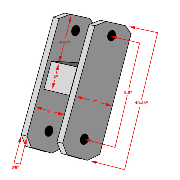

What are the demensions of the warrior shackles? And how thick of steel is it...I might try and make my own

I realize this is probably a dumb question, but my warrior shackles arrived today and the middle brace between the arms isn't center, it's offset, and I assume for a reason. So question is do you install the longer arms up or down?

Long Arms up.... It keeps the cross brace from hitting the frame when the suspension compresses and the spring goes flattish (e.g. longer).
