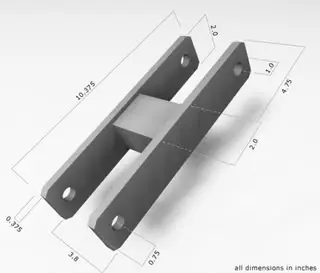

I went down to the local engineering/metal work shop & got mine made from specs off here for less than half the price of warriors & just as solid. :D
autozone shackles are almost the same for 20$
theres no way they are almost the same.. the autozone and other parts store shackles are just 2 slabs of cheap metal, the warriors are high grade steel with a support welded in themiddle to reduce binding and increase strength. parts store shackles scare me, I wont even sell them.
well ya, sorry I was tired when I wrote that, the auto zones are flimsy, but they give about the same lift is what i meant...
