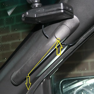

2015 Explorer Sport leaking at the grab handle.
Hello EF,
My 2015 Sport has developed a leak coming out of the passenger grab handle. After a big and lasting rain or snowmelt, a drip will develop coming out of the plug and running down the handle, dripping onto the glovebox door, then down to the floor mat.
My wife has been asking what's with the water always in the mat, my standard answer has been "boot ice". Just yesterday I caught the drip out of the corner of my eye and was surprised by it. So obviously it's been leaking for some time. I also might add that once when about two moths old, it did drip water from the dome light. but I've never seen evidence of that again.
As some background, my sport was vandalized when 4 months old, and the repair necessitated the repainting of the roof, and a replacement of the passenger side roof rail, amongst a pile of bodywork and glass along the drivers side to the tune of $10K. But no windshield. I went back to the shop that did the work and they say the roof rail mounts were not touched. They were very helpful and ran some water, but could find no pattern. When they opened the handle plug, there was some residual water, but that was it.
The car is booked in to Ford next week for a popped out bumper cover, suspected front wheel bearing failing, a second row seat that won't flip up, a squealing idler pulley and this leak. I do like the car, but have become kind of disheartened with it. I'm still moderately hopeful all will be taken care of in the next coming weeks.
Any ideas on the leak? Sunroof related owing to the past water in the dome lamps?
