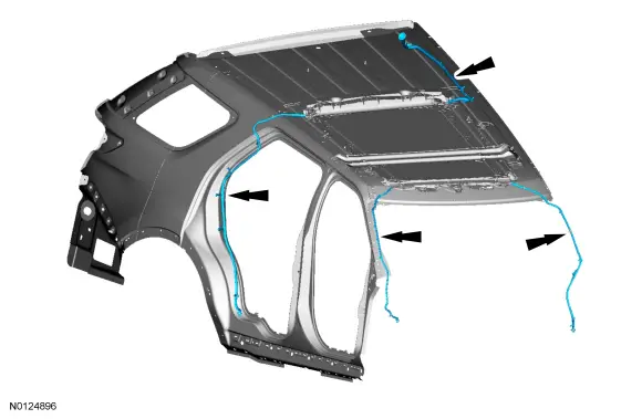

Usually, according to previous posts, if the drain tubes are blocked the water puddles in either the front or second row foot wells. The diagram is courtesy of Jason, jmr061.
Good luck.
Peter
Really appreciate the diagram. Any homespun, effective ways to clear the drain tubes? 6' pipe cleaners? Bought used 2011 Limited last week. After wife complained it smelled "musty" found about an inch of water in the spare compartment with soaked, moldy cover, etc. This vehicle's service history shows most maintanence performed by selling dealership and sold to me through their used vehicle outlet. Seems like it might be a good idea to exercise their 7 day return policy. How effective have fixes been over time to prevent the leaks from recurring?

Water from plugged drain tubes usually puddles in the front or 2nd row foot wells. I think the water in the wheel well is from another source. Many early leaks came from the area where the roof rail was fastened to the roof. Water would fing its way in and run down the 3rd row seat belts. There have also been cracks found along the top of the liftgate, I believe. Fixes were not always successful on the first try. Several members had to go back a few times. This type of work is usually 'farmed' out to a 3rd party the deals with leaks.
