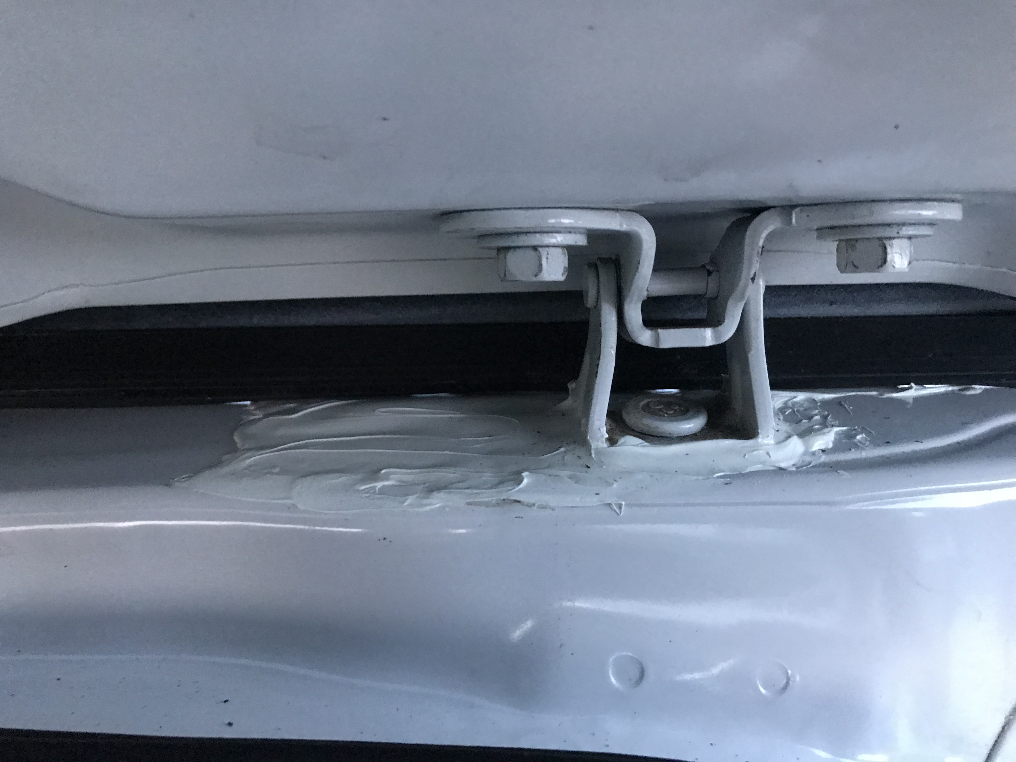

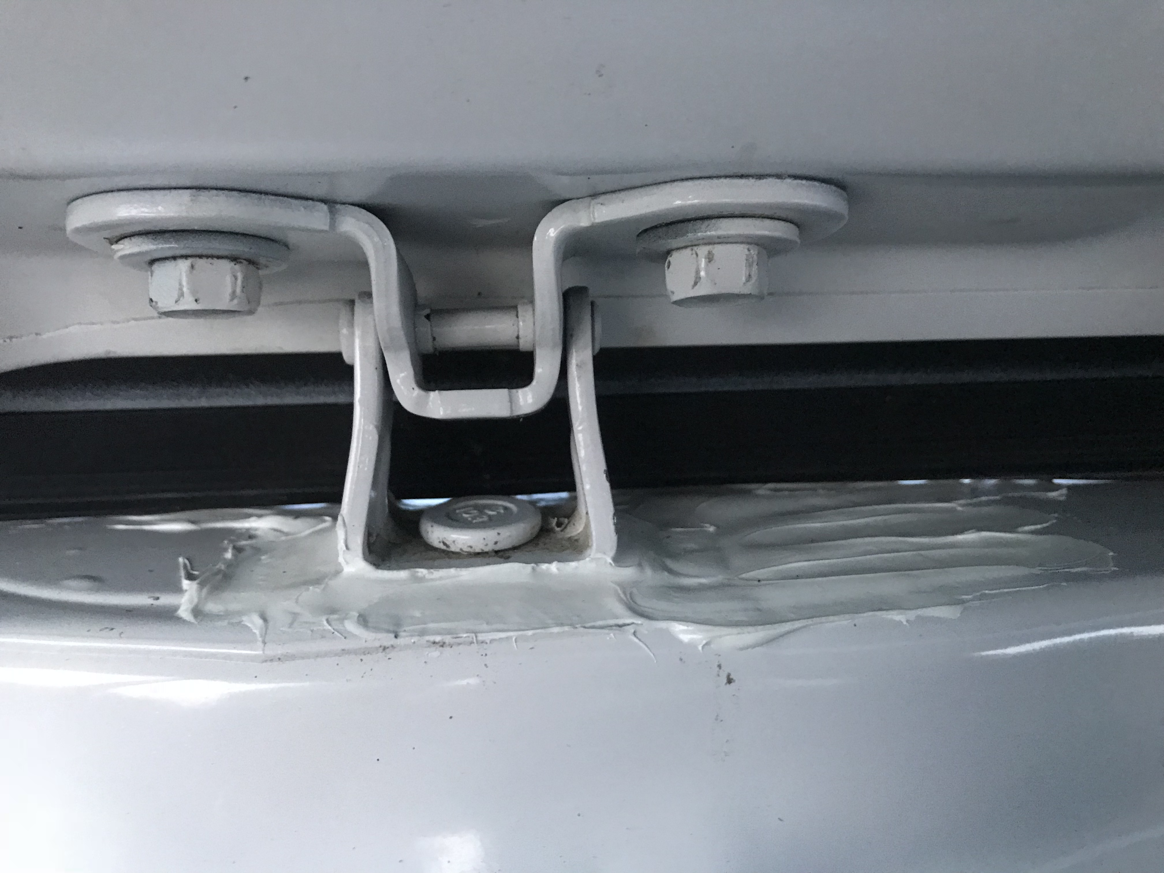

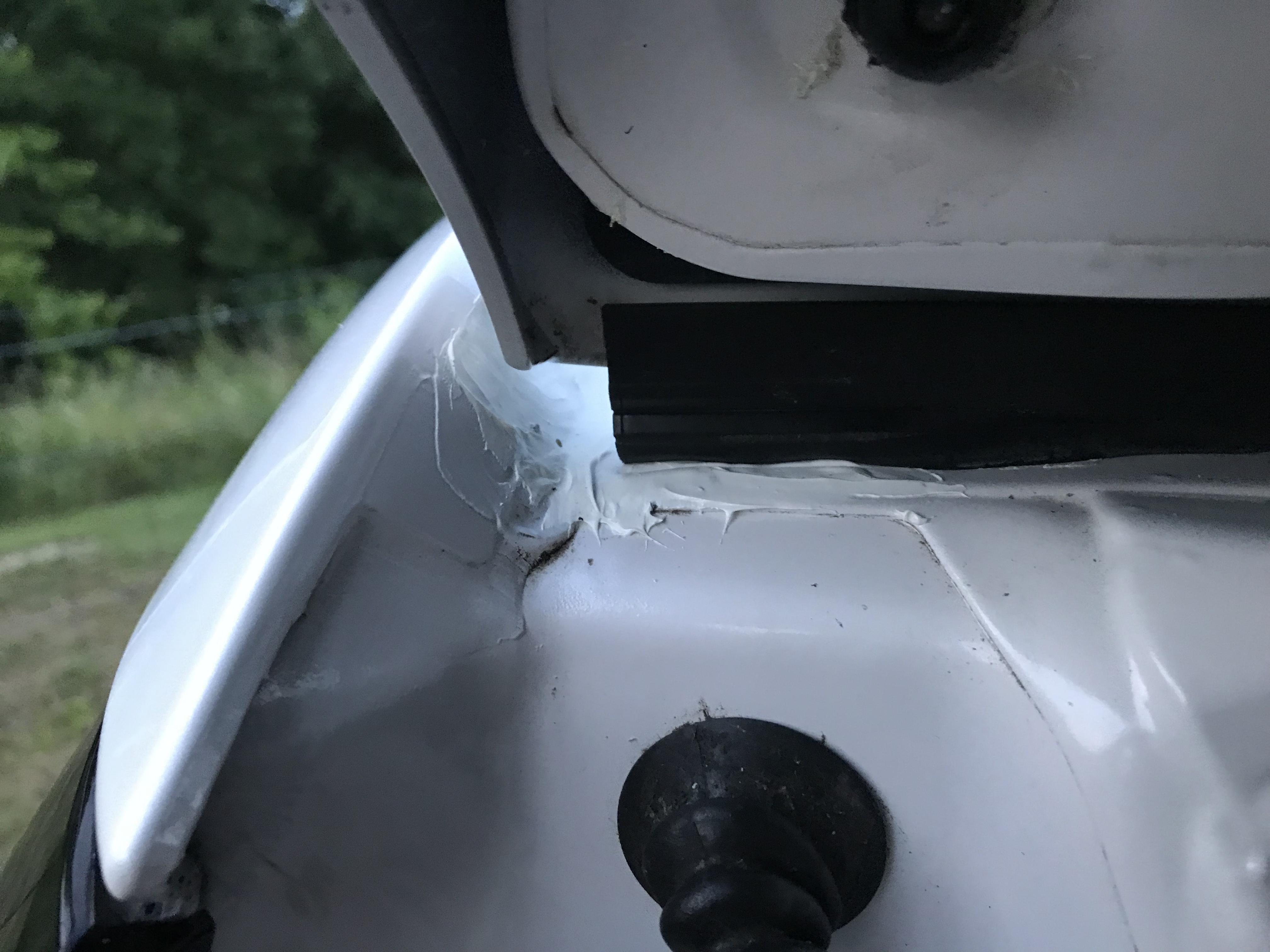

So in a nutshell, they removed the spoiler and replaced some type of gaskets under there. Then the liftgate was fully removed in order to repair all of the cracks in corners and around the hinges. I’m not exactly sure what they used, but it’s some sort of repair material that they said would hold up. They charged me 100 bucks. Not bad. I am praying that all my water issues are fixed. Here are a few pics after the repair.

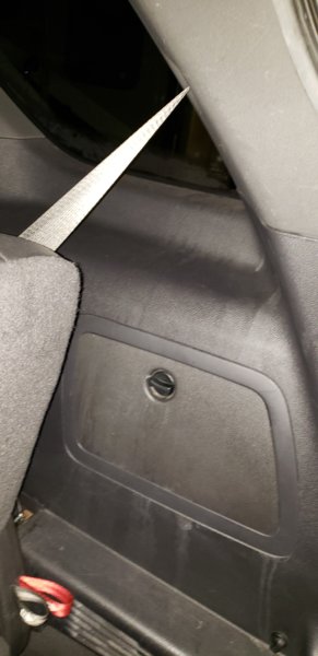

My 2016 Explorer Limited ( no sun roof ) is leaking into the rear carpet / floor behind the third seat .
It has 14K miles .
I was checking the spare and found the matting under the spare was soaked as well as the carpeting on the drivers side in the rear behind the third row .
No visible dripping .
It's going in to the dealer on Thurs .
Anybody with a 2016 having similar problems ?

Welcome to the Forum Rich.:wave:
That is not a very common place for a leak. If I recall, I think there was only one other member in this thread with something similar. Water Leak
Is there any moisture in either front footwell?
That is some ugly repairs. You think they could have smoothed out the sealer since they were charging you.
most sealers are self leveling for a few minutes after applying, after that they start to hold shape. I doubt the repairs would even be noticeable if the pictures were taken from a few feet away, especially being in the hinge area. Got lucky since sealer comes in 3 colors usually and paint wasn't needed..
