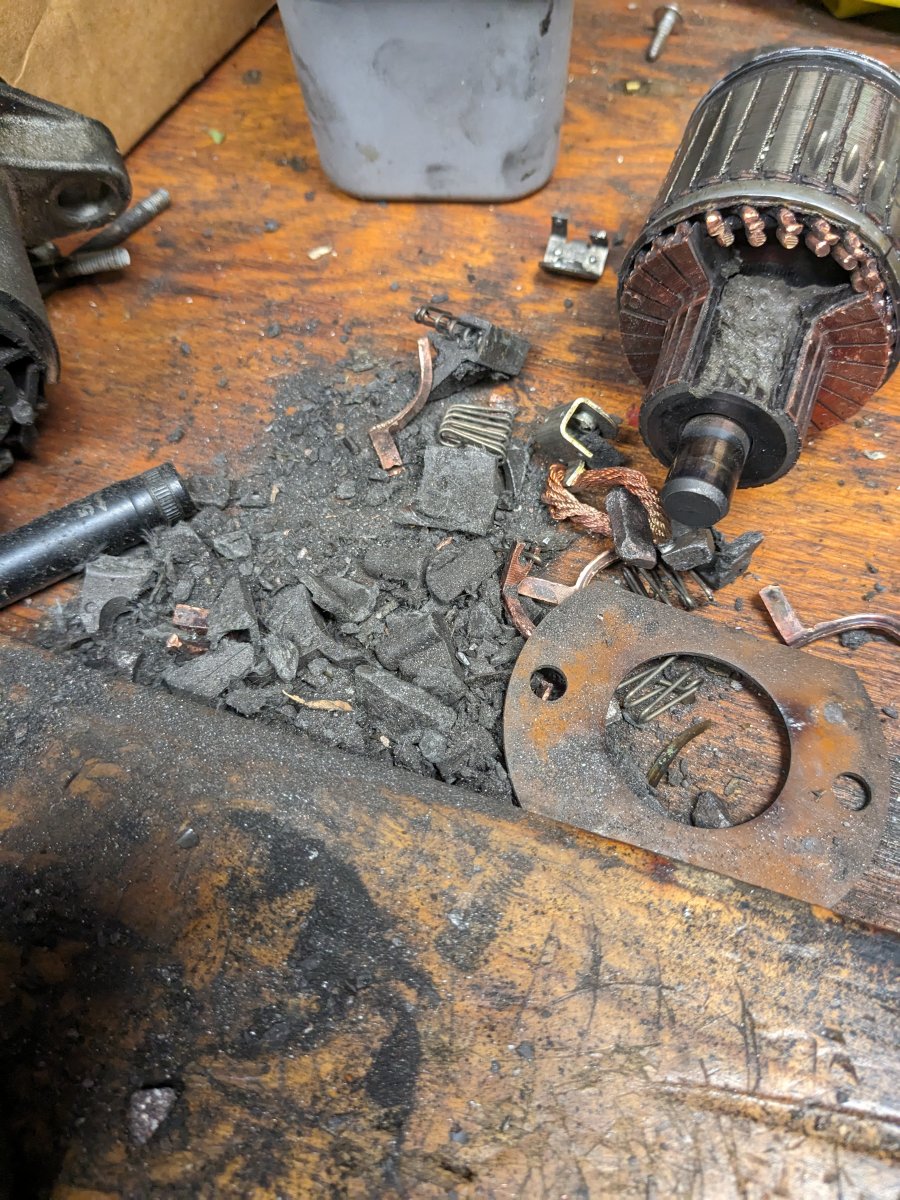

A while back I posted about my neighbors 98 5.0 starter blowing the commutator. Brush holder and brushes to bits I checked out all the ancillary decides for problems and found none. I explained to her that these parts don't just explode like it did for no reason and being I can't duplicate it there is a real chance the failure will repeat itself at some point. I did tell her that the ignition switch is my bet as to what's going on. It worked fine so she elected to do nothing at the time. Then on Friday she calls me and says she was driving along and the starter started making a grinding noise. She shut it off and it would not restart. Pulled the starter and took off the end cover and same exact failure as before. Carnage. Commutator chowed. Brushes blown up. Then she asks me if I got a receipt for the used starter I got for them so they could warranty it. No warranty it was not it's fault it blew up. Being this vehicle only does this once every four to six weeks I probably will not duplicate it. Intermittent problems are the worst things to diagnose. I'm going to tell her to get a starter. Ignition switch and relay and cross my fingers even though there aren't a whole lot more parts involved in this debacle. Going to check flywheel now.
