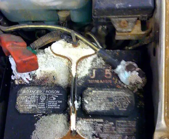

My engine was all cleaned and detailed with a new battery before I bought it. Maybe the old battery looked like the one in this photo! My coolant was really dirty, probably original at 127k miles
It should be noted electrolysis is the main problem with these radiators, eating pin holes though, and Ford doesn't have a fix. I have seen -4 volts between the coolant and the negative battery terminal. I have replaced the radiator 7 times in the same 06 Explorer. Changing the coolant yearly helps. Grounding the radiator core makes it worse. Sure makes you think about the price of the next one.

Can you explain to me how the corrosion in the above photo happens in relation to old dirty coolant? Or is it a ground issue?
I have this same problem on my 96 Escort, the battery holddown bracket builds up with corrosion even though both terminals are free of it.
It’s had me stumped, and I never heard this concept before, and I realize an escort is not an Explorer, but maybe the cause is the same. Trying to learn something. :)
