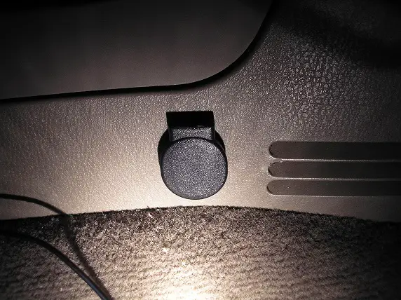

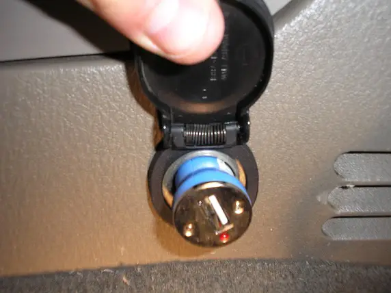

I installed a third outlet. Can't believe there is only 2 outlets for a 7 seater car!
