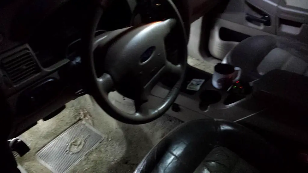

The pics aren't great and I haven't cleaned my truck since the install so forgive me, and yes I know I need floor mats...
The interior floorboard lights. They make a world of difference and this picture doesn't do it justice. They come on when the dome is on, whether it's the light switch or opening the doors. Obviously they go off with the dome as well. The wire I tapped into is in the door sill at the drivers door. I removed the kick panel where the e brake and hood latch are, then removed the door sill. In a channel under the carpet there is a large and small bundle of wires. In the large bundle there is a small black wire with a blue tracer. That wire has power every time the dome is on. I found two black wires with blue tracers in that bundle... test with a voltmeter to find the right one.

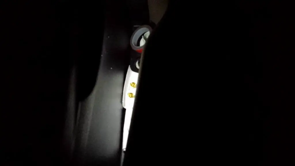

Map pocket lights. These are easy, I didn't even have to remove the door panel. They come on with the headlights & I used the bulb power on the door lock switches. This didn't turn out quite like I wanted, but not bad considering the ease of install.

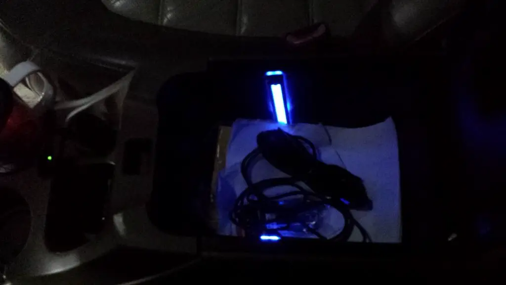

I also did this a few months ago. Small bar lights I bought at Walmart for 10 bucks on the inside of the center console. I got power from the lighter plug and wired it to a normally closed push button. When I close the console lid, it hits the button and opens the loop turning the light off. I'm not a huge fan of the ricer blue but it will accent something I plan to do later.
Below is a link to the lights I used on Amazon. You can look around and get waterproof strips for about the same price, as well. It's a 15' roll and you can cut it to length (cut strips after every 3rd LED) and solder your own leads on. The 3M tape on the back works okay if you clean the surface and heat the tape a little with a lighter.
