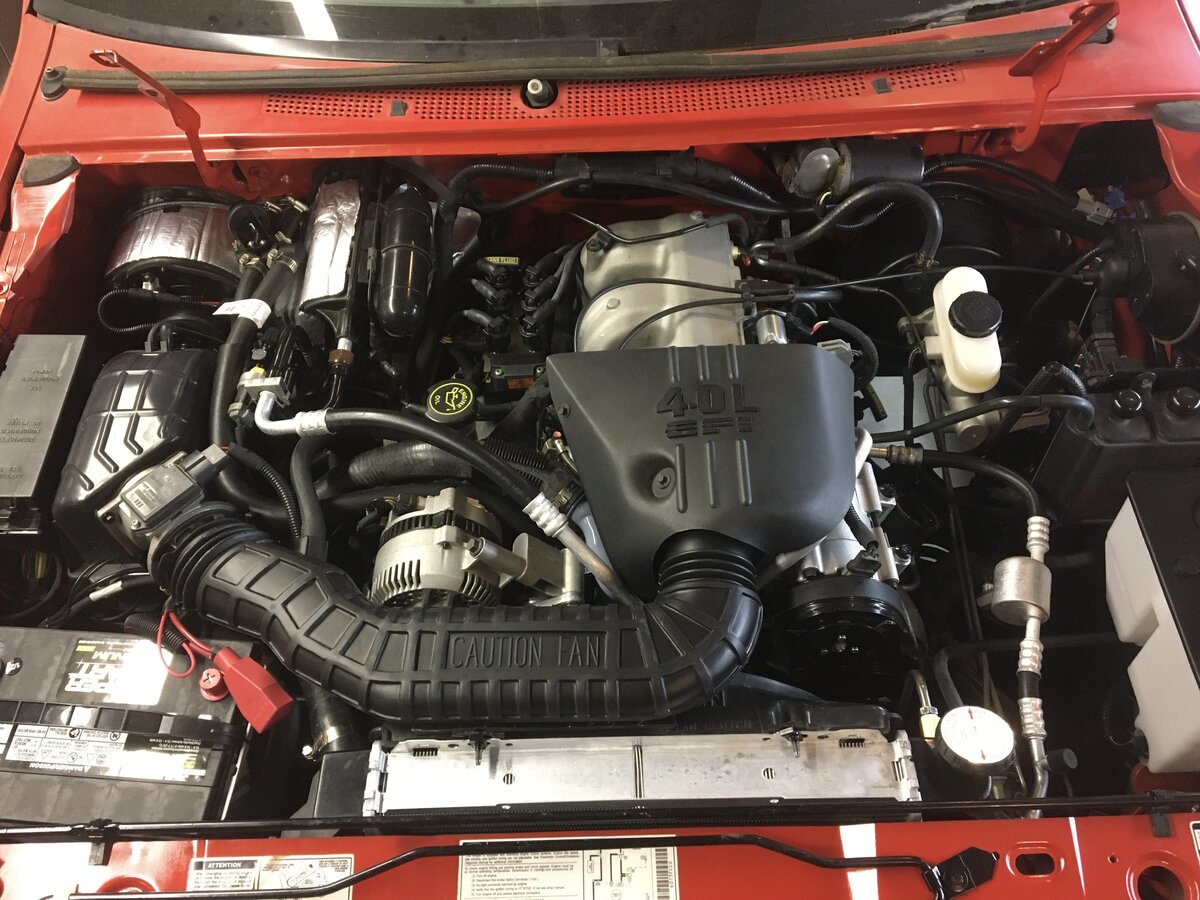

Finally added the finishing touches and started it. Needed some tightening here and there but sounds nice

Thank you! It almost is. The engine was rebuilt and with the exception of the starter (which I disassembled and went through), every part on here is new/reman. Every sensor and vacuum hose is new; disassembled all wiring harnesses and went through them all. Tested and replaced anything needing attention in the PDB. It was an expensive pain in the ass, but I'm happy with the result.

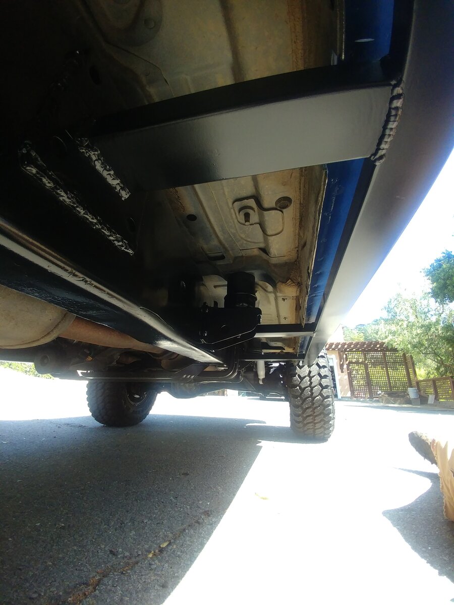

Yeah between the engine and rebuilding and repainting the entire undercarriage I'm probably just going to buy another Explorer to thrash, lol.

If you replaced it, what hose did you use for the crankcase vent hose that connects from air box assembly to the oil fill? The stock one isn't hard or overmolded , and I have had smog techs try to fail my car in recent years not recognizing that the hose is stock.

Just like donalds posted, I’m not entirely sure but at least $3000. Probably $3500-$4500. If you do the rebuild yourself it might be less expensive but I had a local shop do the long block for $1600, and many of the new parts aren’t cheap- like the cam synchronizer which was around $200 alone. I’ll say this- I saved a ton just from the advice and experience of the folks here. I don’t think I would’ve done anything without you guys.
ETA: okay after much thinking I would put this closer to $4500-$5000.

I think I just used 5/8 gates heater hose. It might not be the correct application so correct me if I’m wrong to use it. My old one was horrendous and the old guys at the local parts store said it should be fine for use on this part. I’m sure it has to be fluid rated so who knows...

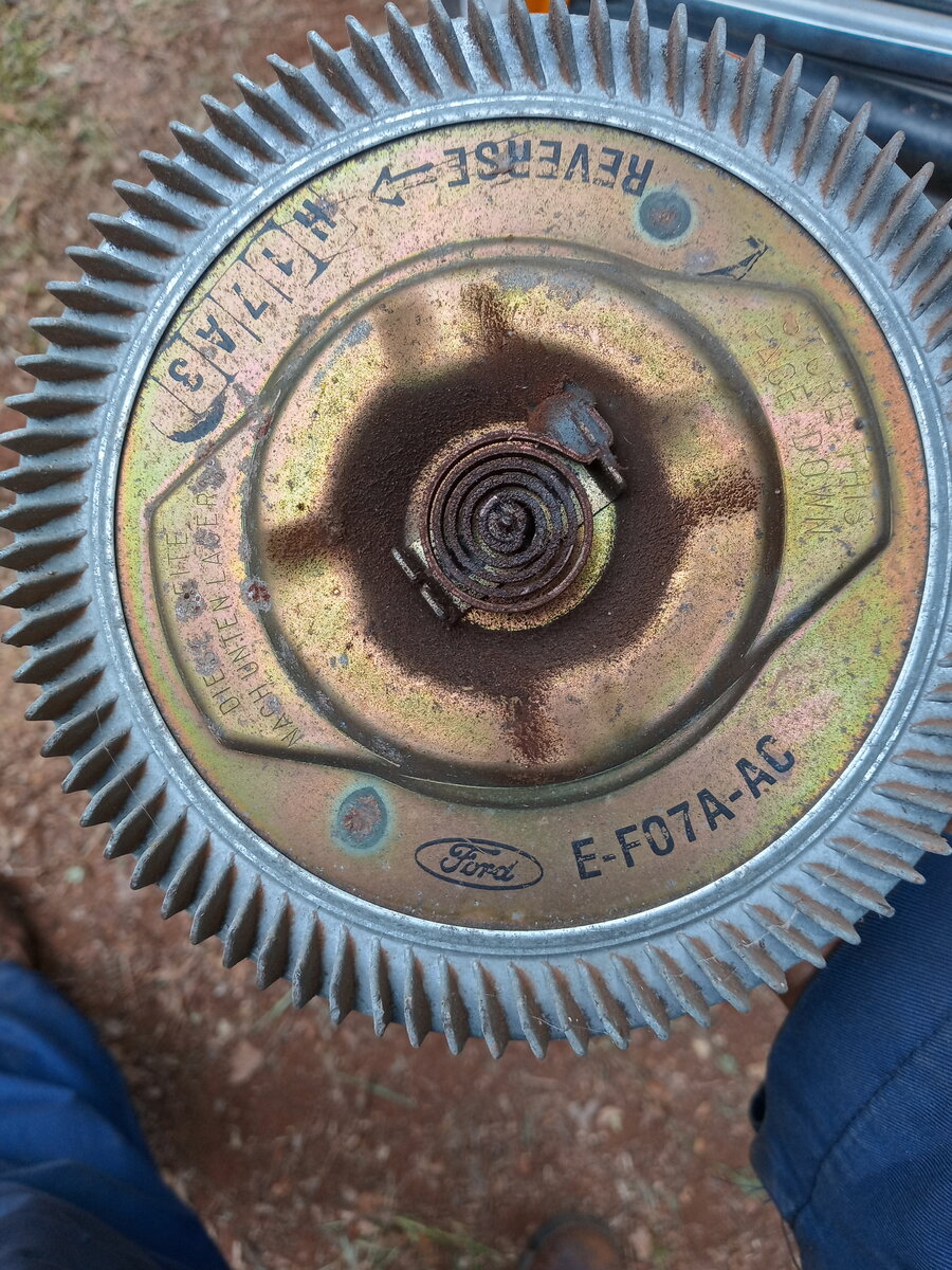

Well not today but over this week I have done a lot. I replaces the fan clutch with an USA made one from autozone, thought that was cool. I changed the oil filter not the oil and man there were some rust pieces collected at the top of the filter. My explorer had set for a few years about two or three. I had changed the filter and oil about a thousand miles ago when I first got it. The previous owner wanted to take care of it but he seemed busy. It was his Grandpas truck and he was wanting to see it put back on the road. I had a feeling especially because I hear about sludge build up that it might appreciate a fresh filter. Also I am learning that sitting fluids dont seem to stay fresh. Did the filter yesterday and ended up finding out I dont have back brake right now. I put to new front calipers on and to new brake hoses for the calipers. When I got to the point of bleeding the old fluid out of the rear I was unable to pump any fluid out of the bleeders. I also did the zip tie throttle cable boost and a fuel filter. The filter wasnt to clogged up but it was holding back some garbage. Not suprising and I have been running out of gas a couple times lately. A lot of stuff I believe might still be original. I think I have 248,000 miles on the SUV. The grandpa and original owner took it in for regular service. It has a Ford owners manual that shows it being serviced a lot. Seen that it was being taking in at least to 150,000. The fuel filter I pulled off was Motorcraft and the clutch fan was Ford. I know the filter was probably changed years ago at a Ford dealership or someone might have bought it from a karts store? It was rain last night and I sure was enjoying driving with the sunset. I am glad I put some duralast wiper blades on to the other week.
