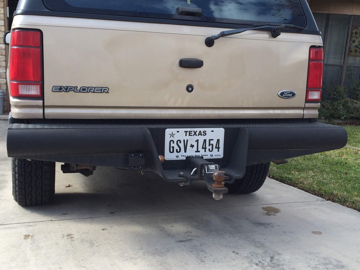

As good a time as any to get/make a steel replacement!
I'm in San Antonio right off 1604/I-10 on NW side of town. Those were a set of RanchHand bumpers I found on Craigslist back in '09. They were on a 94 Eddie Bauer Ex that was being parted out. $200 for the set but I had to pull them off. I never said a word, just shook the guy's hand and then went to get my tools!
Wow what a steal! Im out in San Angelo about 3hrs north west of you.
