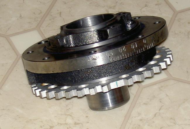

The pistons you want forged, don't mess with cast aluminum or hypereutectic. Check out complete assemblies, that will give you the best total pricing, plus being a matched set. Check to see if they are balanced, and what balance weight they are made for. I think that the strokers will all be 28oz, and you will have to deal with a machinist who can do work with a special balancer that you will have to create. I have one that I had custom made, and my engine builder/machinist had some issues balancing the assembly.
The machine work for this balancer likely makes the 28oz. balancer a little off. I found Total Performance to do that, a notch is cut in the backside edge of it to press the Explorer trigger wheel onto. This will work for me, that is a stock old Ford 28oz unit, they are only about $75 new. The total for this was about $330, but knowing this it may be good to look into some aftermarket crank pickup system. If any aftermarket system could be added to a 28oz. balancer, the cost may be less. I didn't go that route, preferring to try to keep the OEM crank trigger parts. So do look around to see if the crank signal can be duplicated with an aftermarket part. If it can, then the choices for balancers would be very large, and balancing the engine would be relatively easy for a machinist. Regards,

well I've been lookin at eagle assemblies and I foundone that say it is internaly ballanced. And the balance is listed as neutral.
How would it be internally ballanced?
That means that there is no counterweight material on the balancer or flexplate. That is more ideal, usually more expensive, but you have to match the balancer and flexplate. The flexplates are easy to get in the needed weight and tooth count.
The balancer is what you have to worry about much more. That must match, and remember that the 96+ Explorer engines have to have the crank trigger signal for the OBDII PCM. I don't know if there is a zero balanced dampner(balancer) which can have the trigger wheel added onto. Do the searching for a balancer and trigger signal before settling on the crankshaft etc.
ok so how does the crank trigger signal work. Is it a magnet pressed into the balancer or what.
