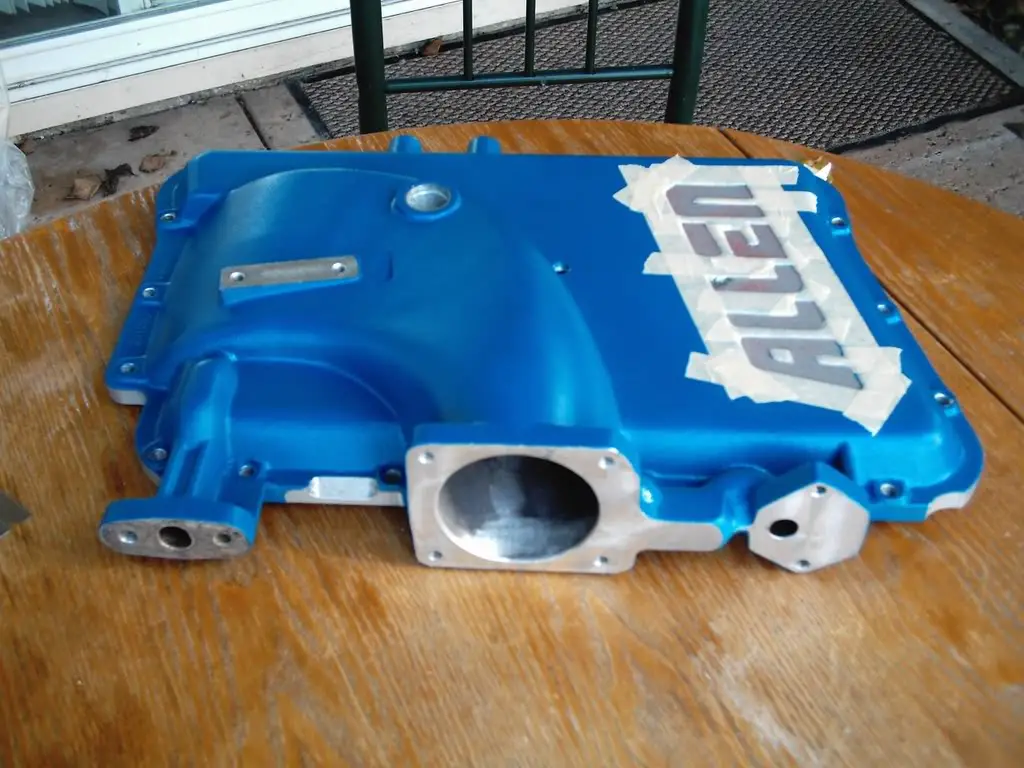

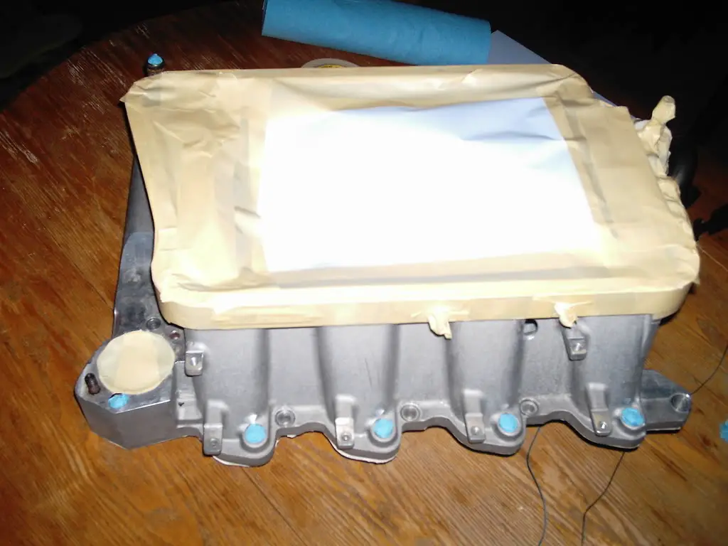

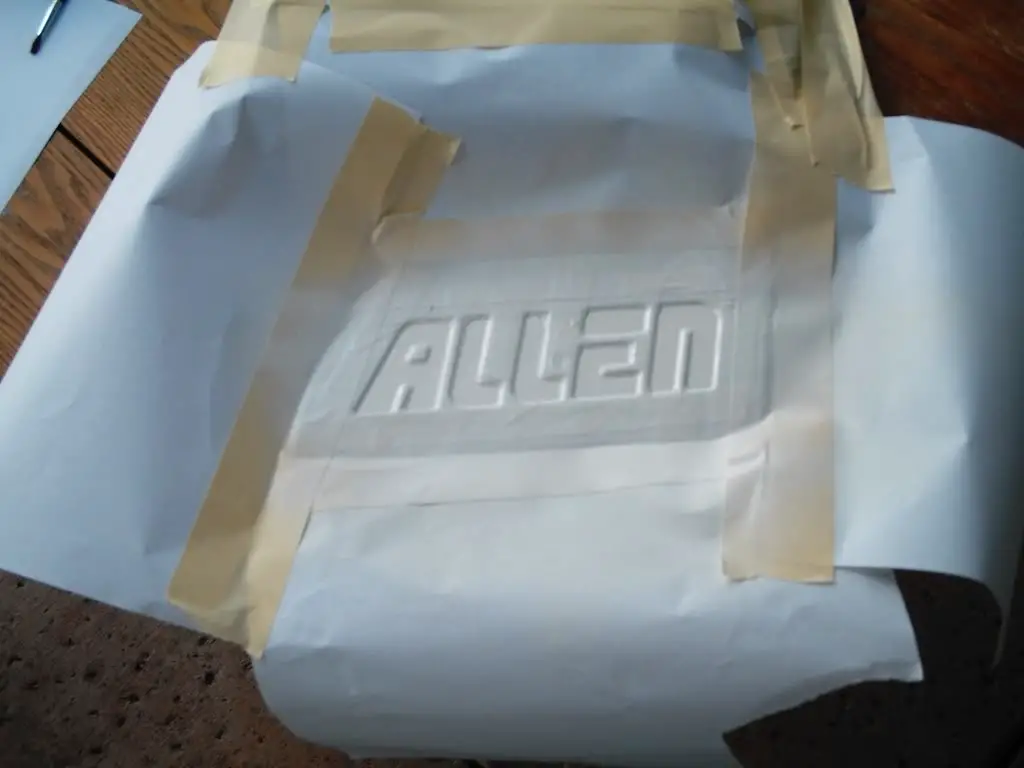

looks rediculously good.. i just repainted my calipers and thought that was hard enough work... i cant even imagine how long it took u to tape off the ALLEN letters and paint that up... nice work and i cant wait to see some videos of some action
Yes time consuming. You have no idea how many times I looked at the SC and dreaded the job.. I finally said... all this thinking and I could have been done... so I picked up and made it happen.
I'm looking at my calipers everyday saying the same thing... lol I feel like painting my front upper control arms also, and my rear diff cover, blue of course.

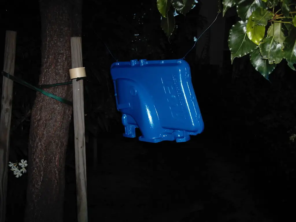

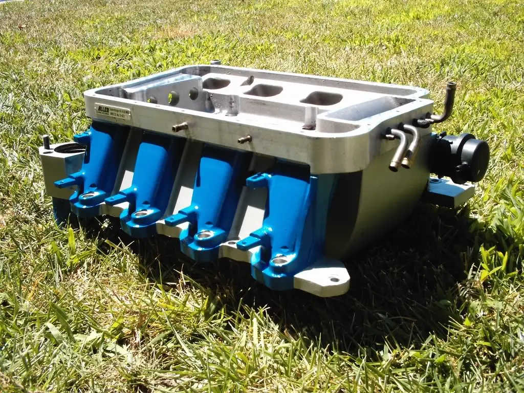

Enjoy these pics:
The "Intercooled supercharged" part I did free hand.

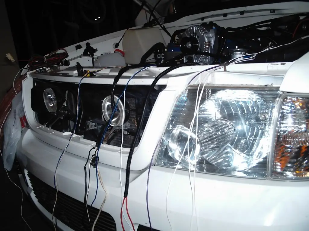

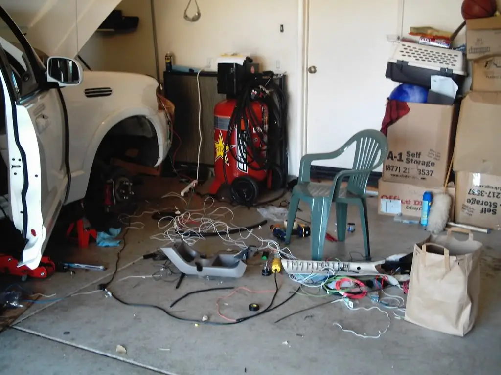

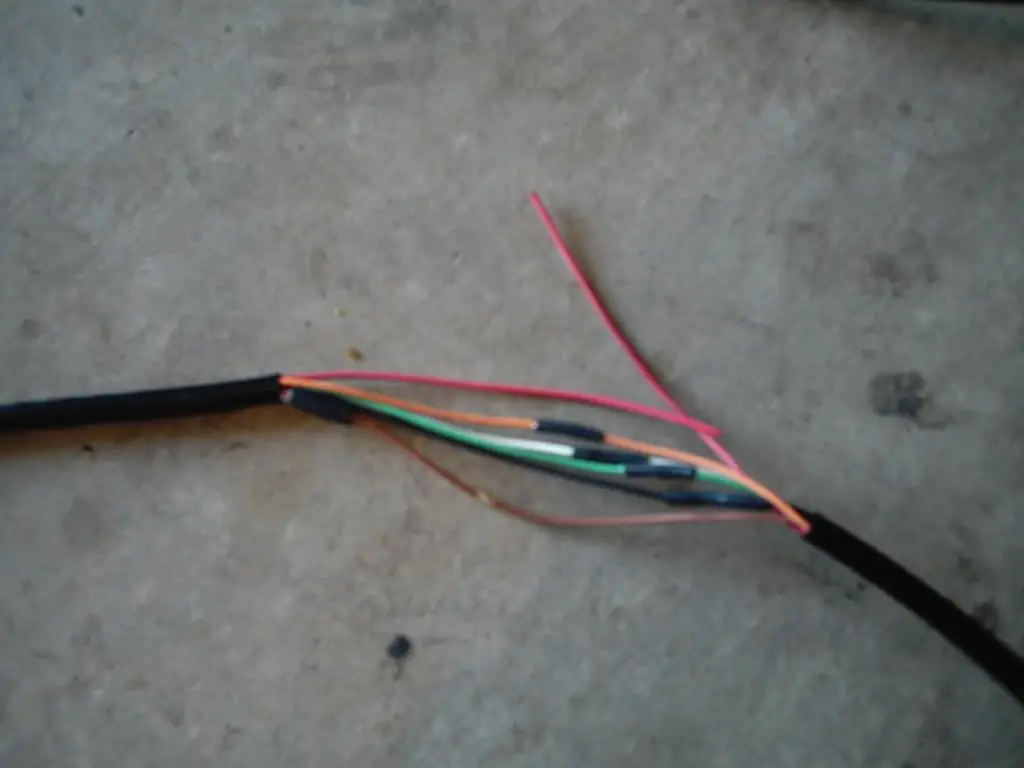

Getting through the electrical. Fun fun :rolleyes:
There is not one wire im not soldering and covering with adhesive lining shrink wrap... no crimp connectors and no electrical tape, anywhere.
wow i love the detail your putting into this..
this is amazing
btw do you have any pics with a grille over those lights bc ive always wanted to know what an ex would look like with those
Thanks...
Here you go:

Great stuff Alex, we are all enjoying the fine work here.
looks awesome and i never noticed the lights mounted under the grille there... nice fabrication... truck is rediculously clean and nice work so far... looks like uve got ur hands full with the electrical so good luck
