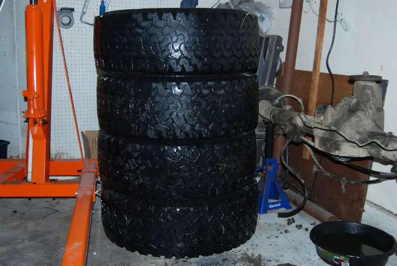

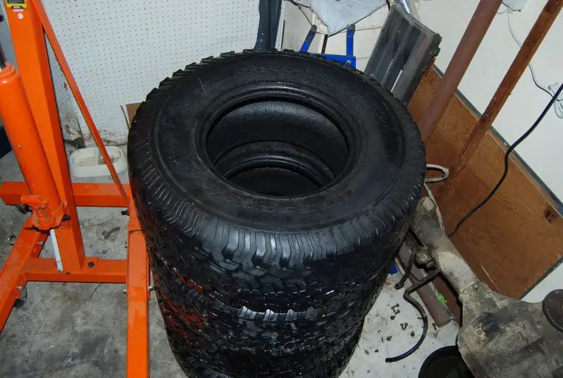

well ill get the spacers first, if you can help then ill mount the tires, if not ill just run the 32s on the rear only for the trip.
no way i can run them without a lift, your bald ones rub (very little tho, just barely touches the wheel well)
besides, then it wont look as funny lol
