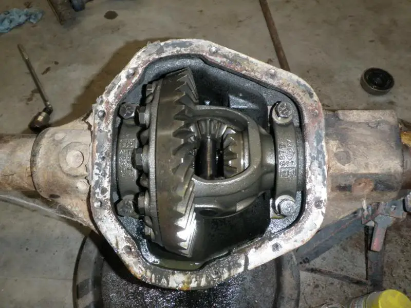

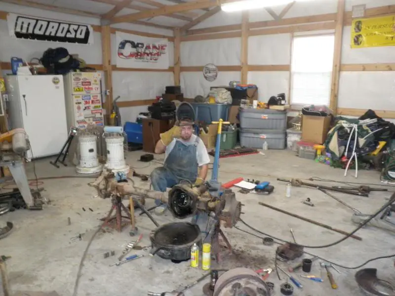

Well, Neil and I FINALLY got some work done on this project today. We started with the Dana 60 and took the hubs, brakes, and spindles off and pulled the shafts out. Cleaned it up a little. Everything looked to be in good shape (not bad for 22 year-old parts!).
Here you can see it stripped on the ends and Neil making a custom tool to keep the pinion from rotating while we worked on pulling the carrier:

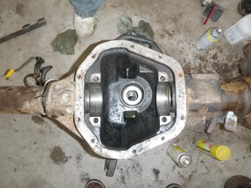

Here's a shot of the inside:
Now you see guts, now you don't!

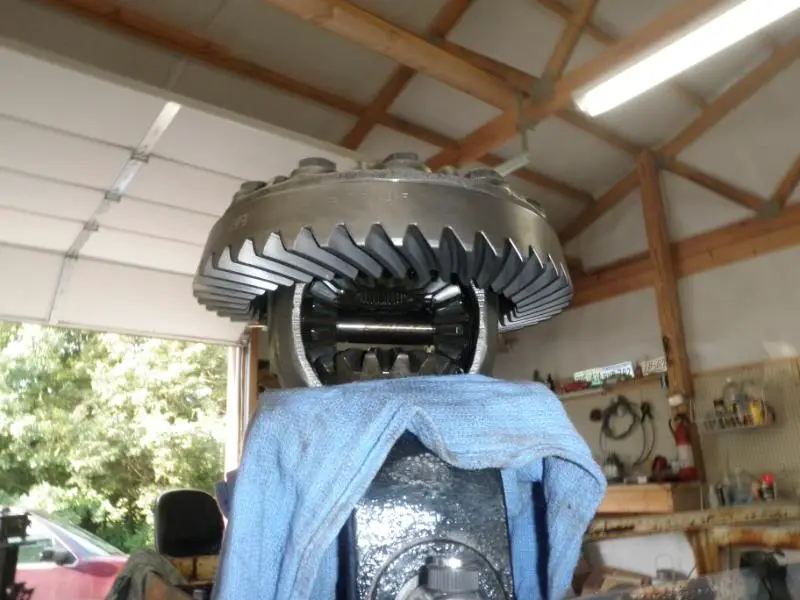

I did some grinding on old bearings to use as test fits for later and did some parts cleaning while Neil did some work on the carrier and pulling it apart. Here's the carrier with the new 5.38 ring gear installed:
Had to call it a night about there. Neil fabbed a cart to roll the Sterling around on and we should be able to get to that this nex weekend, hopefully. A lot of my wrenching time lately has been on the other three vehicles in our possession, mainly the Waggy so I can drive it once the Explorer hits REAL downtime.
