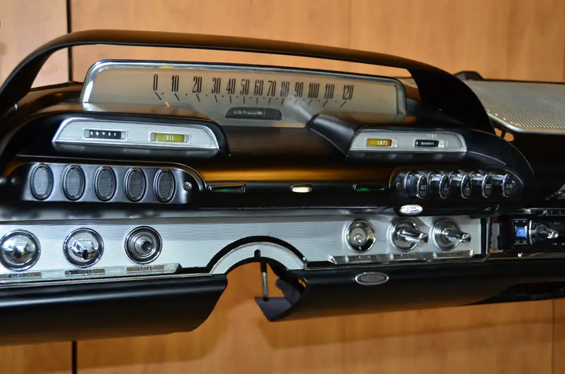

Here is a pic of the dash from the same model:

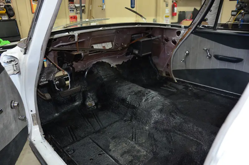

The brown car in the attached photo is the actual car I bought. The green car is what they looked like new.

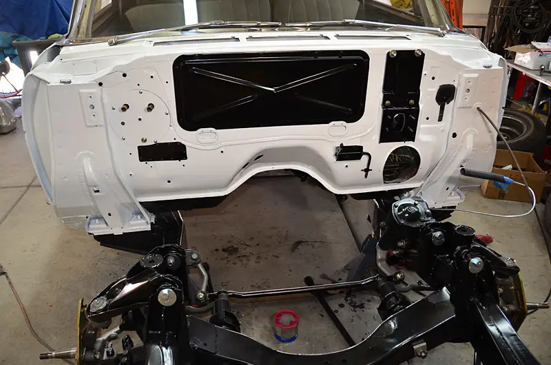

Slowly coming back together...

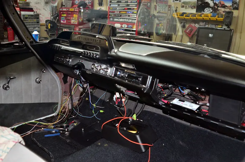

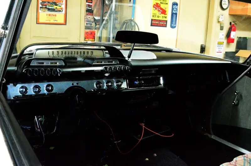

Just put the dash together...
That is such a great looking dash. Did you have to cut welds to remove it?
Everything is coming together slowly, but surely... So many little projects along the way that eat up tons of time.

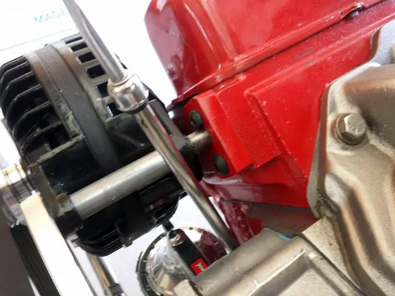

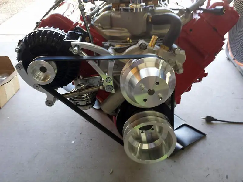

Here is one of those time eaters... The little adapter that attaches to the cylinder head took me three tries and hours of time to get to the final product:eek:
It's the little things that take the longest time.

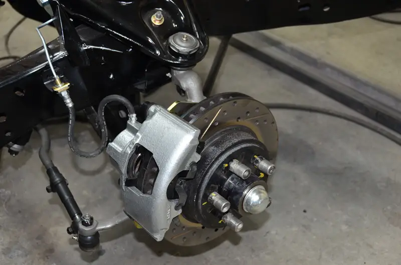

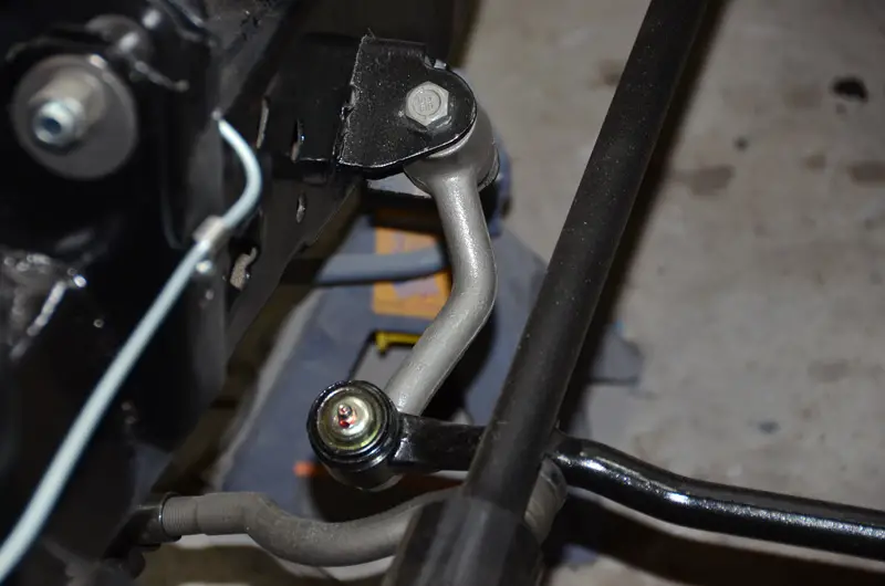

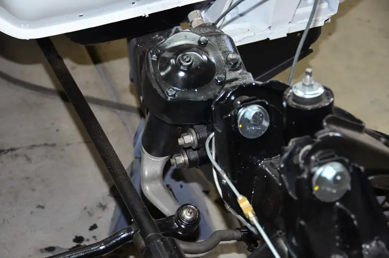

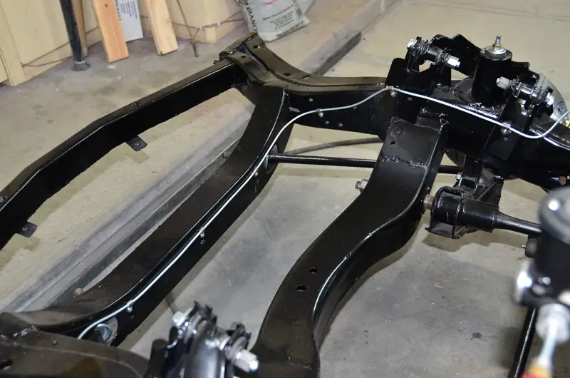

It's definitely a resto-mod. I've been making subtle modifications to many parts that most people will never notice. I boxed the lower control arms and front subframe crossmembers and I will be fabricating subframe connectors as well.

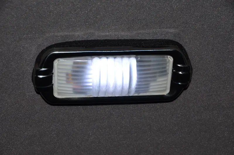

The going is really slow right now. Just getting everything back on the car and wiring everything up. The dome light is out of a 1920s Dodge. It has a stainless steel bezel and a glass lens. Unfortunately the shot didn't come out great as the stainless steel was reflecting the black herculined floor.

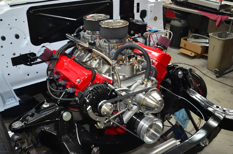

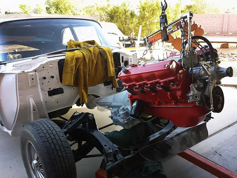

Milestone day. Mated the engine and transmission for it's insertion into the engine compartment tomorrow morning. Why tomorrow? That's when I could get a friend over to help. The motor mounts need to be custom fabricated and it will be much easier with a helper.
I sure hope we can pull it off in a few hours, at least getting the mounts fully tacked in place since tomorrow is supposed to be 108 degrees and the car has to be pushed outside for this process:eek:

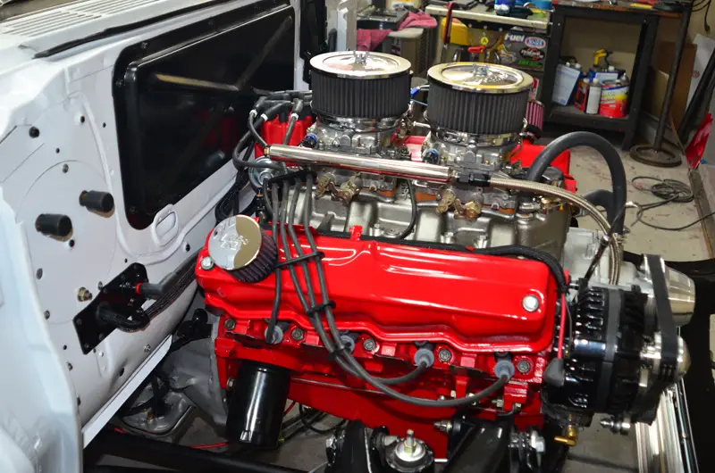

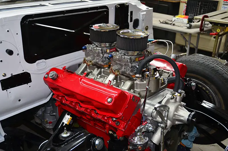

The engine is finally in it's new home.
Very nice.

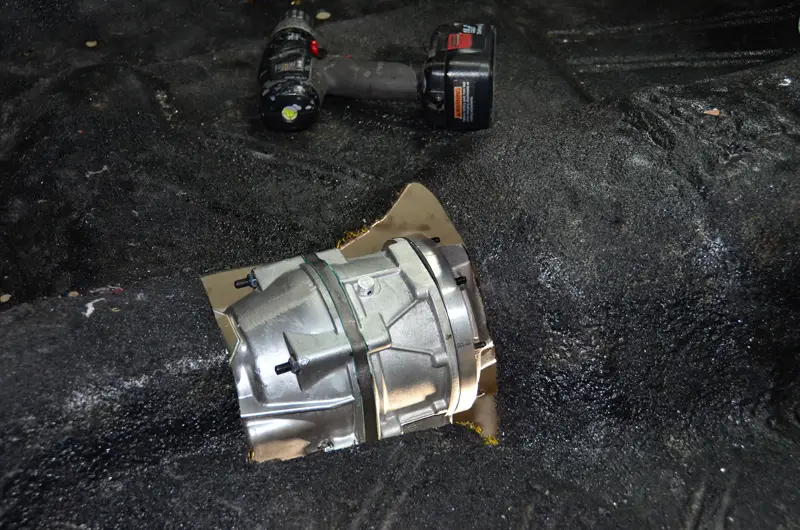

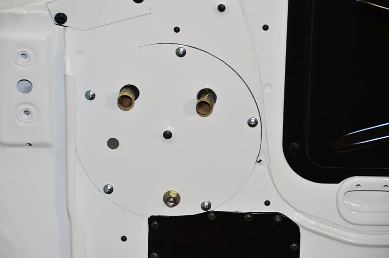

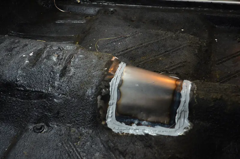

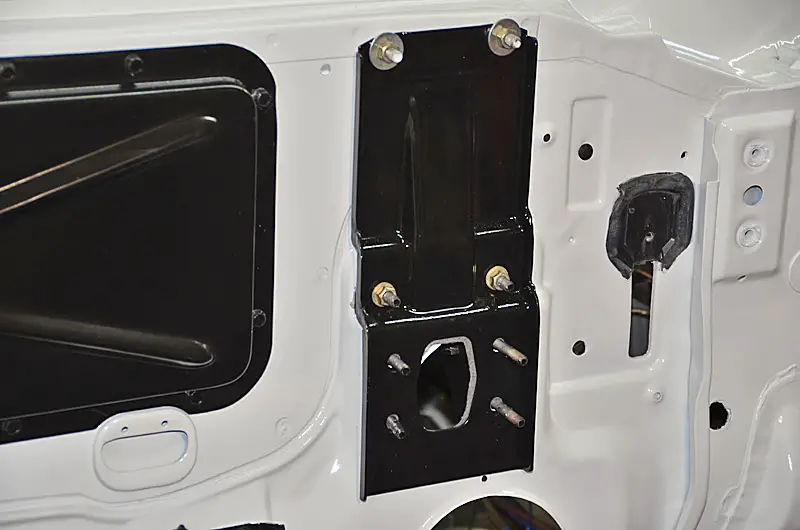

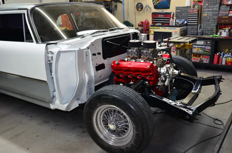

Needed to make room for the OD unit.

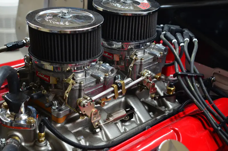

Engine's all dressed, dash is in and the wiring is well on it's way.
