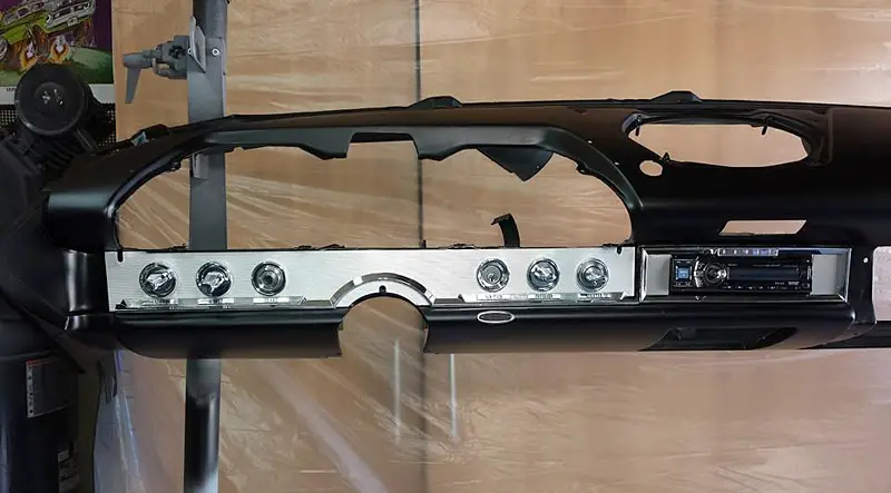

Here is a pic of the dash from the same model:

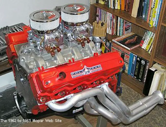

I decided that rather than throw any more money at the slant six it was finally time for an engine swap. After going back and forth ever since buying the car, I finally decided to go with a built 318 poly. I found a guy in Southern California who "wrote the book" on poly motors. He will be building my motor which will be between 390 and 408 cubic inches depending on what kind of a bore is needed to restore the cylinders to round. He doesn't like going to the maximum overbore just to get bigger numbers, since it means the engine is either a throw away if it ever needs to be bored again.
He also has an aluminum dual quad manifold which is period correct. It's a beautiful looking setup and will look great under the hood.

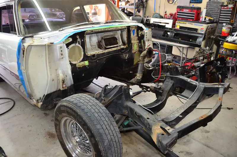

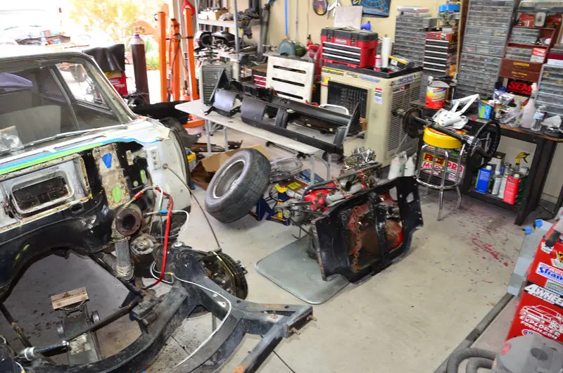

Under the hood... well of course I couldn't just throw a new motor in the old cruddy engine compartment, so... I'm tearing into it big time. No, I'm not doing a full resto, just a real nice engine compartment and front subframe detail. I plan on stripping the firewall, inner fenders, core support, etc and bringing them back to like new appearance.
I may have bitten off more than I can chew. The engine is supposed to be done in two months. Right now it seems that I have more than two months of work to get it all back together. I have seen ads for mobile media blasting services. If I could get someone out here to strip all the parts down to bare metal that would save me a load of time and I could get busy on primer, paint and reassembly. I plan on investigating that possibility on Monday.

Polyspherical combustion chambers. Also known as the "semi hemi". It uses canted valves like the hemi, but with only one rocker shaft instead of two. The heads aren't known to be great for flow, but they are great torque producers. The setup I'm looking at should be around 425 HP and 450ft lbs. The torque band is very wide too making it an excellent choice for a street motor... Or so I'm told. We'll soon find out for sure ;)
Oh, yeah, the block is almost identical to the later model small block Mopars, but the deck is different so the heads won't interchange from one to another. Everything else swaps. Crank, timing chain, water pump, fuel pump, distributor etc.

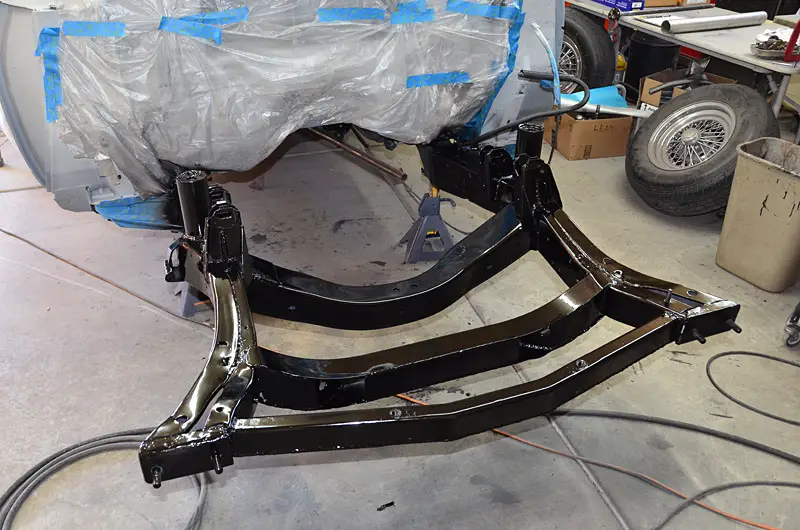

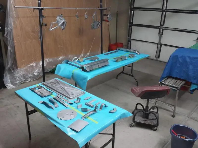

All blasted and ready to go... I laid down the epoxy primer today:thumbsup:

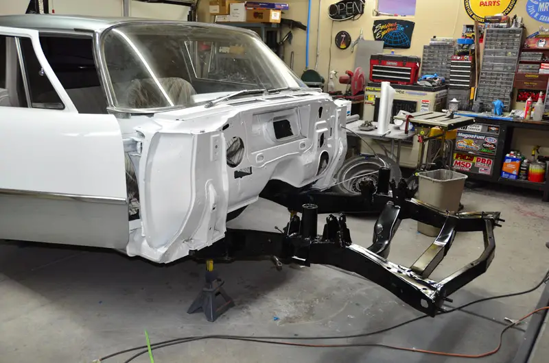

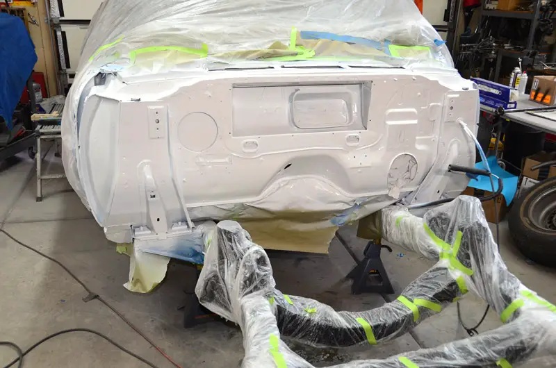

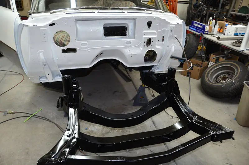

Happy day!! I'm done with the paint work:bounce::chug:
Time to start the re-wiring :D

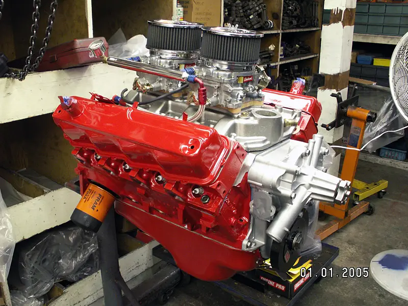

I got an email from the engine builder yesterday. The engine has been broken in and dynoed. He said everything went well. I am awaiting a call and email with the dyno sheet.
Looking good Rick!. The engine choice is pretty unique. I don't recall seeing valve covers like that before. The steps are kinda cool!
..:scratch:..January 1st, 2005?
..It's time for someone to set the clock on there camera..I get nervous when people send me pics of items I'm paying for and the date stamp is off by years..:D
Finally unwrapped :D
