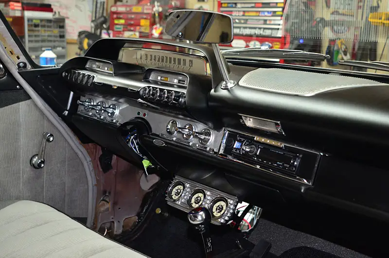

Here is a pic of the dash from the same model:
The brown car in the attached photo is the actual car I bought. The green car is what they looked like new.
It's a beast that's for sure! I really like the front bumper and the dash on this model. If I decide to keep her my plan is to drop in a ridiculously powerful BB Mopar and have a hell of sleeper on the street:D When I say ridicoulously powerful I'm thinking along the lines of 750 - 1000hp on pump gas:burnout: A turbo motor isn't out of the question.

Well, the dash is in, so, less stress now:thumbsup:
Yeah you're not kidding. Now I don't have to worry about the dash falling off of that jig I had set up to hold it. I had this unshakable feeling that I was going to open the door and see it on the floor one morning :(
Then there was the fear of scratching the hell out of it on the way back in... Thankfully none of that transpired :D

How did you refinish the dash? Is that just paint?

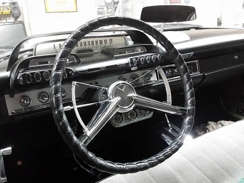

That shifter took a bit of backyard engineering to get it to fit. The handle was way too long and interfered with the dash. I cut a few inches off the shifter handle. The shifter ball is hollow plastic that's chrome plated so I removed the brass nut insert and ground out a grove for the shifter handle to slide into. Next step is to use JB weld to lock in. It's a perfect fit and you can't tell anything was done to the shifter:chug:
Down to bare metal, epoxy primed, bodyworked, epoxy primed again, high build primer, and finally SEM Hot Rod Black as a top coat.

When working without a manual it's easy to screw up on the order of assembly. I had the column in and out three times before it was setup with everything it needed... The worst part was a clamp that attaches to the lower column tube, and has a bracket that runs up to the firewall to provide support. I forgot to put the clamp on before I put the steering shaft and coupler in the column. Removing all that would have been a royal PITA... Since the car is not an OEM "correct" restoration and is more of a hot rod I decided to do some more backyard engineering... I cut the clamp in half, welded up tabs to the side I cut, and now instead of the clamp squeezing from one side, it squeezes from both.

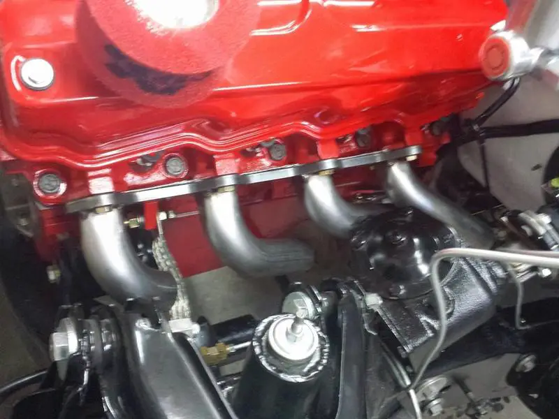

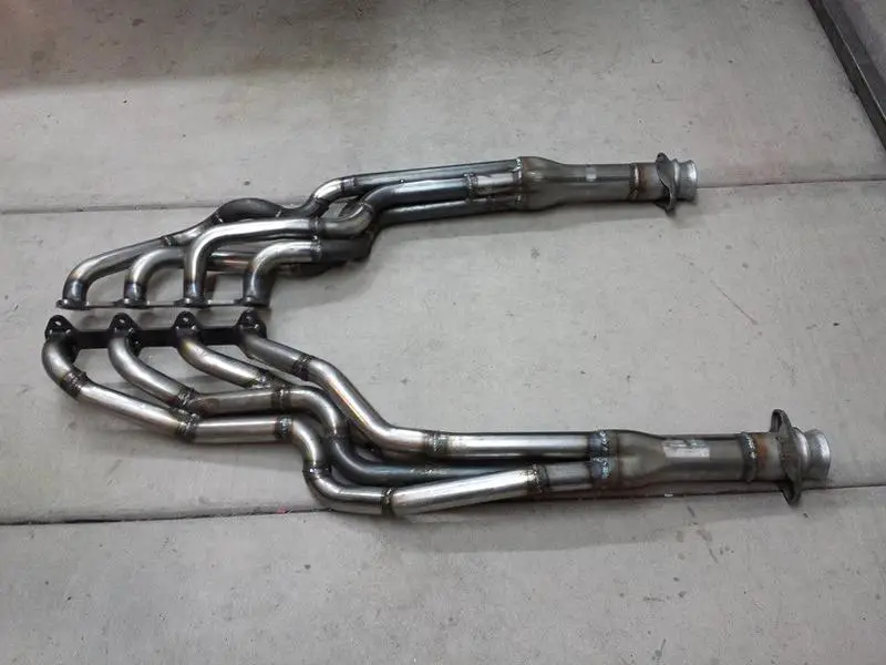

A friend came over to the house and built a set of headers for me... Man, that's not something I would ever take on myself. I have patience for a lot of things, but this isn't one of them ;)
She's alive!!!
Eight and a half months into my two month project and she's alive!!
Took her for a quick spin around the block. No issue :D Tranny shifts hard, OD unit kicks in and it has so much more gittyup than the old slant 6 even with hardly getting into the gas:burnout:
