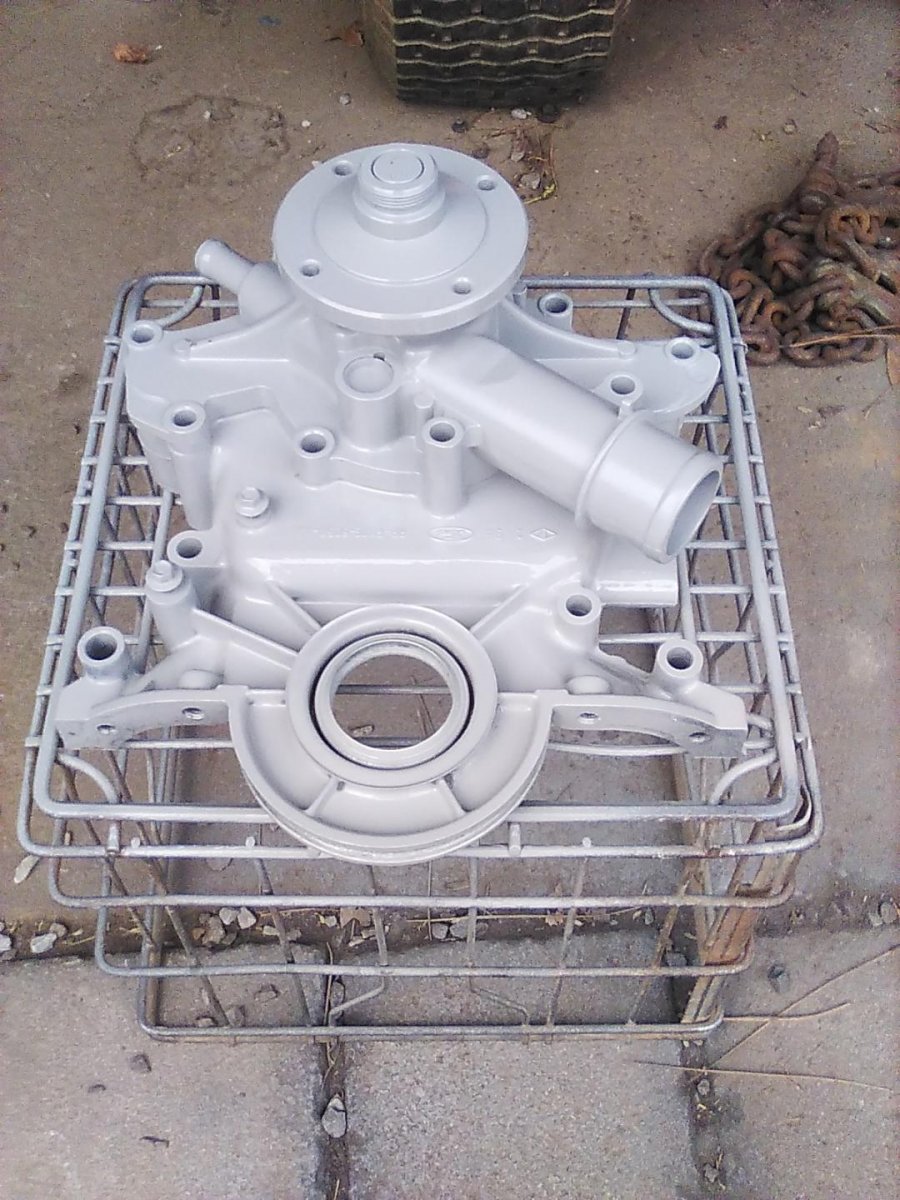

I got a little hands-on time on it this week. I cleaned the original timing cover and cleaned the new water pump before painting. I picked a light gray. Bare aluminum oxidizes fairly quick, so this will be better. The new crank seal needs to go in.

That looks great, nice and clean, nothing like the real parts on these engines. If you want it to look good, either paint it after it's all on, or trim the timing cover gasket before you install it. That gasket overhangs a lot and the light blue doesn't look very good.

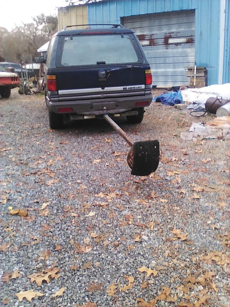

Friday 11-17-23 At work today we moved several vehicles. The '97MM was one of them. It finally moved out of the dirt lot penalty box. Soon, that area will be mud. Now it's on gravel near the buildings. It has a receiver hitch and I was able to plug in the pushbar made of 2 inch square pipe and a propane tank bottom with a piece of L60-15 bias ply attached to it. ~ 5 years ago, I made this tool when I was stuck working by myself.
None of the 4-wheel disc were stuck. That is good karma. The cat living under it is going to miss his home.

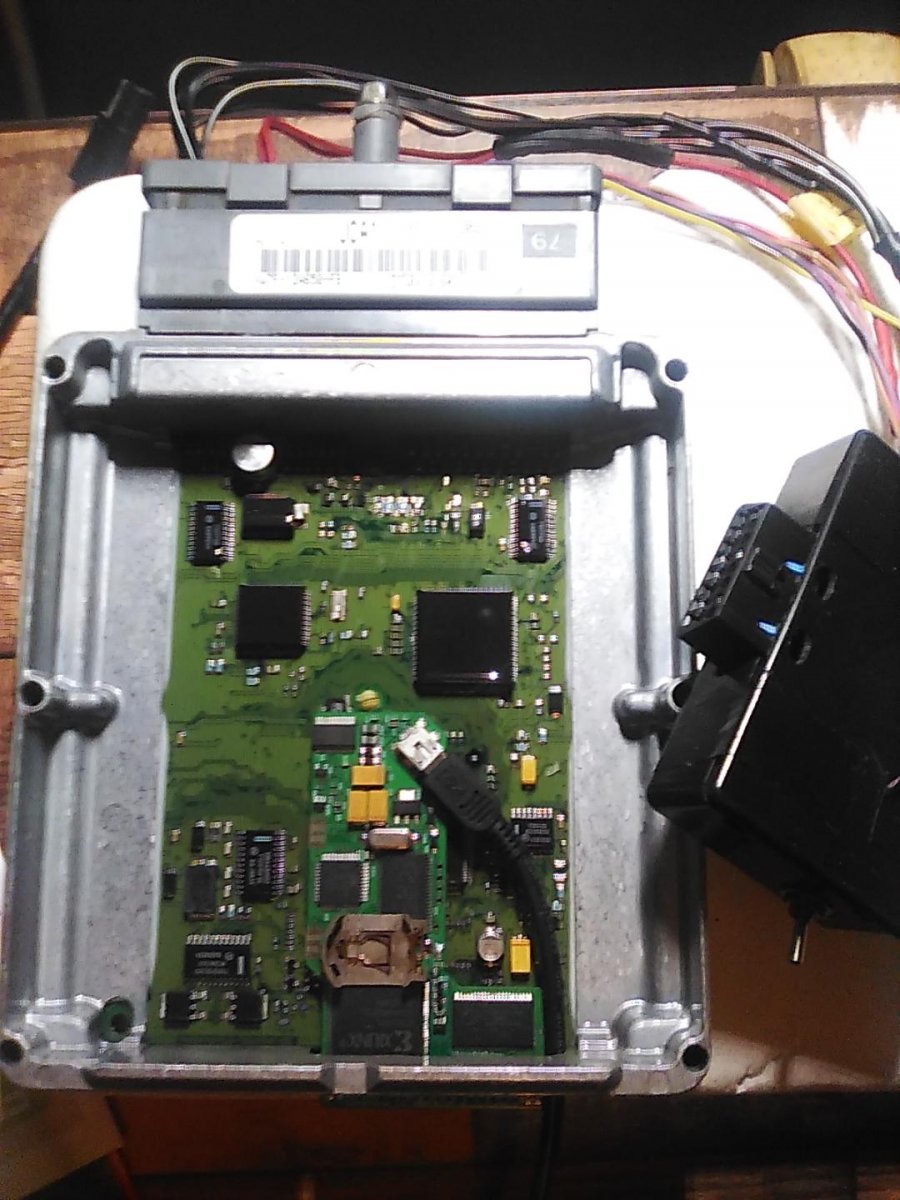

Tuesday night 11-20-23 I had some time that I could work on one segment of the greater project. The last day of January I started making a bench box to be able to read and write PCMs on the work bench and power them up properly. There is a 104 pin PCM connector on one end and it has an OBD2 port to attach a pass-thru device for OBD2 port flashing.
Last night I wasn't using that method. ~ 2 months ago, I purchased one of the last few remaining Moates Quarterhorse devices. It attaches to the J-3 port of EEC-IV and EEC-V PCMs.
I connected a 1998 Explorer V-6 test PCM to the 104 pin black bench box. It has a toggle switch to simulate key on and key off. It was attached to a stable 12 volt DC power source. The Moates QH was installed on to the J-3 port with a USB cable going to the Laptop that had the TunerPro RT software turned on. I was able to successfully read the bin file that is stored in the PCM and saved the file when prompted. Later I opened the file in TunerPro RT and used the Hex Editor feature to verify that the file was completely copied. I just tried to attach a copy of the bin file to this post but it is not a recognized file extension on this Forum. Anyway, it worked. Tonight, I'm going to read and copy the bin file that is in the 1999 Crown Vic passenger car and check my results.
In the picture you may can make out the Moates Quarterhorse computer board plugged on to the PCMs J-3 port.
The OBD2 port is not used when using the Moates QH.

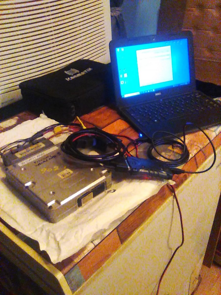

After that, It was time to get out the other device that will be involved in reading and writing to the PCM. There are several types of pass thru devices that attach to the OBD2 port for the EEC-V PCMs. After a failed attempt to purchase A Mongoose Pro for Ford by Drewtech, after my money was returned, I purchased a device through a company in Kazakhstan that I had previously purchased PCMFlash module #29 that is for EEC-V PCMs and others in that class or generation of PCMs. They specifically recommended a device called a Scanmatik 2 Pro. It was made in Spain and used on many eastern and western European Fords and some other autos too. It is made to plug into the OBD2 port in the vehicle and then plug into the laptop and with PCMFlash software open and ready, read, copy the PCMs bin file. This tool is also used to write a bin file back into the PCM. In the picture, my homemade bench box is kind of hidden under the cables. I have it all hooked up and ready for a bench read as apposed to doing this in the vehicle with the PCM installed. The box works well. If you put together a bench adapter, make sure that you hook up the purple programing wires that are numbered 13 on the OBD2 connector and # 13 on the 104 pin PCM connector. That way the flash programming will work.
Below is a picture of the screen with PCMFlash software open ready to use.
