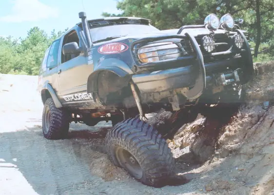

Climbs pretty good too!!!

Did you swap the knuckles or are you running 6-on-5.5 on the front?
no.. still running 2 different lug patterns, need to get adaptors for the rear soon, really tired of luggin 2 full size 35" spares around in the back of the truck, gets to be a bit too top heavy.
