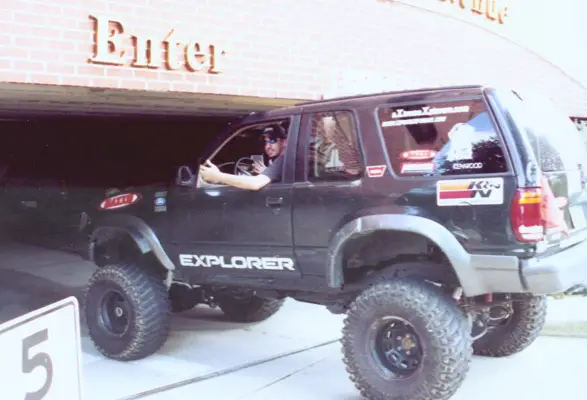

Something else to consider when doing a SAS....this garage has 6'11" clearance :eek:
(Who? Me? Have too much time on my hands? Now why would I suggest something like driving a huge explorer into a parking garage?! :D )

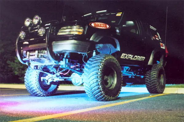

Check out Chris's bling bling blue neons :D :D :D

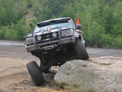

She flexs pretty good!!!
