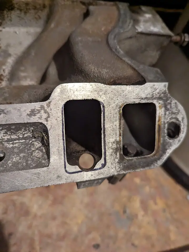

While I'm thinking ahead, is there any benefit to porting the lower intake manifold for a 302 with stock GT40P heads, stock cam, and stock 65mm TB/intake elbow/upper intake inlet? Seems like now would be the best time to do a little gasket matching, but that's also a lot of work if it's not something that'll make much difference. I'm going to be running headers regardless.
Gasket matching is always a good idea
The gt40 intakes respond very well to mild porting there is lots of info on where to port and why
There aren't many well known intake porters that do the GT40 intakes well, and kind of feasible. T Moss and his son are the best known, they do good work and the costs are fair. You may find a ported lower intake ready to go with some hunting, he has done a ton of them. I'd like the suggest the other Facebook guy, Big Dog's, but he seems to do lots of full hogging out port work, I'm not sure how much mild porting he does. For a mild combo, you don't need a full effort job on the intake alone, and it can get very expensive if you do more and more, plus max effort etc.
I'm planning to do it myself and keep it very mild. Just cleaning up some casting mismatch and smoothing out the transition to the head. It won't be a full gasket match, just a touch in the right direction.

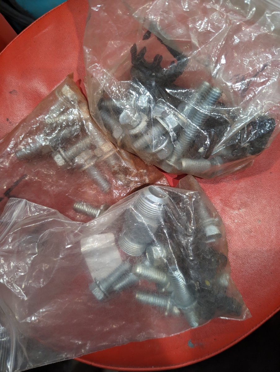

Threw the new water pump on tonight with my re-plated hardware
Still seems odd to me that you can't get these pulleys anymore, but there's not much of a groove in this one, so I'm running it as-is.
Hopefully tomorrow's salvage yard run is fruitful (lower intake hardware) and I can find all the resurfacing and porting supplies I need.
Got my exhaust bolts blasted and plated today too
