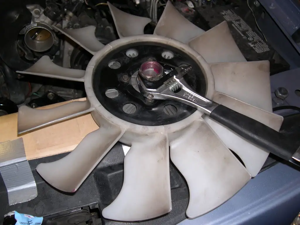

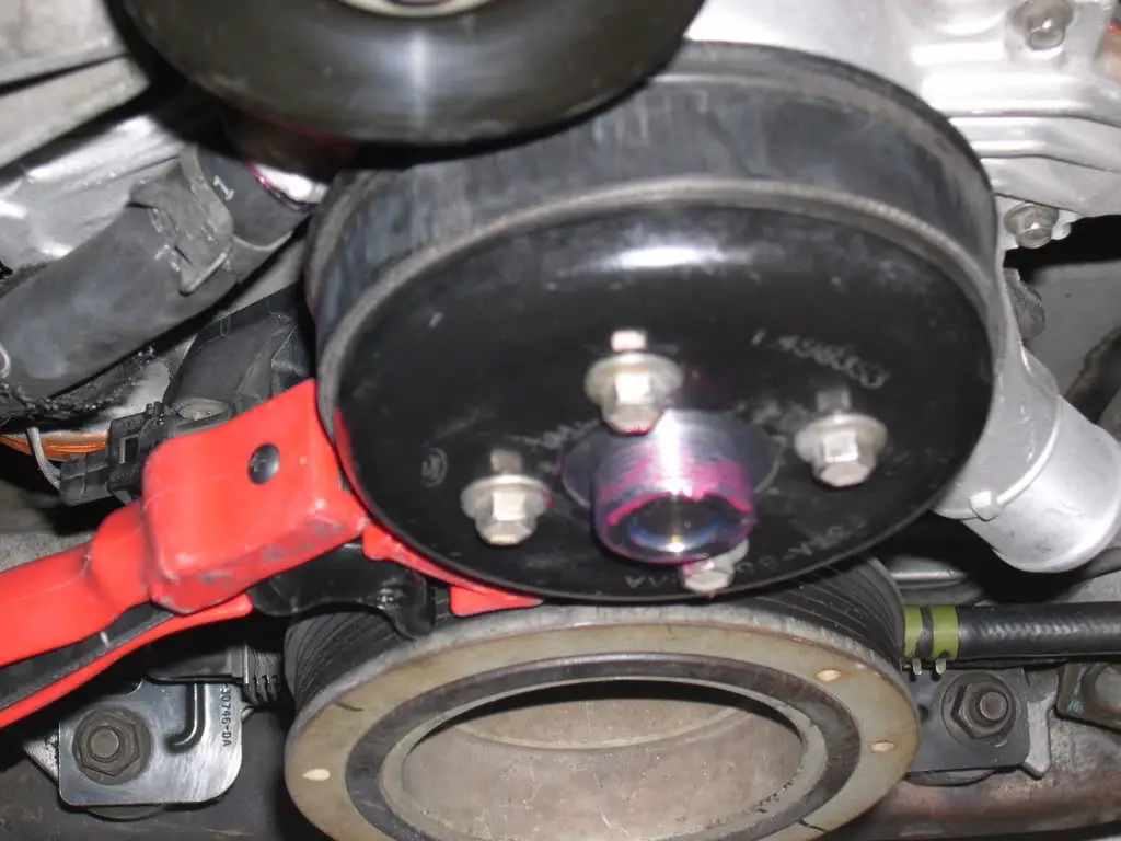

Well guys I’ve been having a problem with my X running hot threw these summer months. Temp gauge goes 3/4 to the H sometimes more depending on how hot it is outside. I blast the heat gauge goes back down. I’ve check coolant level it’s always full. Changed thermostat 3X made sure that all 3 work in boiling water. Replaced radiator cap. Done 2 flushes and inspected all my hoses. Did head gasket test twice I’m good there no sign of leak. Did pressure test holds 16lb no leaks. So I decided to replace radiator bottom 2” is all crushed at bottom. fan shroud as well since that was slight broken had about a 1” gap in between. While inspecting the fan I noticed cracks all in it so I was going to put a new one on while the radiator is out giving me more work space. I’m stuck however trying to get the fan clutch nut off the water pump. I bought the tool it was junk and rounded right out. Been trying with an adjustable and a puller holder just seams like it’s stuck on. My last attempt is going to drill a hole in the pulley wheel and sticking a screw drive in and use that as my holder so I can get all my weight behind the wrench. If you guys know any other tricks please chime in. I really don’t want to drill the hole but I don’t see any other option at this time. It’s going to rain the next 2 days so she’s stuck in the driveway for now.
