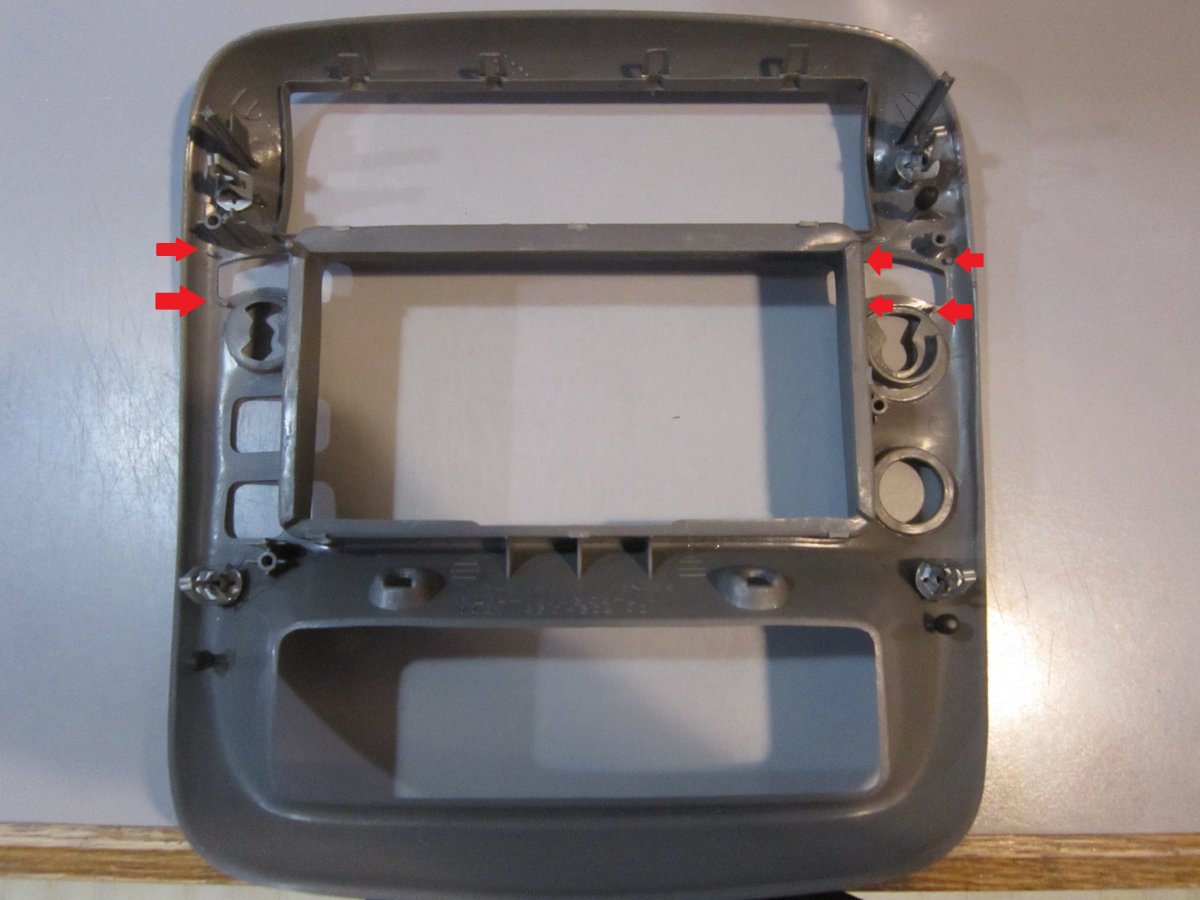

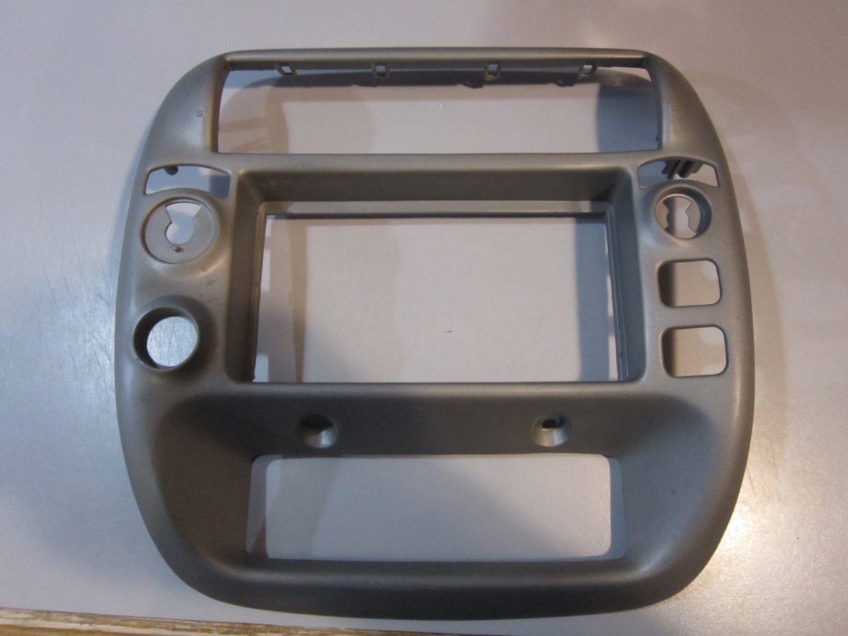

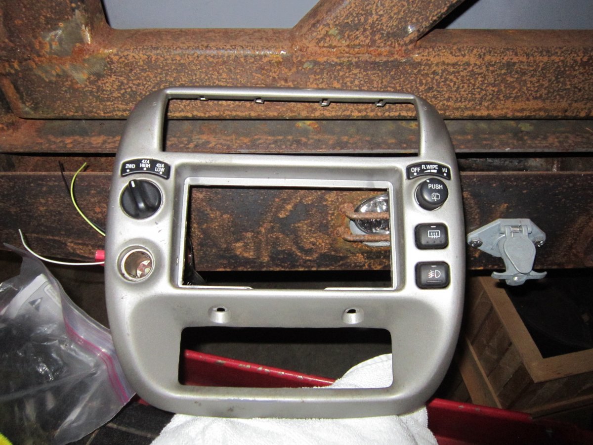

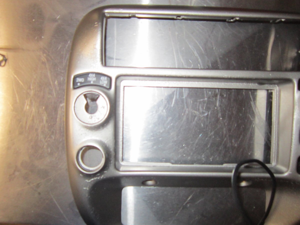

I took apart the center instrument bezel that I bought not long ago...

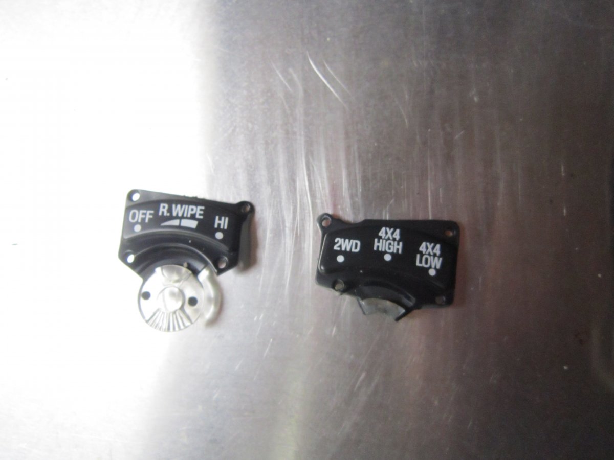

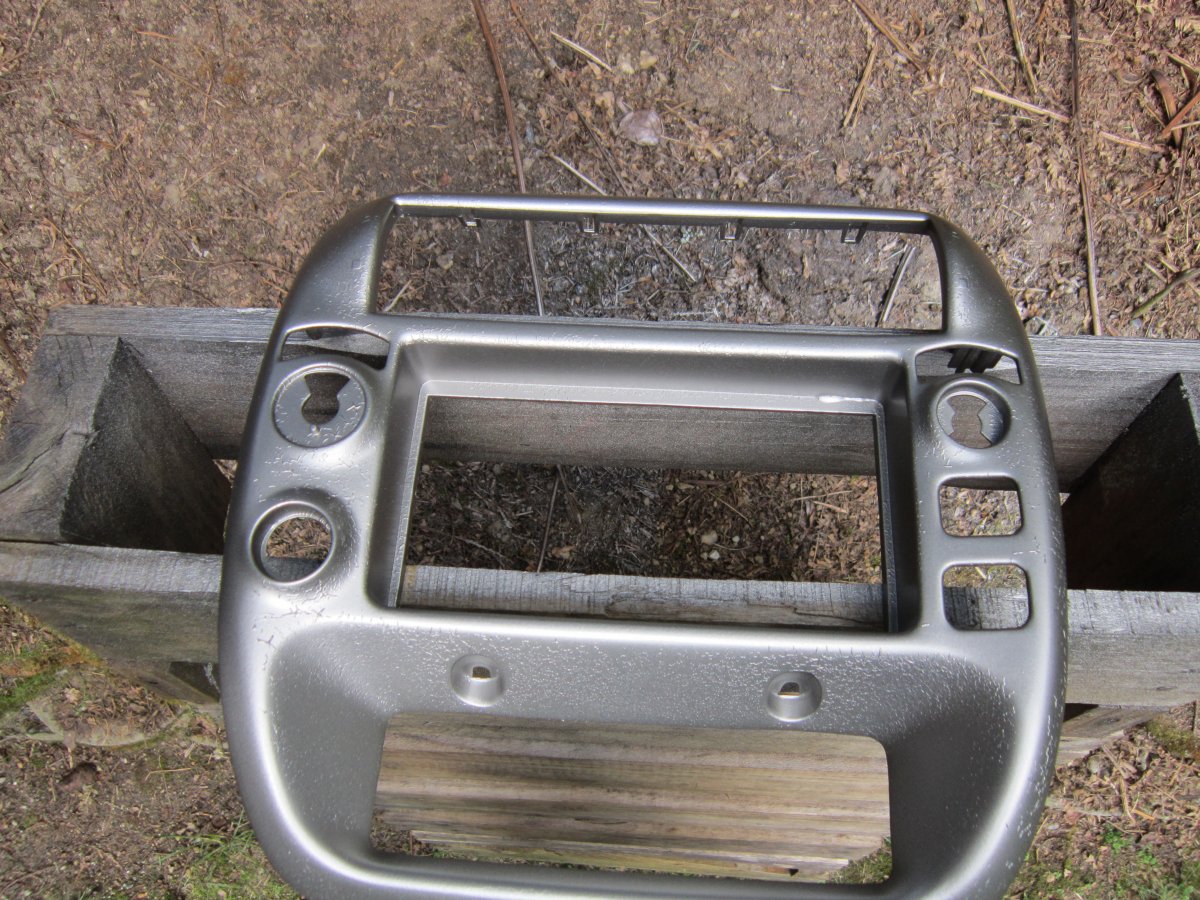

I used a small drill bit, 1/8" I think to remove the melted plastic stud cap that hold the 4x4 and rear wiper indicators in place. 4 studs on each one.
The rear wiper will be changed out with the back window that belongs there. When I'm ready to set them back into place I'll drop hot plastic back on top of the studs.

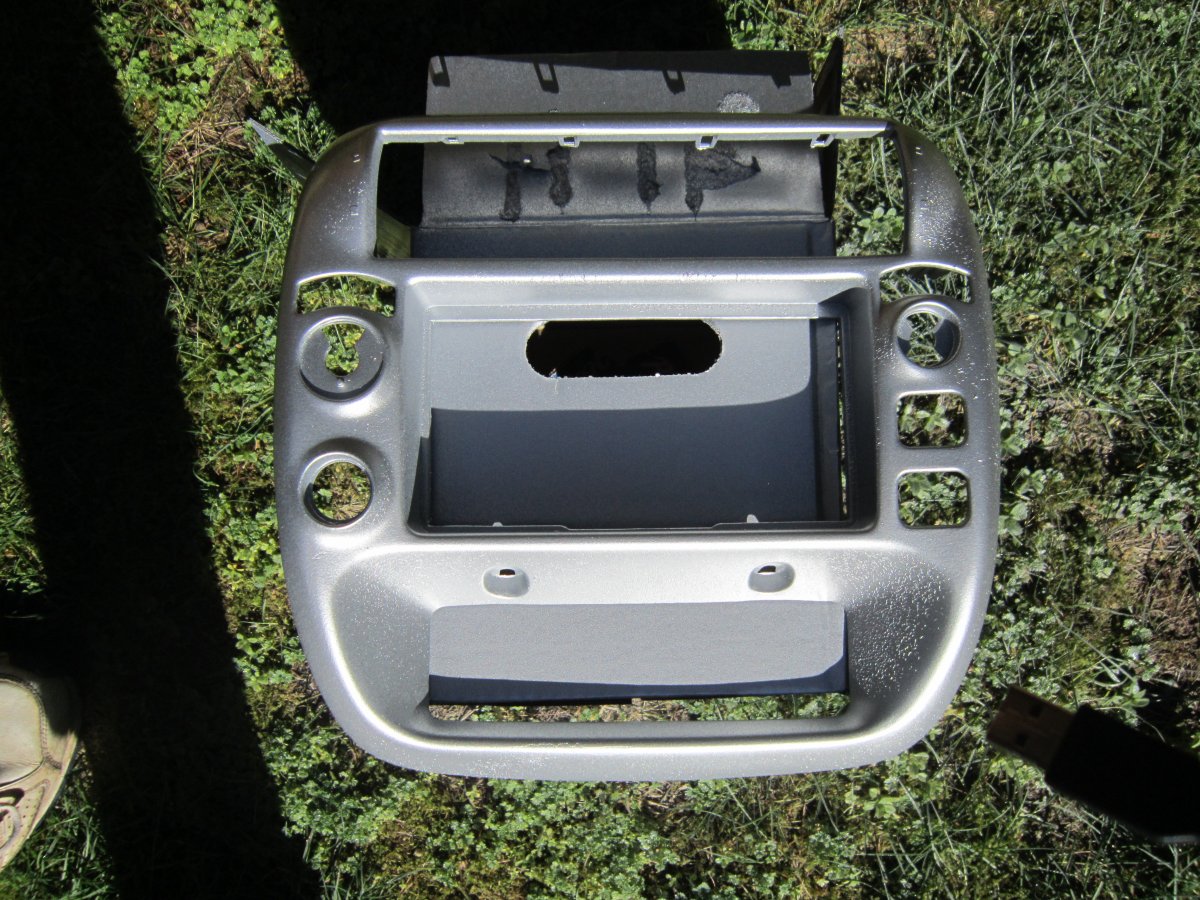

Played with 2 colors, unfortunately each time the sun disappeared and cooled the plastic too fast and I got cracks in paint. :rolleyes: So, I will repaint it again. 1st color was aluminum... it was really shiny and I think it would be too bright against the dark gray interior.
and then stainless steel which I think looks better, but I'll know more when I install it when I'm done.

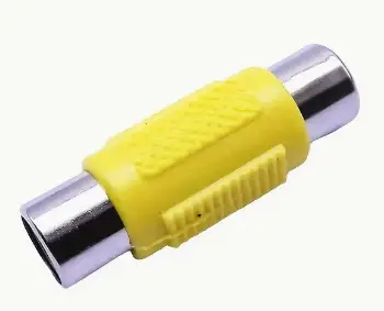

I'm anxious to see what the wiring looks like for the camera. It looks like a typical video line, so I'm planning on buying a RCA female to female connector and using it at the bed to tailgate gap so I can still remove the tailgate if needed. I'm sure I have a couple of 6' yellow video cables from old VCRs. 🤔 My luck though I probably threw them out during last year's garage cleaning. 😞

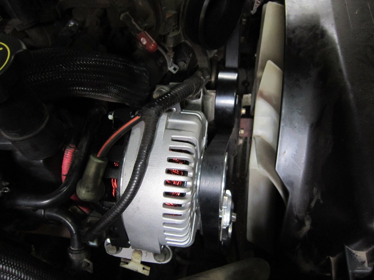

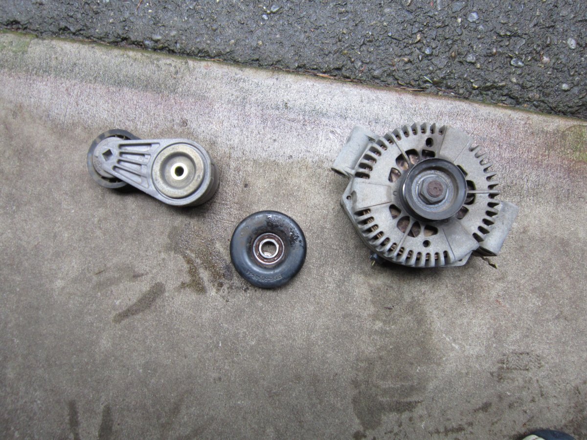

Had a needed repair 2 weeks ago that I completed today. Alternator bearing took a dive after I washed the truck. Ordered the parts from Rockauto and waited for them to arrive. Alt, tensioner, idler pulley, and belt. Due to the age I felt it easier to replace them all. Good choice as the idler bearing was rough as well and the belt was cracking. I would have done this as soon as the parts came in but work sent me overseas for the week. I also replaced the gas cap leash and washed the truck again since pollen loves the fall this time of year.
Tools - 1/4" socket for 3 screws on cover. Flat tip screwdriver or 5/16" socket for intake tube from MAF to t-body. 10mm socket for power cable to top of alt and flat tip to release clip for other alt wires, 13mm for 3 alt bolts. 13mm for tensioner bolt. 15mm for idler bolt. 3/8" breaker bar to release tension on tensioner to remove belt.
Took a video of the alt spinning but background noise was louder than the bearing. Otherwise, the alt was charging fine but the days were numbered.

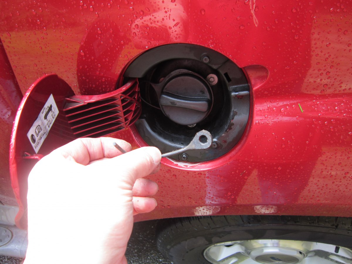

To replace the plastic leash (or whatever it's called) I used 2 flat tip screwdrivers and pried them around the ring. It popped on the gas cap pretty easily. The ring/gas cap was from an Escape.

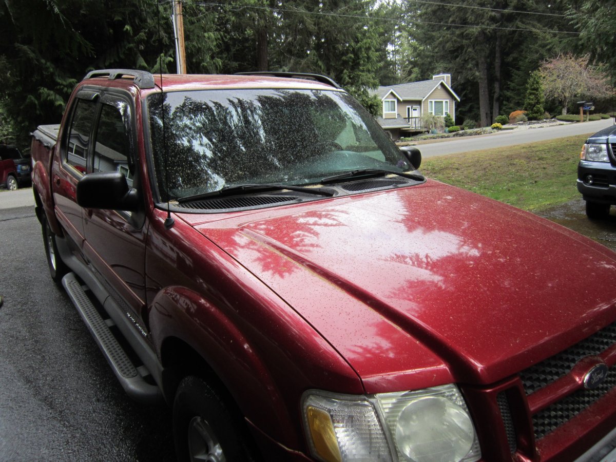

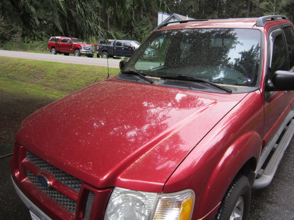

Sorry no pics of the clean truck. Started sprinkling and wanted to get the alt replaced so I didn't have to take wife's car to work tomorrow. The hood and windshield is all pollen. Top of ST was yellow.

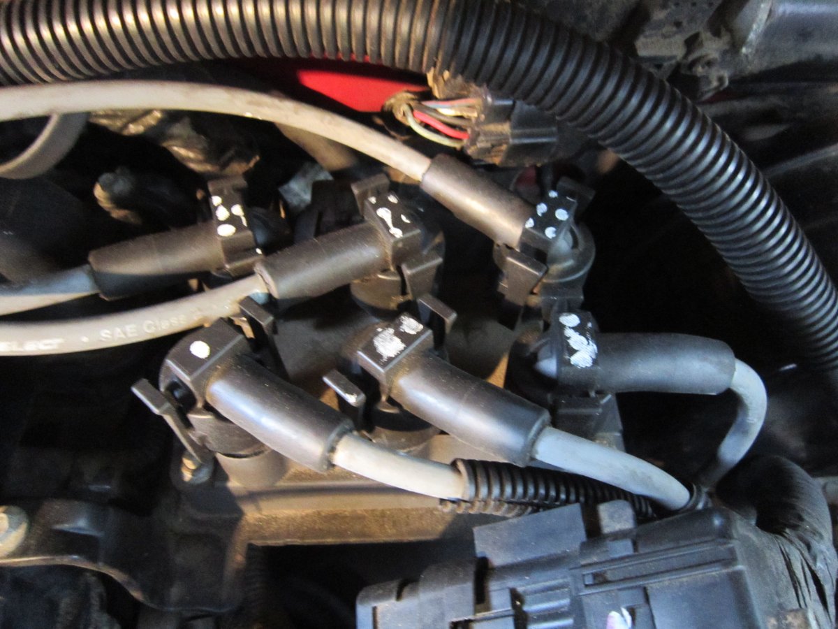

Went and ran a few errands this morning. Sitting at a stop light and the engine started running rough. Felt like a misfire. CEL was flashing, so I limped it home about 4 miles. Stepped out of the truck and had a burned rubber smell. Grabbed the scanner and checked the codes. P0303, misfire on #3 cylinder. Popped the hood looked to see if I could find the source of the smell real quick didn't notice where but I saw a quick flume of steam/smoke/something come from the passenger side. Didn't find anything else. Went to driver's side of engine and checked middle cylinder, thinking it was #3 and the plug wire felt loose like the connector was not on the plug, tried to put it on. Looked at the wires, looked like a no name brand, not typical factory black, at least that's what color they are on the wife's Explorer. Checked all the wires and some areas looked rubbed away from where they were lying/pressed up against.
I was planning on doing a tune-up so I bit the bullet and bought plugs, wires, coil, and filters (air and fuel).
Did a quick search online and found the #3 was the back right/passenger of the engine and how the coil wires were.
2002 Ford Explorer XLT firing order. | Ford Explorer Forums - Serious  Explorations
Took some photos and noted the previous person who work on the ST marked the wires wrong on the coil. The wires are 7mm, I've always preferred 8mm wires. Autolite plugs also preferred.

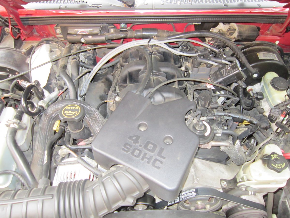

I did notice and think it's odd how the upper radiator hose loops around the oil filler neck. There is a hose clamp on the heater hose that I though would rub a hole in the hose. Is this the normal routing of the upper rad hose?
Yes normal routing for that upper radiator hose just like on my 01 ST 👍💯
From your picture that brake fluid in the master cylinder reservoir looks awfully dark time for a fluid flush.

Did the spark plugs and plug wires for the P0303. It's a PITA doing the plugs from the top. I actually got fed up and jacked up the front end and pulled the tires and the plugs were a ton easier to access. #3 was still a little testy but all was well.
The old plugs were gapped from .027 to .033, FSM states .061 to .067. Gapped them at .064. Truck did fire right up but truck started idling rough. The plug wires I got, which I thought were really good and direct replacements, not one of them snapped on to the plugs, really kind of pissed me off. I tried pinching them closed a little, didn't work. Apparently, there wasn't an inner clip on any of them. I would highly not recommend these ones. I now am getting a P0301, P0303, P0304, and P0305. SMH. Amazon is not showing the wires anymore and I tossed the box. There were 8mm and red.
