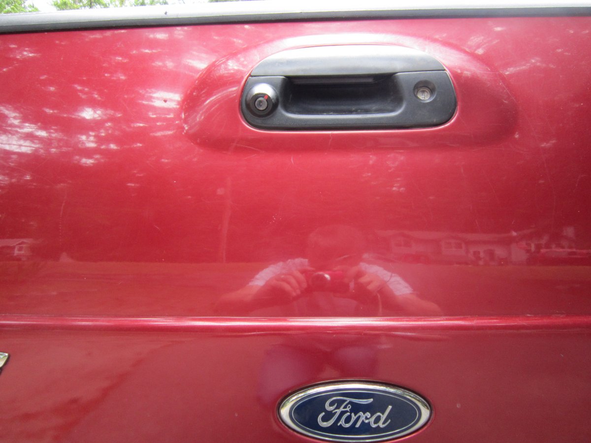

So, I had a little of "me time" and worked on the ST. I decided to start something quick and easy, so I started the tailgate handle swap. Total time approximately 30-45 minutes.
Before:
Pulled the inside cover, (6) T30 screws and (4) plastic push clips.
This gives access to the handle screws, (2) 11mm nuts, remove the nuts and the handle will be able to be maneuvered out of the tailgate.
The key lock cylinder can be removed by pulling the "c" clip, the cylinder will pop out to the rear of the handle.
The lock cylinder will basically slide right in the new handle, be sure to have cylinder end up flush with the top of the cylinder holder. This will ensure it is properly seated in the "c" clip. You can see below the handle with the "c" clip (the new handle comes with it).

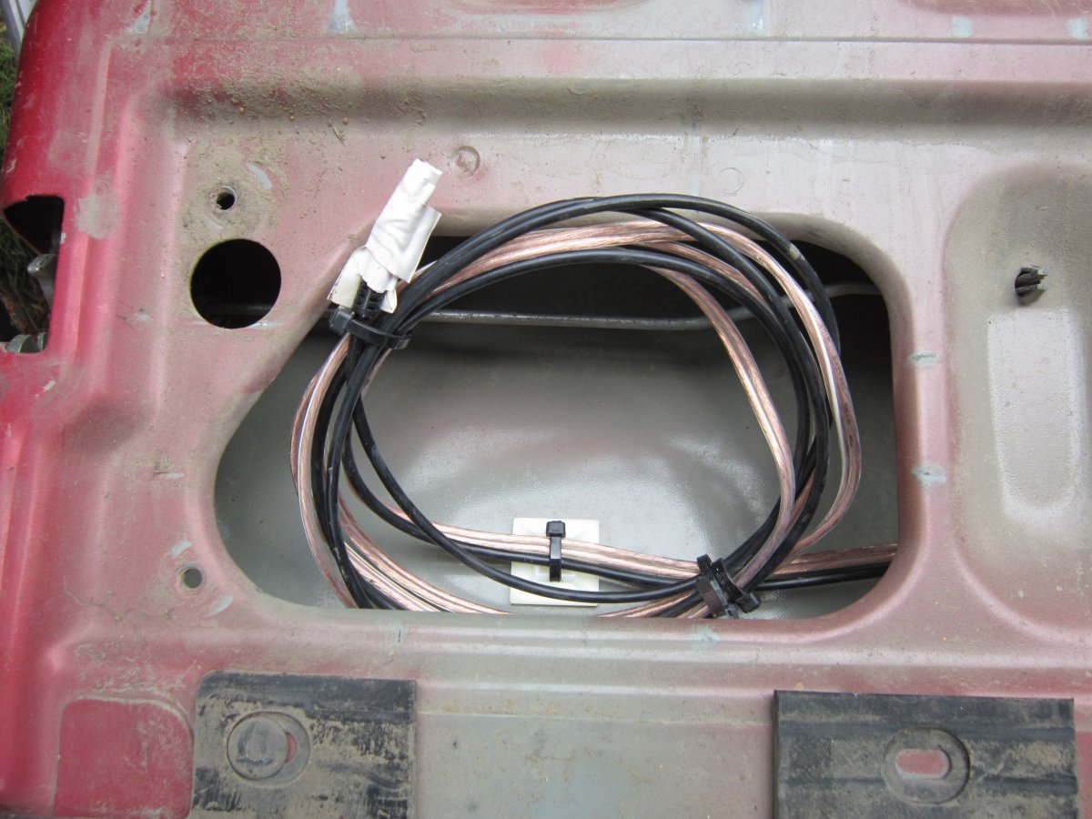

On the inside of the tailgate to hold the wires, I cleaned an area with parts cleaner then with alcohol to be sure no residue was left behind and used cable tie mounts like this below.
I also ran wire for a power door lock actuator for a later install.
The ziptie tail was cut flush with flush cutters, similar to below.
This will cut the ziptie tail flush with end of the lock on the ziptie and remove any chance of slicing your hand/arm open requiring stitches. Then I twisted the ziptie so the end was away from the work area as well. This is only a pet peeve of mine for a cleaner install. But I do recommend it to save your skin...
I installed another cable tie mount closer to the side of the tailgate and coiled the rest of the video and power cable. I covered the end of the video cable so no dust/dirt with electrical tape and left a buddy tab. I really hate trying to peal of tape when it is wrapped flat and you know you're going to be removing it (another pet peeve).
I need to buy a longer 1/2" drill bit to reach the inner plate/panel and install a grommet to protect the wires.
On the bottom of the tailgate will be another 1/2" hole with a solid grommet with a slice to allow the wires to go through. You can see part of the hinge on the bottom of the tailgate (this is just for you locational awareness). I'll remove the tailgate and run a steel coat hanger up through the holes to pull the wires down. Then attach another cable tie mount to ziptie the wires too. I'll probably run them in corrugated tubing to further protect them from the elements. Which will go into a 1/2" hole below the tailgate hinge mount on the bed. (sorry no picture at this time).
New handle installed with camera.
Lower angle looking up.

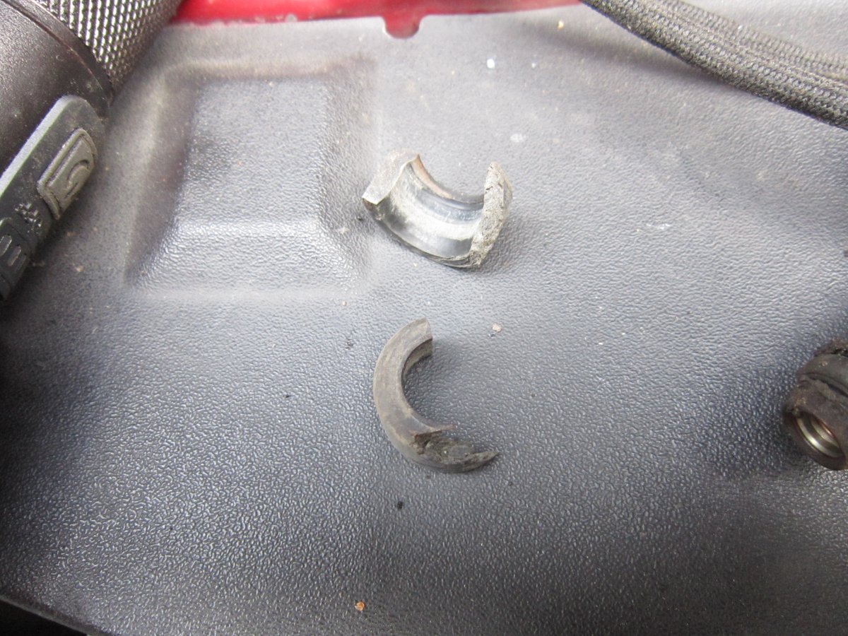

Got to work on the ST again today. The plan was (that's never a good start, LOL) to replace the #3 injector. While I was at it I was going to install the t-stat housing and do both tensioners. I used the link below as a guide, pretty decent step-by-step.
Everything was going well until I found the injector sleeve for #3 was broken, most likely that was the cause of the misfire.
I wasn't real happy to see that. Looked at rockauto they were between $11 and $18 but I needed them today, so I called a couple parts stores and NAPA had them but they would have them until Monday or I could drive to store. Since it was only 30 miles away I went and got them and found out they thought they were gold sleeves at $42. (sigh) Bit the bullet I wanted to finish the truck today. Got home had to watch a video to see how you install them.

P0303 Misfire - broken injector sleeve allowing air into the injector area creating the misfire.
