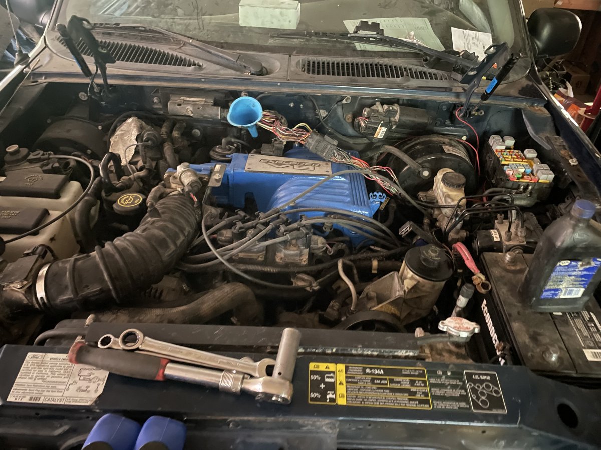

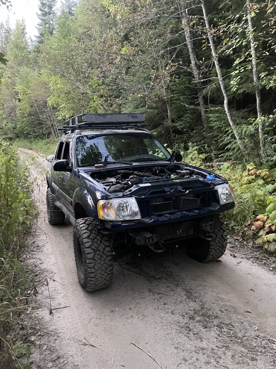

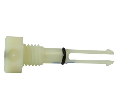

This evening I tore off the intake again... for the 3rd time. Apparently, when I was installing the fuel rail I must have nicked an injector O-ring because I've been smelling fuel while driving. Sure enough, #2 injector was nicked. (sigh) Thinking that earlier in the week I ordered new O-rings for the injectors. I also had extra sleeves. So injectors #1 and #2 received new O-rings and sleeves. Everything went back together nice and smooth. Last time I must have installed the radiator drain plug too tight because the head popped off when I went to loosen it to drain the radiator. I used a stubby flathead and was able to loosen to drain and re-tighten to fill. Found a new one on amazon with a Ford part number. When I do an upcoming radiator flush I will swap it out. The new coolant I installed last time is completely brown so that will be done when the next oil change.
Just one of those silly things that manufacturer's do to save money.
