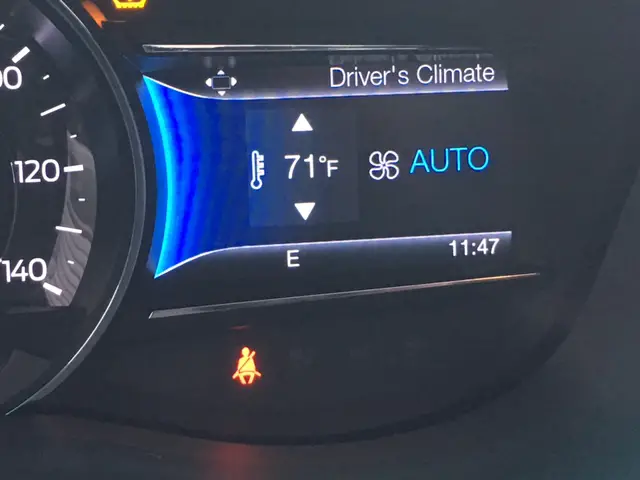

Any pictures of before and after? Don't quite understand what this mod does.
jmr061
August 24, 2014
1,881
135
Wisconsin
16 Edge
Pr-16 Exp Sport
After pics only. Sorry had some issues posting from the phone.
Before would be no climate control.

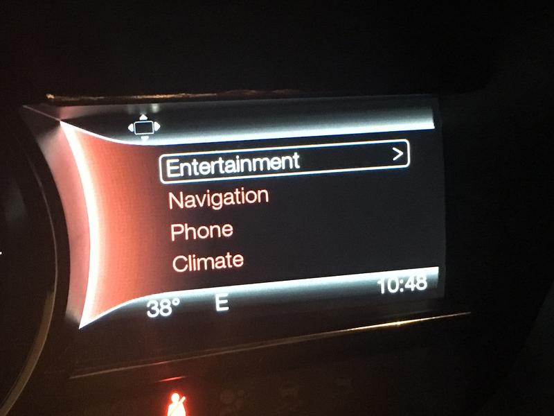

Today I realized there was something else missing....the temp display
Added that...
