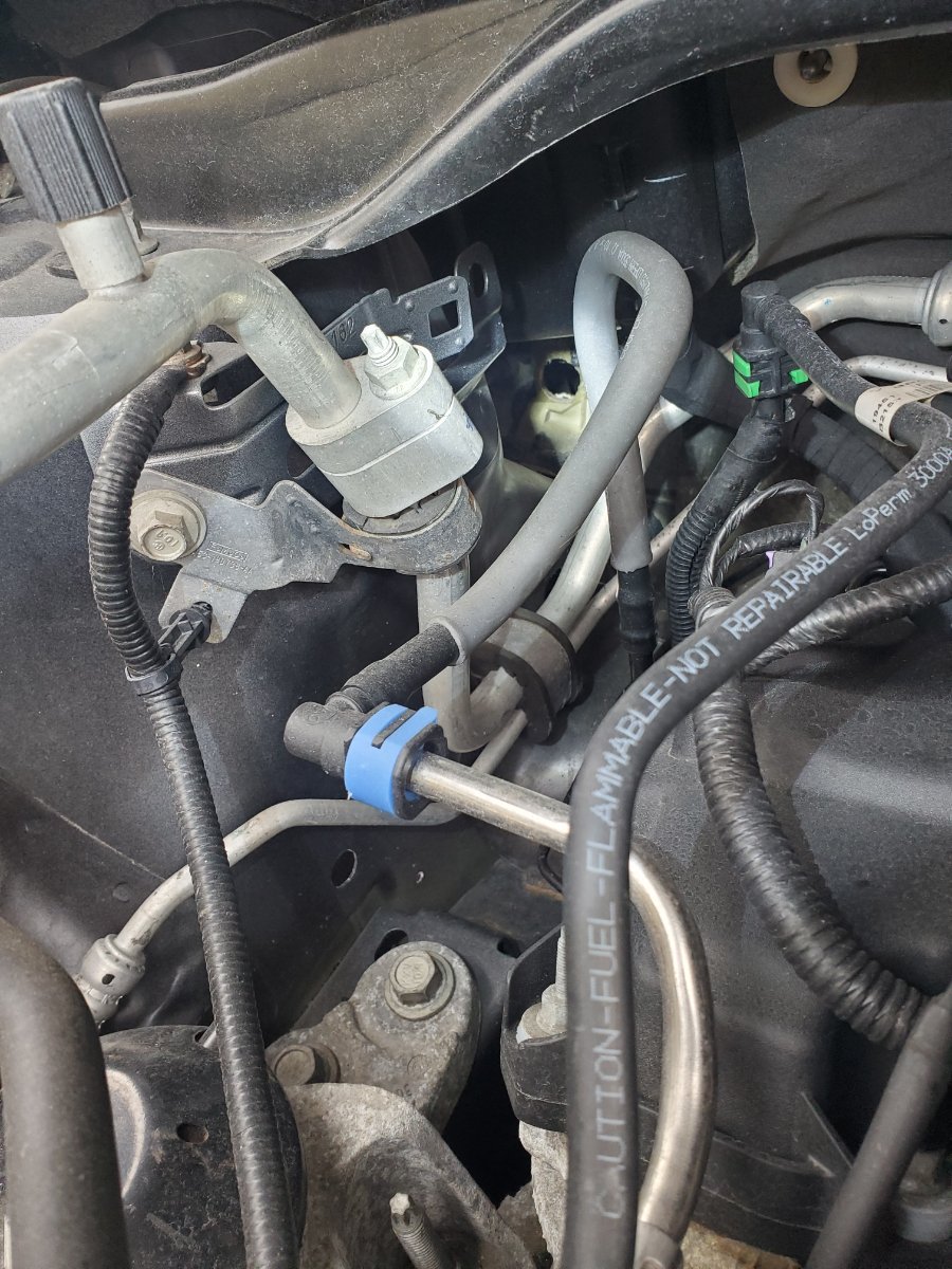

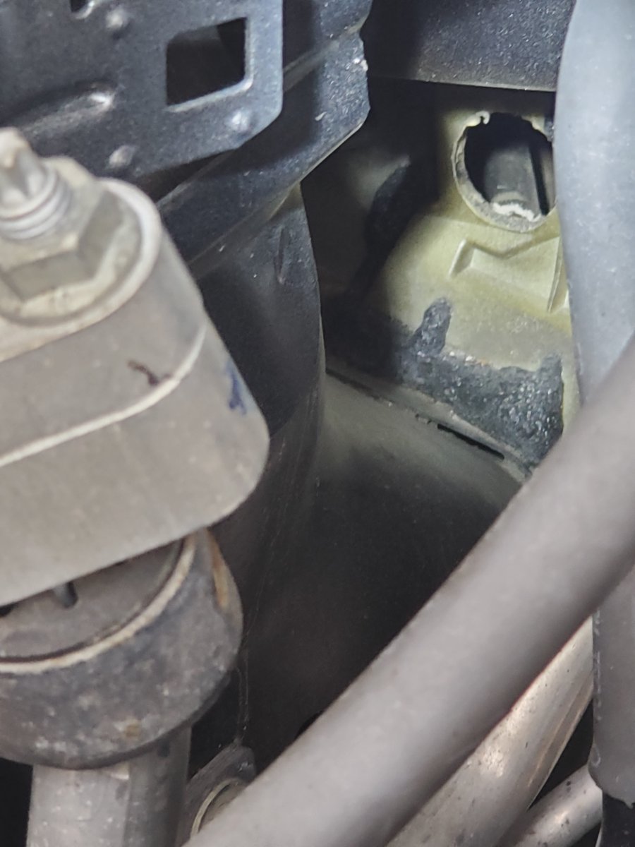

I do believe I discovered the entry point for my squatters. I was under the hood and the sun gave me a look in the dark corner behind the glovebox. look in the corner behind the A/C lines in the first pic, where the firewall color changes from black to that goldish color
I would guess it's at least 2 inches around, and it looks like there is a bit of something caught on the edge of the hole. Bedding material? I slapped some duct tape over it and will find a long-term solution this weekend.
View attachment 461032View attachment 461033
I'm hoping that hole is the primary way in. I have traps set under the seats, but right now their spending their time in the headliner. If I sealed up their only exit, then they will find the traps sooner or later. Mmmmm.... peanut butter.
UPDATE: I have confirmed that hole is the point of entry. During my frozen fuel issue, I went over every bit of wiring and saw the foil tape covering the hole was peeled to one side and dragged in thru the hole. I added two more traps right under that hole on the passenger's mat under the glove box. I've gotten four so far. I need a warm-ish day and no mud puddles so I can lay down under there and close that hole up for good.

I pulled my glovebox door to get at the cabin air filter and see if I can see where that hole is from the engine compartment. Air filter was the original from 2016, it was caked with dust and debris, but no mouse droppings thankfully.
I was able to get under the dash yesterday and found the hole easily from the light coming through. I found a large blob of putty someone had used to block the hole, that was pushed out by the rodents. I pushed the putty plug back into the hole (it also pushed the foil tape back in place from the inside) and used some gorilla tape to keep it in place. No mice in three days; I am going to give it another four before I declare this a win.
...putty someone had used to block the hole...
Have you figured out what the hole was put there for? I've looked in my '16 a couple of times, and couldn't find a hole like that. Even after pulling the cowl drain, dumping its leaves, and putting it back. I changed my cabin filter (also factory), but never felt like I could see the firewall, so I didn't look from inside.
I think it was for some of the equipment mounted on the dash. There are holes the same diameter through the plastic tray that is a speaker cover in the civilian models. I can see where the vinyl mat was cut away in the passenger footwell right corner up under the dash.
I had to pull the vinyl flooring back to uncover the hole, but I could see right into the engine compartment. I can see where a piece of the mat was cut out for access. Someone was a bit ham-fisted when they worked on this. I also found some wires that were once cable-tied up to the front valve cover when I did my oil change. Those cable ties slipped and the wires sat on the front cat and melted the ribbed heat cover. It looks like the bundle that goes down to the whelen siren then branches off to the headlights for the wig-wags. Most of those wires were crudely clipped and left hanging. I've cleaned that up when I was searching for the source of it running rough. That was not what I expected. On the bright side, I saw evidence the timing cover has been off, so it was likely to deal with the water pump.
Good to know that it's not a factory hole. 👍
