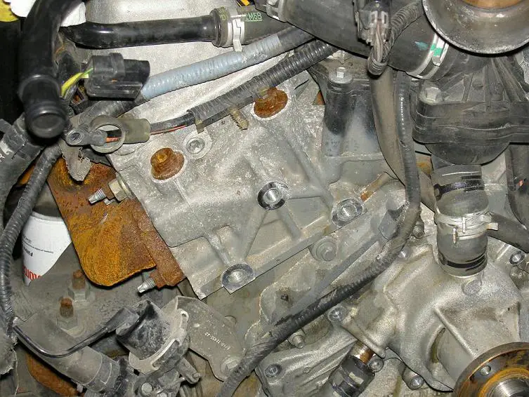

I'm not sure how the 97 may differ from 99, but mine I bought as all new parts from Ford. The path of the water is simple, the heater control valve has one inlet and one outlet, and a mounting bracket that holds it to the engine under the alternator.
