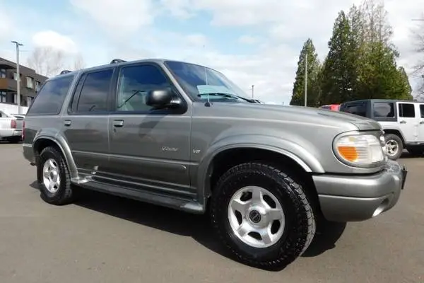

Mazda truck wheels are exact copies (fitment dimensions) as 2gen Explorers.
You can use any of the 1991-2001 Explorer wheels for the 2nd gen Explorers which don't have the larger 12" front rotors(2001 Sport and Sport Trac). The Mustang wheels from 1994-2004 will also work, the offsets are very similar.
The later models have more offset, instead of something around 20-30mm, the next generations use wheels closer to 44mm offset. So that's why some people have used them by installing spacers, about 1" it appears. Avoid spacers if you can, some are sketchy, poorly made, and all of them must be very tightly installed, and checked often.

What other ford rims can you put on 2nd besides the basic second gen rims. Can you put like stang rims or 3rd gen rims. Looking cause it's so much harder to find 15s.
stang rims might be weight rated for suvs and suv tires but when ford put the independent rear they used different front too
so where gen 1 and 2 had different offset look at rim center where lugs are way in the rim. the 3 gen are quite flat in comparison

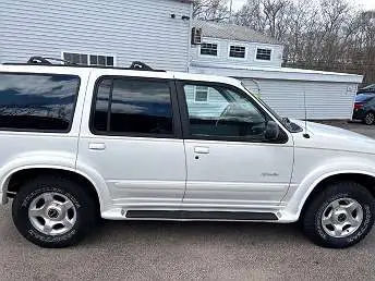

FYI: either Thursday in Greeley, or Saturday in Cheyenne, there was a full set of Limited wheels in one of those yards, like these. Condition appeared good, but that was just a quick glance from ten feet...
Those are just sample pics to see the style...
Those are the style I chose for my mail trucks, I have 13 of them I think.
Those were on my truck original so that would be cool maybe I'll take a look on Monday.
