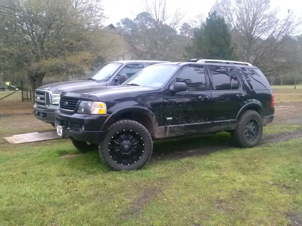

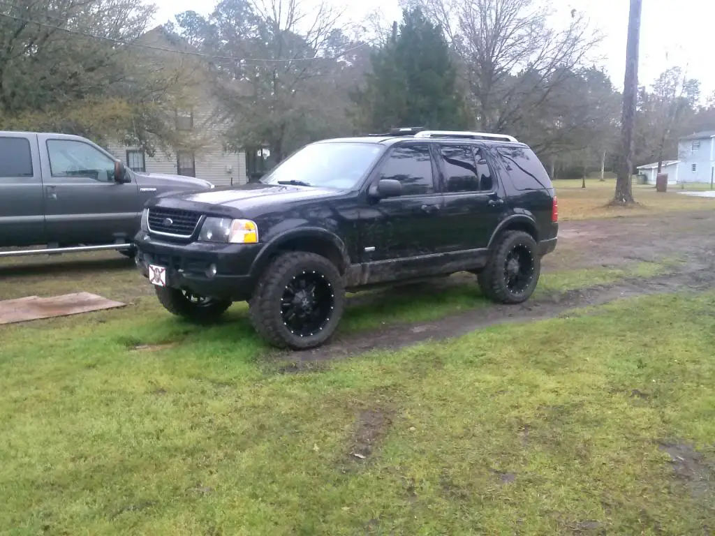

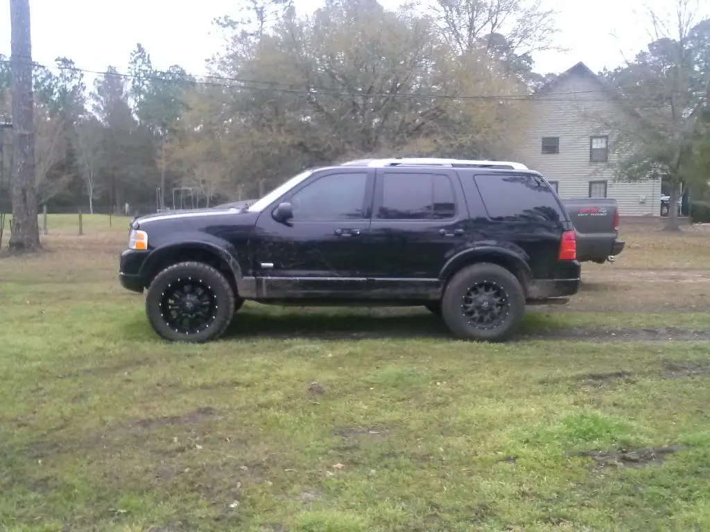

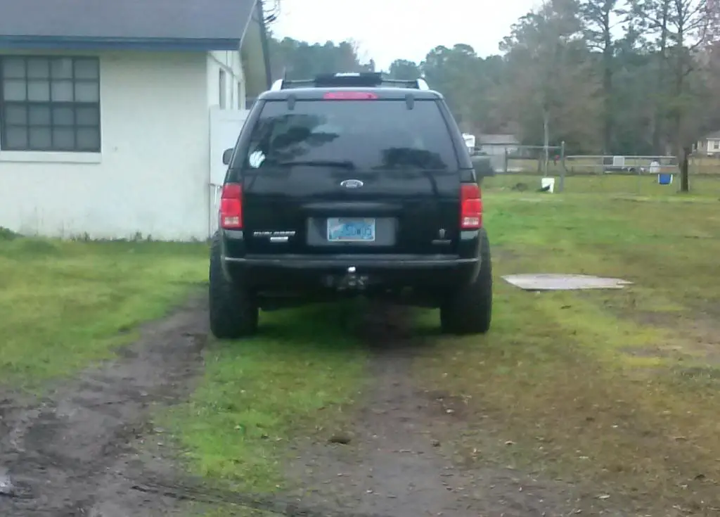

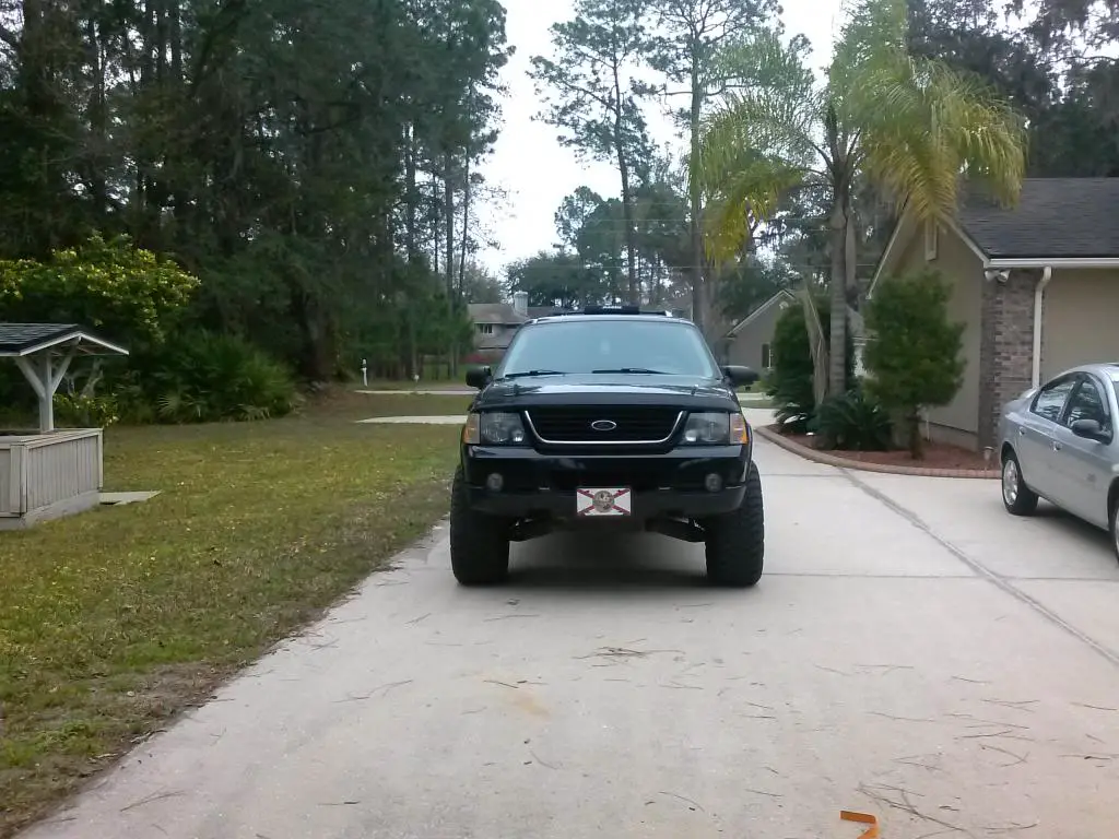

Haha sorry for the wait! If youre buying brand new tires and a set of rims with a width of 9 in. and a -12 os i would go with an 33x11.5 or smaller if you do mind trimming. If you dont it looks like ill have to pull the back of the fender well forward, grind a tad of whatever it is behind it, ziptie the fender well plastics back. On the front of the fender well ill have to zip tie it back a little more and trim a tiny bit off of the inside bottom of the bumper plastics. All of the trimming will be easy and unnoticable unless you get under the truck and look for it. Back tires clear perfect.
