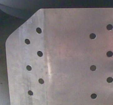

Nice guess. There is a rubber/plastic flap that protects things underneath, but I also wanted something a bit more sturdy - not so much for snow, but rocks (small ones). My cooler already has some bent fins, so hopefully this will help a bit.
Sorry about the poor quality - a 2 MP camera just isn't enough!
The holes are to let airflow through for coolers etc. Each hole was individually drilled - took ages, and i have cuts on 6 of my fingers from the drilling/smoothing process! Pretty happy with the end result though.

what did you make the skid plates out of? how much do they weigh and how did you mount them? they look sick tho just might have to make mine a set. the cooler doesnt like sand too much and they should help out a bit more then the plastic flap thats there
It's 3mm aluminium plate. Size is 600mm long, and 500mm wide. I then tapered the front a bit and drilled each 16mm hole by hand (well, using a power drill - but hand held one, not bench mounted drill press which would have been easier). I haven't weighed it, but I reckon it would be less than 1.5kg (around 3lb).
It's held on by 2 x 4mm high tensile steel bolts that go into the suspension cross member (there are 2 square cutouts under cross member, which makes getting a spanner or socket in nice and easy, so I lined up the bolt position with those cutouts). The front is held on by 2 x 8mm bolts that replace the plastic push in things that hold the little chin spolier onto the front bar, and as you can see, I have the plate wedged between the front bar and the little chin spoiler. The front bar at that point is held to 2 brackets that are part of the frame, so it's quite a good, firm spot.
There's around 12 hours work in that - first thing I did was make a cardbaord template to get all measurements for where I need to bend the plate, drill the mounting holes etc so that it would fit just right.

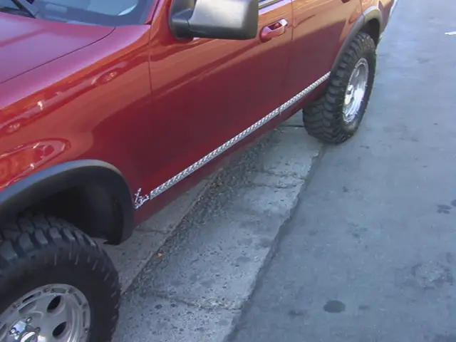

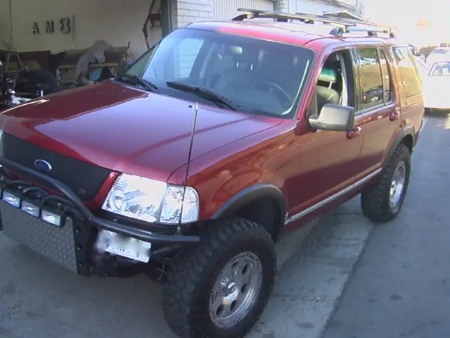

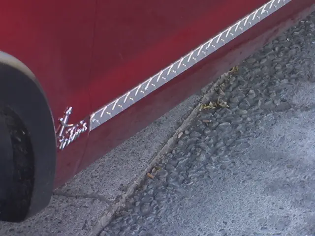

Okay, a little more diamond plate :D:thumbsup: The stuff is fun to add... Just need to paint a few areas... I want that skid plate to be semi-gloss black...

Were you planning to add a body lift at anytime? Just thought about this, but if you do your bumpers would be too low.
I'm going after the skid plate first... the wheels have to stay on the shiny side... maybe that panel on the back hatch that cracks, all diamond plate, nah :)
I did consider it...
I had to drop the idea over the last few days... but that is something I wanted to do for some time now...

Funny you say that - mine is cracked, and I was thinking of using 1mm Aluminium or steel sheet (primed and painted, of course), but black checkerplate would look great, IMO. I love the strips on the doors, but painted to match the fender flares would look better, again, IMO.
