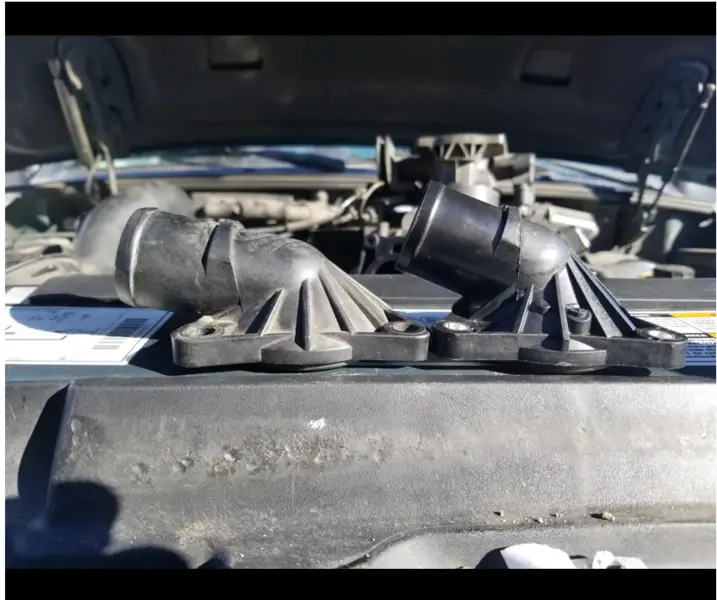

I got a question about the Austek one. I know that the 4.0 L SOHC engine for before 7/24/2000 has a upper radiator hose outlet that is taller/ high angle then the ones, from after 7/24/2000. I bought a plastic one to get me by for awhile on my 2001 explorer sport that was made 9/1/2000, so it has the lower angle upper radiator hose outlet. Does the Austek have the lower angle upper part or the lower angle one?? I want a metal one to replace the 18 dollar one i bought. This photo shows it. On the left is the post 7/24/2000 low angle upper radiator hose outlet. On the right is the pre 7/24/2000 higher angle upper radiator hose outlet.
Thanks,
John

Yes they make one e mail them :)
