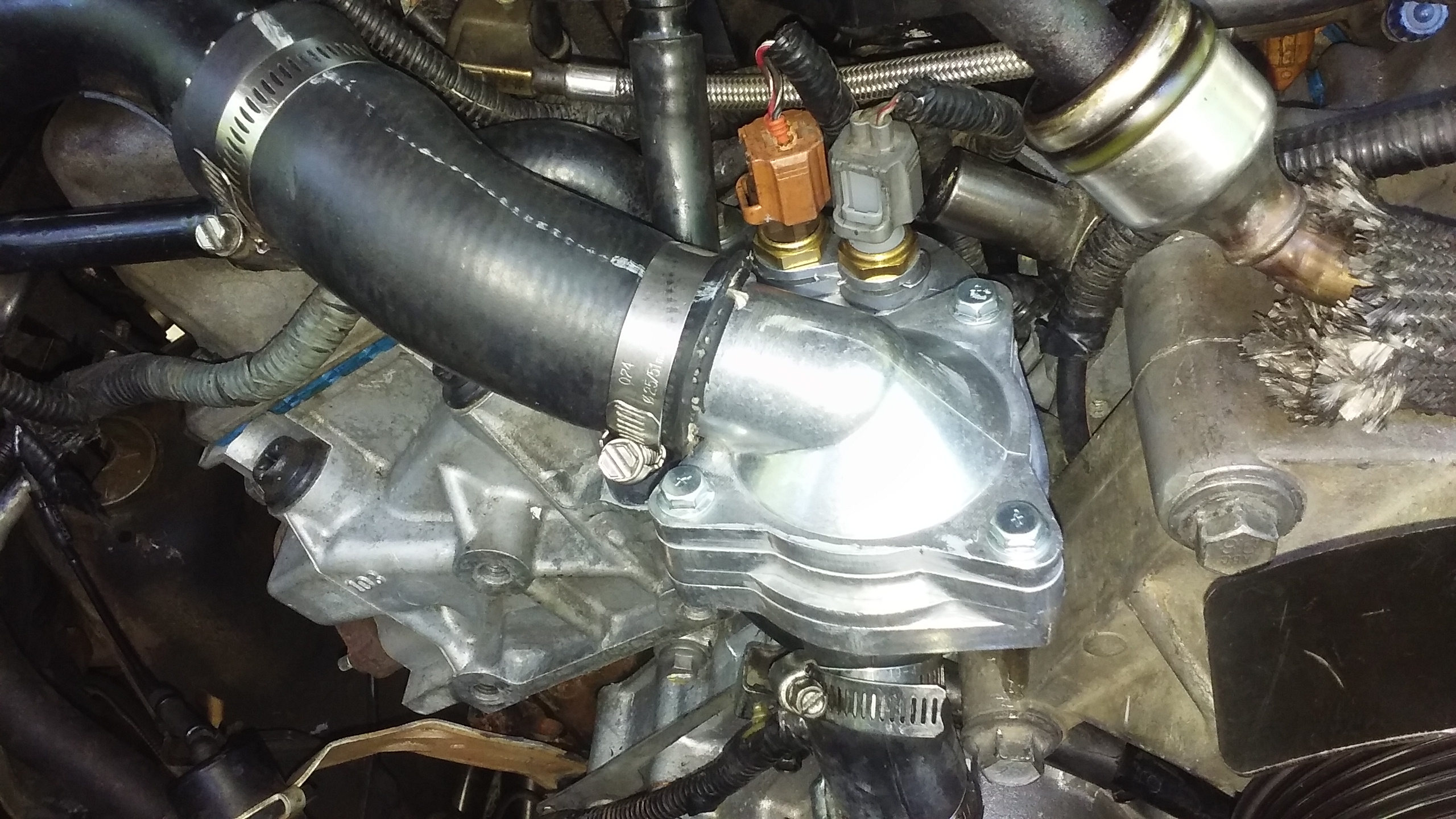

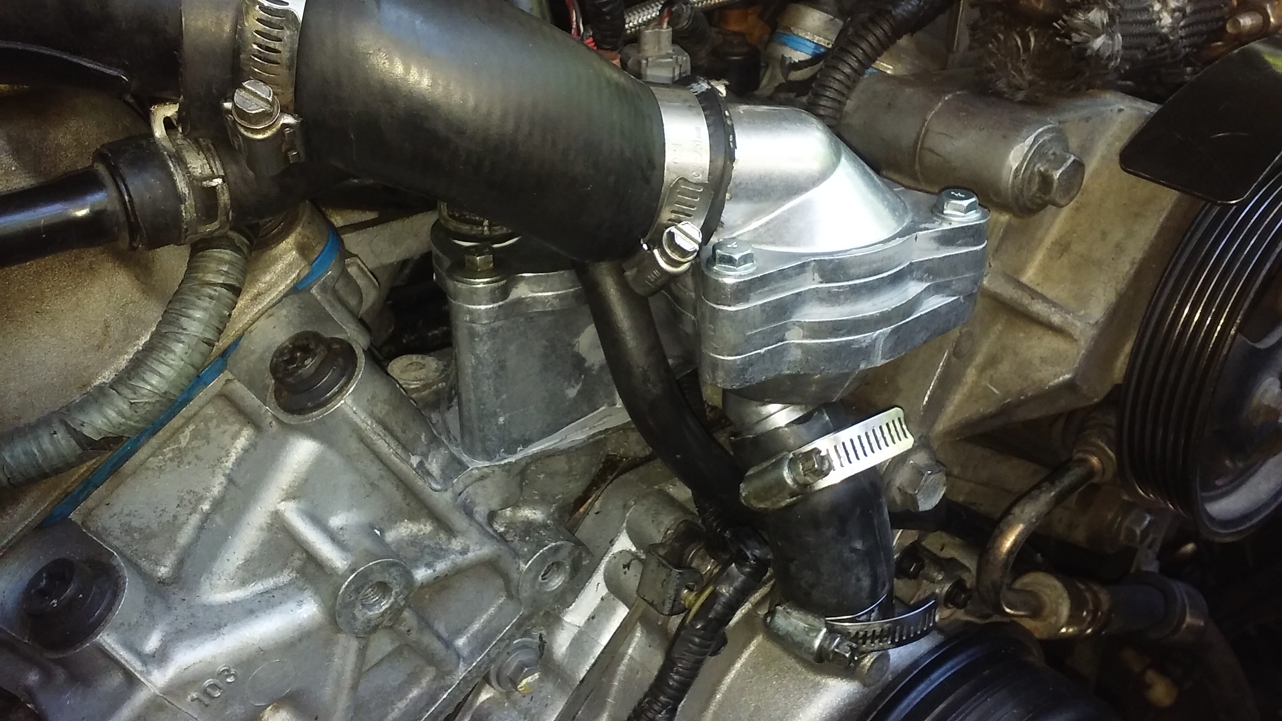

Just thought I'd chime in with my experience in the Ford 4.0 aluminum thermostat housing... for anyone contemplating the aluminum housing swap & what make/version to go with, there's more the 2 options available. I just replaced my thermostat housing assembly for the 3rd time this past weekend, used the aluminum Motorcraft RT-1220 / AL2Z-8575-B on my 2008 XLT 4.0.
After much research fall 2018 & reading all the pros & cons of the Simmons/Austekk models, price, etc I found that there was a Motorcraft version, although discontinued & still available from Ford dealers online & via eBay. The cost varies ($95-$120) more then the Austekk, but is less then the Simmons, plus it comes with a new $22 Motorcraft screw-in temperature sensor, new bolts, new gaskets, all you need is to re-use or new thermostat. I'm quite happy with it so far, obviously it's something that Ford never should have made nylon/plastic to begin with. Replaced the original Motorcraft housing @ 79k miles, made a mistake & bought a Dorman replacement that started leaking in under 2k miles, replaced that with a Motorcraft OEM and that lasted about 30k miles b4 leaks @ the temperature sensor would not stop no matter the sensor, the o-ring, the thread tape... guessing the hole was just warped enough that nothing was going to work.
So now @ 112k miles hopefully this aluminum housing is the last one I need to replace. Reading the QC issues & comments about the other 2 brands being marketed lead me to the Motorcraft RT-1220. Couldn't find anything negative about it online anywhere, so figured had to be the better of the 3 options. Fit & finish was top-notch, no worries about gasket falling out of the bottom when installing, just clean all surfaces good. Only minor issue I had was getting system to "burp" air out, ran heat full blast for 10 mins, not quite hot. Started cold next morning, ran fan high & max heat defrost for 10 mins, felt the hot-hot heat about 3 mins into that cycle. Added a few more ounces of coolant, lightly rinsed off top of engine block & intake. So far no more smell of hot radiator fluid on my intake. Will post an update if the Motorcraft thermostat housing decides to leak down the road...

Thanks for posting about the Motorcraft Aluminum housing and for posting the Part Number.

The only problem with the Motorcraft t-stat housing may be that the piece the upper rad hose goes on may not be the right angle for all sohc's. I believe the Motorcraft unit was designed for the Mustang. it may work with some year sohc's in some model Expl's, but not all. That's one reason I like the Simmons housing, as it's available with several different angled top pieces.
