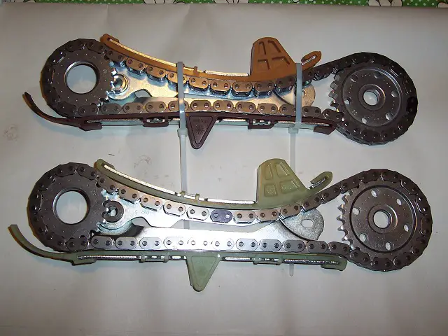

long block
I plan to purchase a long block. But it would be helpful to know if the head casting changed or the block casting. On some year of the 3rd generation and later the opening for the front cassette in the head does not align with the opening in the block. That makes it difficult to extract and install the guide assembly because the pivot bushing will not clear the opening.
Ford eventually replaced the pressed bushing with a circlip bushing allowing the guide to be disassembled for removal/installation with the head in place.
If the change was in the block casting then maybe the cylinder wall thickness also changed. I'm wondering if Ford strengthened the block in 2004 in anticipation of using it in the Mustangs.
