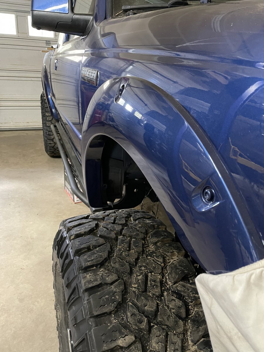

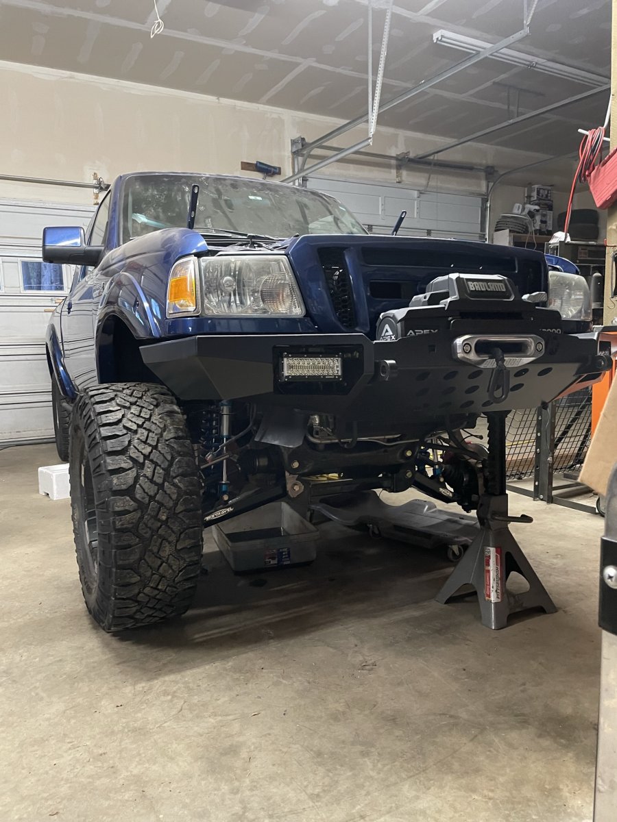

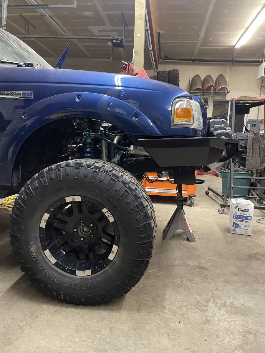

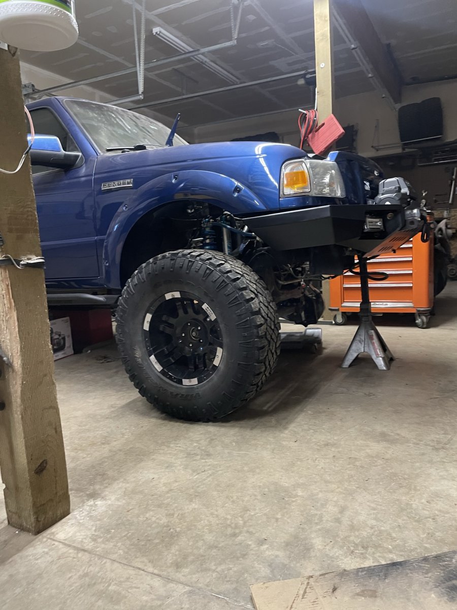

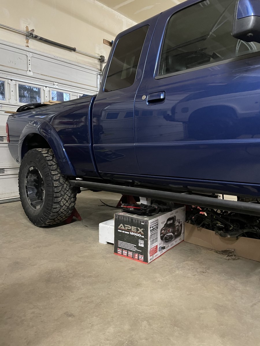

My bronco is in the shop for some spring maintenance after another long winter
So while I had my wheels and tires off we did some test fitting
My wheels are 15 year old moto metal 17x9 with 7 year old Goodyear duratracs, 315 70 17
We built this blue ranger with 35’s in mind.
They fit soooooo well!!
Wheelbase has been extended for sure
I will measure
I will be adding 1” of lift to rear end next (Chevy lift shackles and possible block to adjust final height)
Some trimming would likely be needed in the rear….
If we were keeping the factory flares ;)
Tire coverage will take some deep thought
Wheels and tire shopping is taking place
Sorry truck is a little dusty
I will DRIVE it outside and wash it soon
