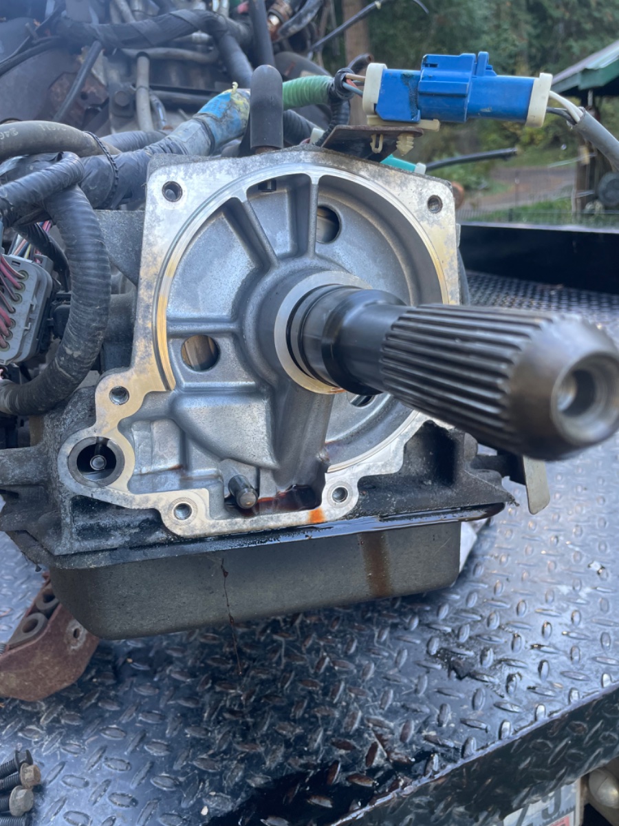

Houston we have a problem
3 Bolt heads Mia
Crazy crazy carnage

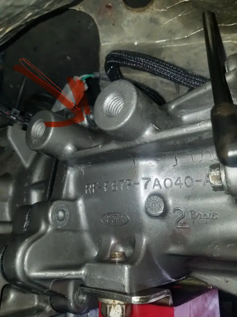

So those are tail housing to transmission bolts? The tail housing and/or transmission case aren't broke?
I don't see how it could have sheered (or sheered) those bolt heads and still be attached to the transmission. Torsional or sheering action would have broken the housing it sheered the bolts at the split. Is something had forced them apart, a tension break popping the heads off, I would also expect damage to the tail housing and them to really be separated.
Possibly defective bolts? Almost hard to believe that three would have ended up in the same transmission right next to each other.

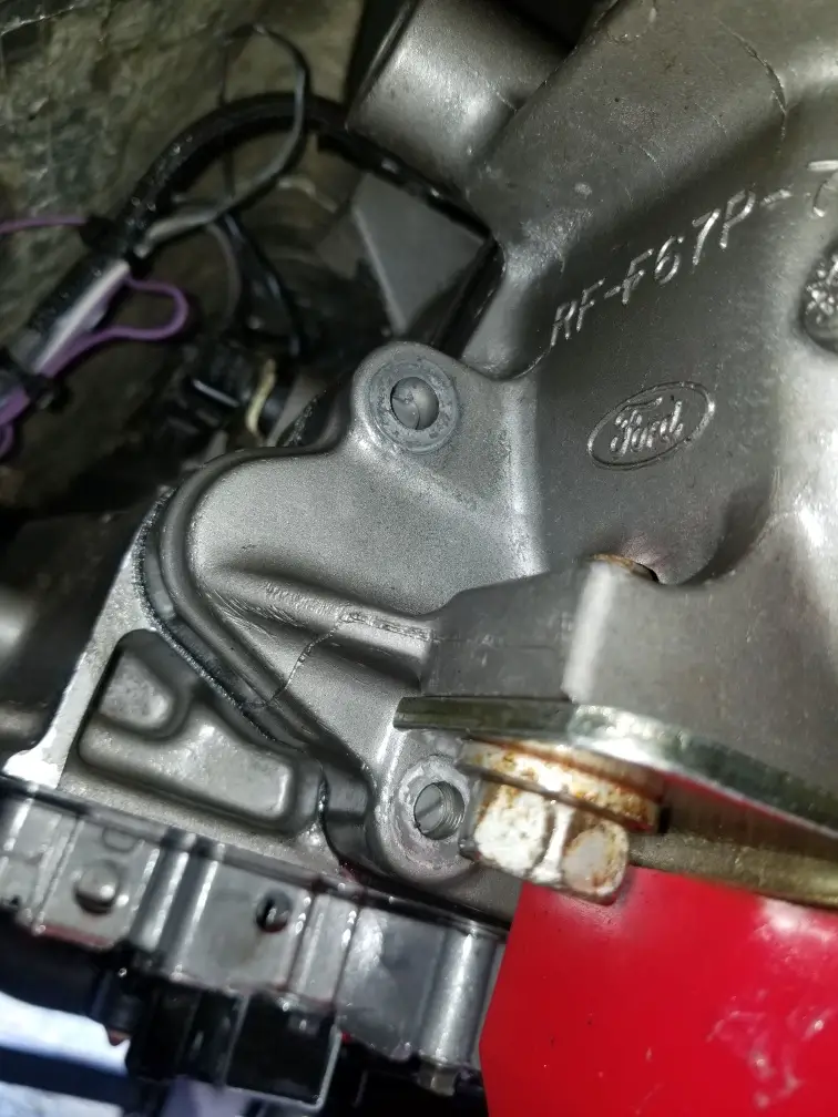

Very hard to tell over video phone but I think there is a crack in the tailhousing as well
Eddie has been doing a fantastic job on his end. Once I saw the leak (fountain) I knew it was not a gasket failure so we went hunting and I spotted the sheered bolts
The th does look cracked around one of the bolts
The three bolts on the passenger side are still in tact
No damage to trans x member or mount
As far as I can see
