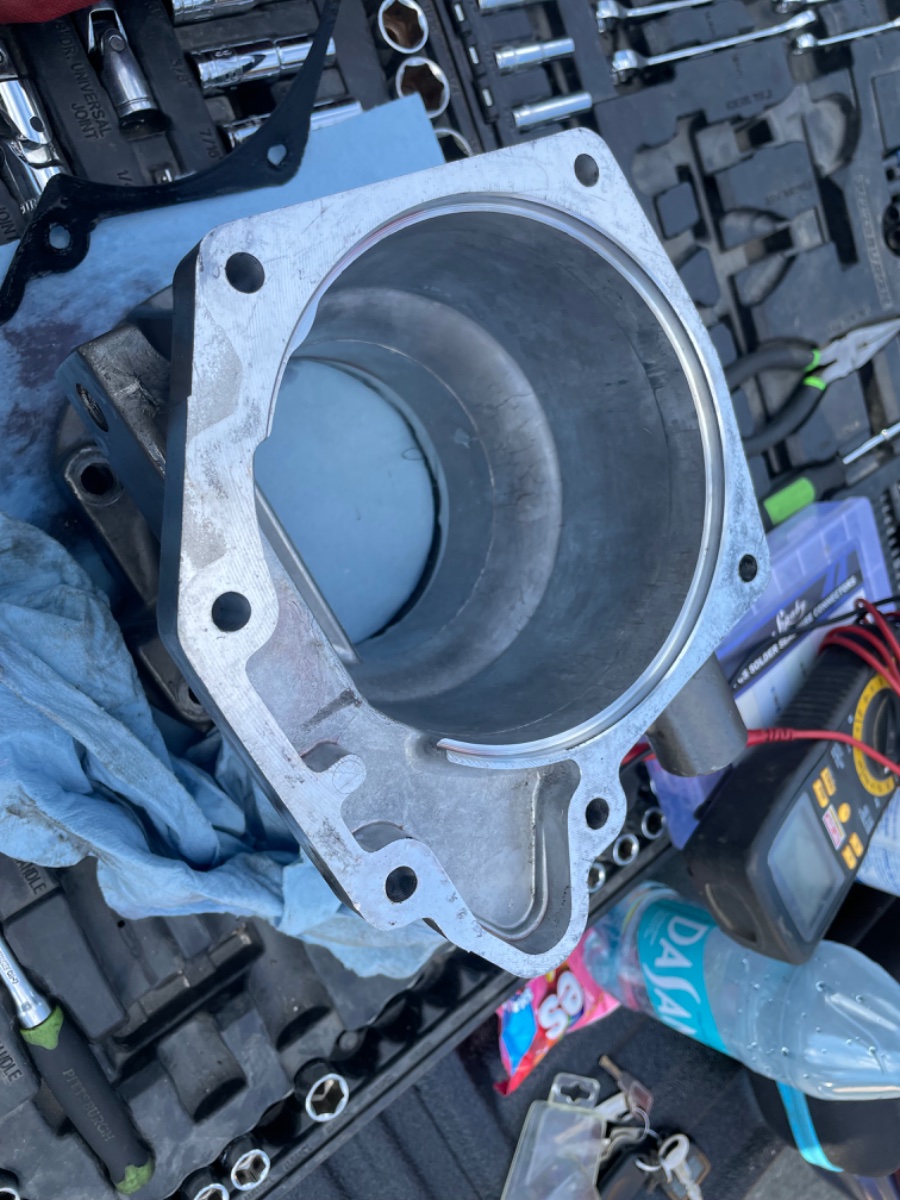

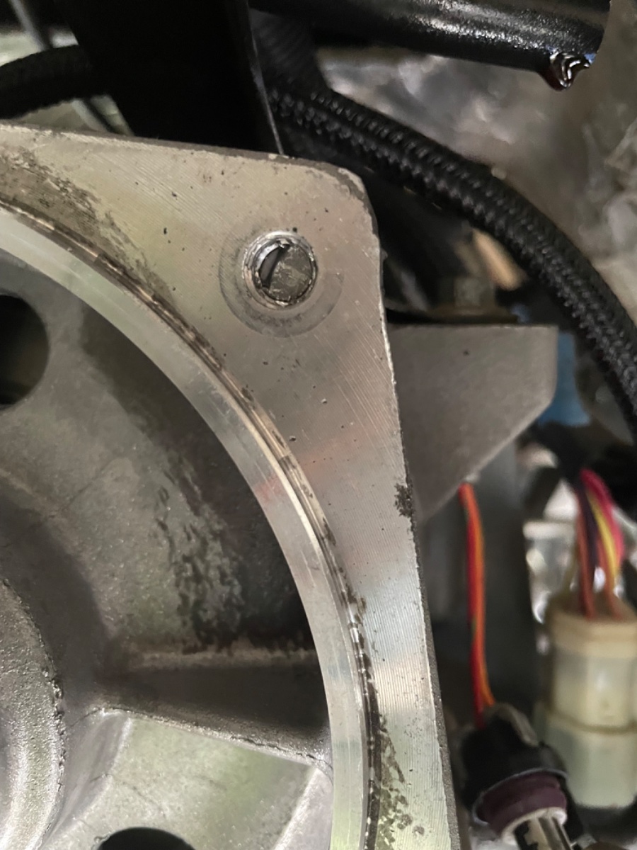

All 6 tailhousing bolts had sheered ALL SIX!
The tailhousing tried to come off with the t case I had to pry them apart to get clearance
I had used rtv on th to t case gasket
Still had to case on the ground very quickly
No damage to old tailhousing
No damage to trans mount, crossmember, transmission case or transfer case

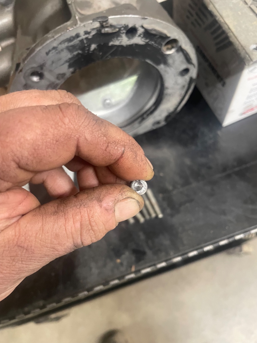

One bolt was broken 1/4” deep. Quickly drilled out the center while Eddie ran to harbor freight in his wicked ass Holden to get extractors
New style easy out worked first try
Cleaned all surfaces
New tailhousing gasket new t case gasket (no rtv, just a dab to hold gasket)
Everything went back together no issue
I used the new tailhousing just to be safe

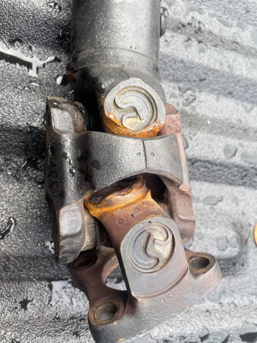

Here is the culprit centering ball welded itself into molten metal cardan joint broken
When I first got under the truck I lifted on the t case and the entire tailhousing wobbled I was like “whoa”
First though how the hell did he make it home
only thing holding tailhousing to trans was the mount and the tailhousing has a lip that rests inside the trans case
Old tailhousing no signs of cracks or anything
One bolt broke inside case was super easy to extract. As Brett pointed out to me, once they are no longer clamping anything they are just threaded in no force
How the heck do you pop 6 bolt heads and no damage to anything else? How the??
Went back together just like new

Tail housing that was on the truck
No visible anything

Have you checked that trans extension with a straight edge, could anything have been on the surface(which I realize should have leaked)? I can't imagine what would break all six of those bolts.

I think when the u joint failed, it locked up and the transfer case took the shock load by twisting enough to break the bolts.

The old tailhousing is straight as the day it came off the assembly line. I installed the new one anyways
