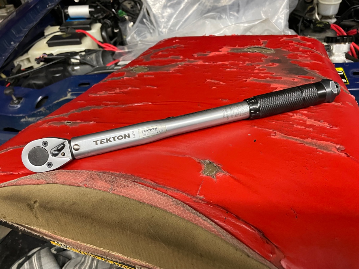

I have the pushrods and rocker arms all re installed, then my torque wrench broke… seriously it broke at 20 ft lbs? What a pile of crap. I have 4 other torque wrenches, 2 huge ones 1/2 drive and 2 tiny 1/4” drive, inch pound ones that do not do 18-24 ft lbs (280 inch lbs)
So this am I am off to get a new torque wrench

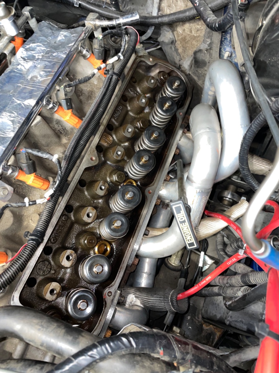

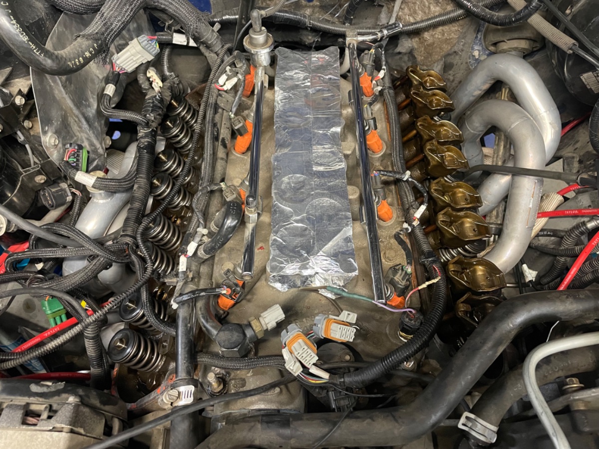

I checked torque/ lifter Preload on a few cylinders. Pedestal Mount rockers so it goes like this:
Bring cyl 1 to the base circle of the cam (both valves closed, damper timing mark points to 0)
Finger tight rocker arm until zero Lash is achieved.
Now with torque wrench bring rocker to 18-24 ft lbs. I did 20.
It should take 1/4 to 1 full turn to hit torque. It did.
If it takes less you need shorter pushrods or pedestal shims. If it takes more then a full turn you need longer pushrods or remove material from bottom Of pedestal.
Big shock, with factory lifters, pushrods, rocker arms this valvetrain went perfectly. Each one 20 ft lbs took 1/2 turn of the Bolt.
This tells you proper lifter pre load is achieved and your pushrods are correct length
After this torque each of the 16 rockers to 24 ft lbs with cam on base circle for that cyl
Done
I worked my way through all 16 valves and rockers. 1/4 turn of the damper, follow the firing order and repeat on each cyl. I did it twice. And during final torque my wrench broke?!! Sheesh two cylinders left to check

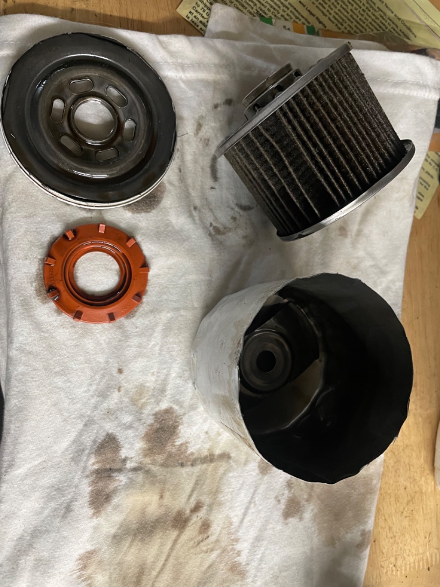

I also cut open the oil filter and took a sample of the oil. All checks out… nothing but oil. Oil filters are thin metal, like pop can thin, I like this new cutter tool should be handy!

Cleaned the snot out of the valvetrain and head. Cleaned up all
Sealant. Checked each valve stem seal, inspected every spring and retainer. Looks good

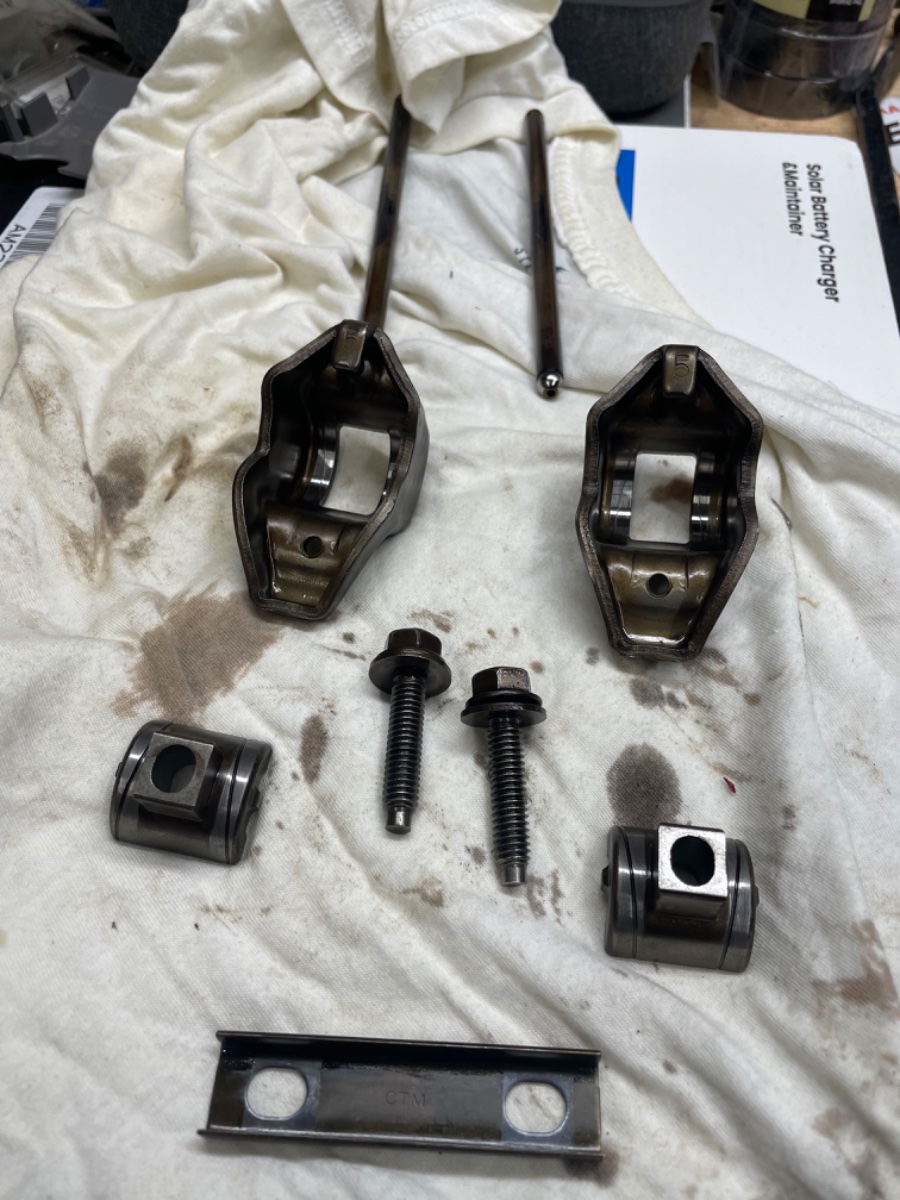

All 16 rocker arms and pedestals inspected and cleaned, re lubed
I found his factory pushrods and soaked them in oil last few days
Each rocker assembly and pushrod were carefully inspected, cleaned and re assembled carefully. Paying attention to the rotation of the pedestal mount to rocker arm and putting each pushrod back in the same orientation (you can tell which side was lifter and which was rocker arm)
With a valve at half lift all the angles look good and the sweep of the rocker tip on the valve stem looks good. I have lots of clearance between pushrod and rocker arm with valve fully open… not like before
I fully expect this to work

POS “old” 3/8 torque wrench is wall art now… along with some lightly used comp 6.3 pushrods

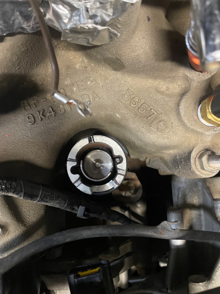

@410Fortune I thought that you had swapped to the 2-wire camshaft position sensor?
You have it backwards
The Holley works best with the 3 wire 96-97
My engine was 99-00
Now I have a brand new motorcraft 2 wire cam synchro in the box

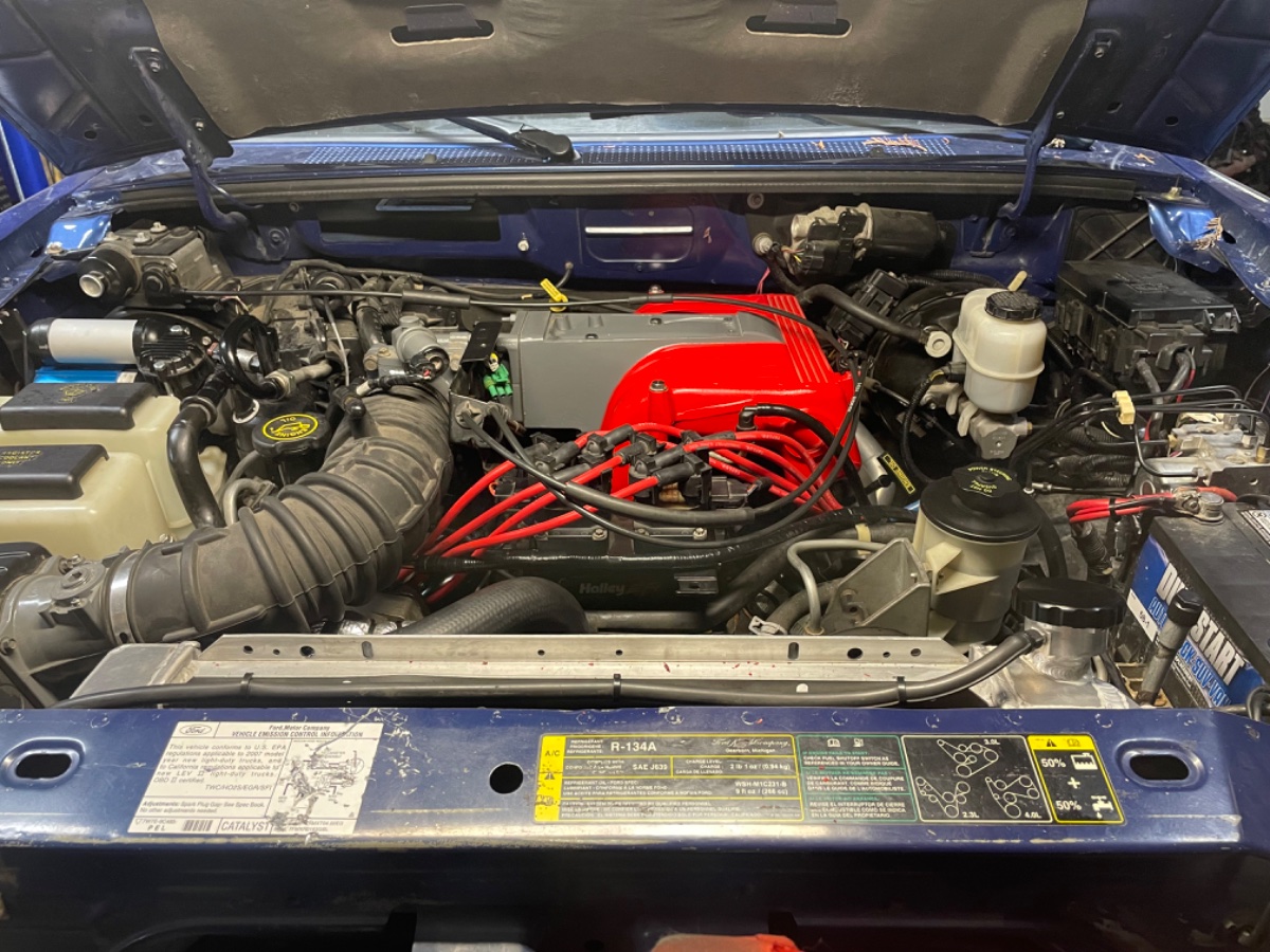

All lifters pumped up things are looking good
Nope
Still noisy
Runs better no more smoke but still knock knock knock
More tests tomorrow
Compression, scope cylinders, etc
Looking at all options
I have a few engines around here will do what is needed as best I can
